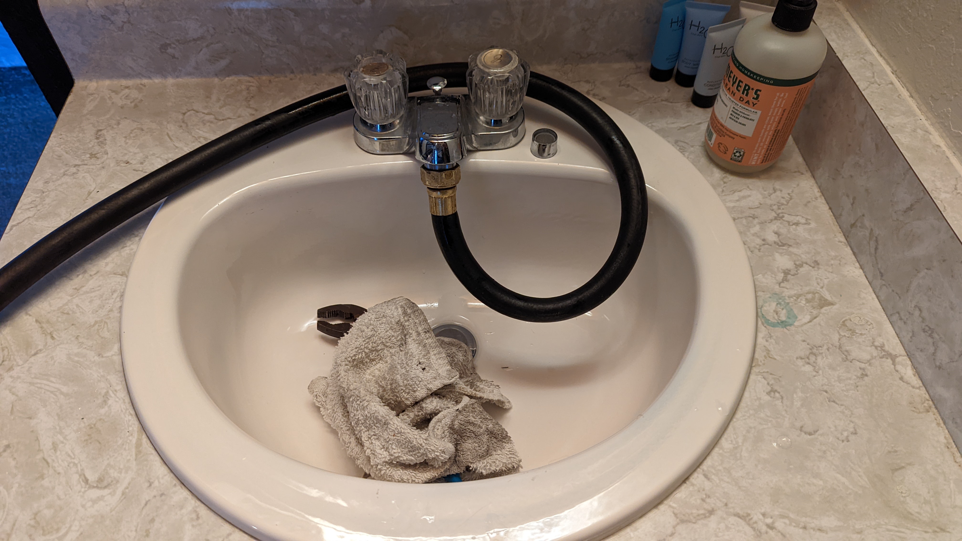

It wouldn't you know it, all the outside fixtures don't work....

Put that spotting towel over the faucet spout.
If the hose comes loose a little (and it can believe it or not) you won't be spraying water across the floor unknowingly for an hour.
It'll hit the towel and dribble into sink
no washing machine hook-up?
Much safer than faucet hook-up

Nope

That particular faucet will sometimes leak internally when pressurized, and the water will go back and UNDER the fixture. A pretty good leak even when the washers are intact. Not a problem in routine use.
About 1 in 20 have this casting flaw.
it's not a tighten tight fitting --it's just snugged as it should be
cycles between pressurized when water box is full, and unpressurized when filling can cause it to loosen enough to dribble or fine spray
and any hose hook up inside or out you should crimp the hose to check if back pressure holds.
If you do that, you'll never flood the walls or basement from a frozen broke hose bib.
Like I know some of you have....
It ain't rocket surgery, but it helps if you have a little common sense

where do tenants do their laundry?
a coin operated community room?
In the same machine some padder washes their scummy pads :eekk:
They had one of those stackable towers wedged into a cubby hole that would involve moving The combined machines 4 ft out to reach the faucet, he had. No thanks
