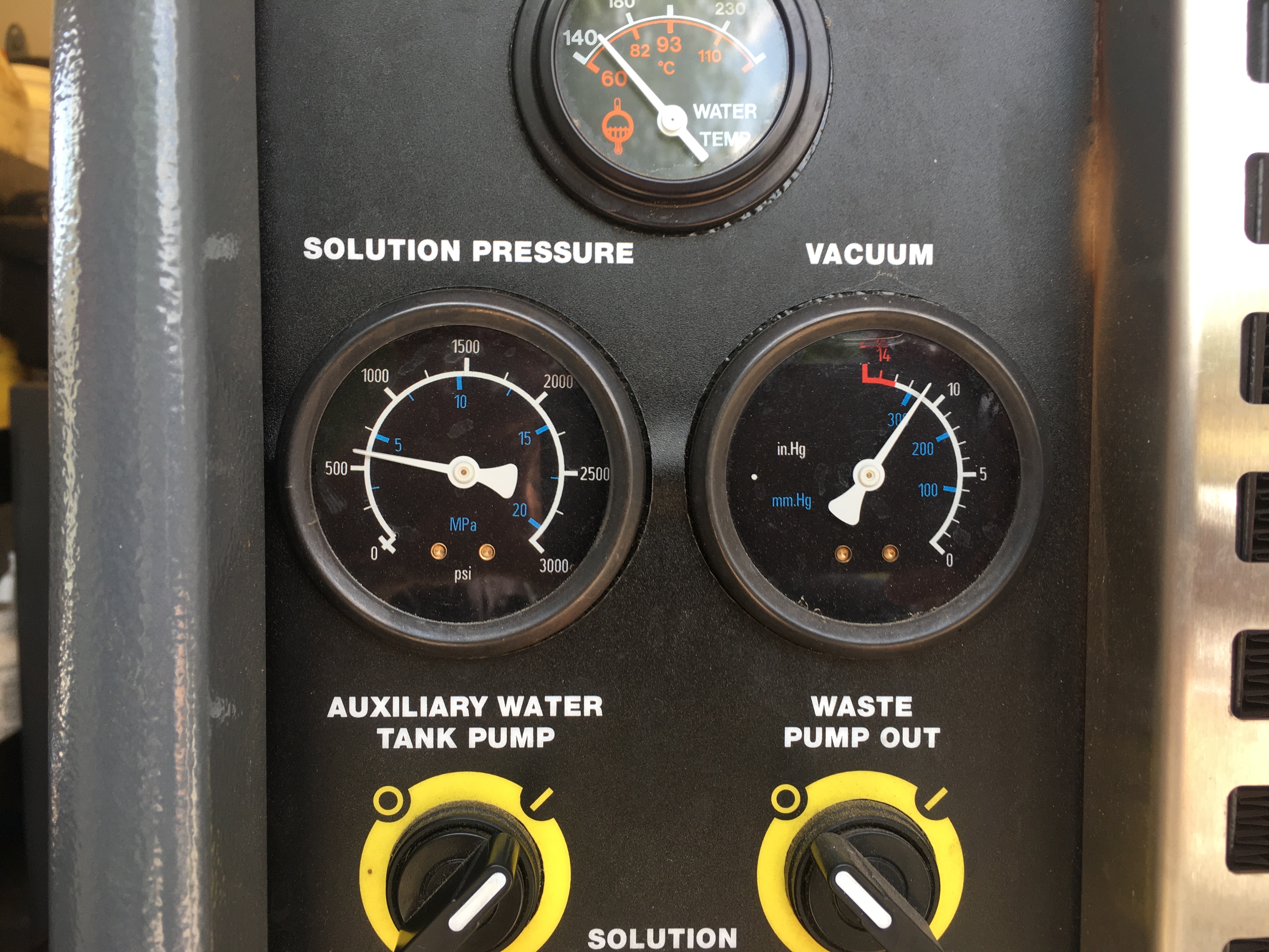

providing the filters are clean the hg shows the vacuum in the whole system, as vacuum increases your cfm goes down
dont know what your blower spins at? But prob pulling 400+ cfm around 8" but below 370 cfm around 14" looking at specs for 410 around 2600 rpm

I remember Tom saying that his custom machine is always at 10hg-11hg, and gave good explanation about it why that isn't necessarily a bad thing.
11,297
move the truck.
You're parked on the hose... 🤣
it's been so long since I spun a blower, but memory suggests 100ft of open 2" hose was around 6-7 hg
(45 spun @3200 rpm)
That's why masterblend uses a 1 1/2 inch hose and gets 10 on a open hose run.

So my question is a similar size blower ran around 13-14 hg vs steamaction 16-18hg what will be the difference as far as dry times and performance
