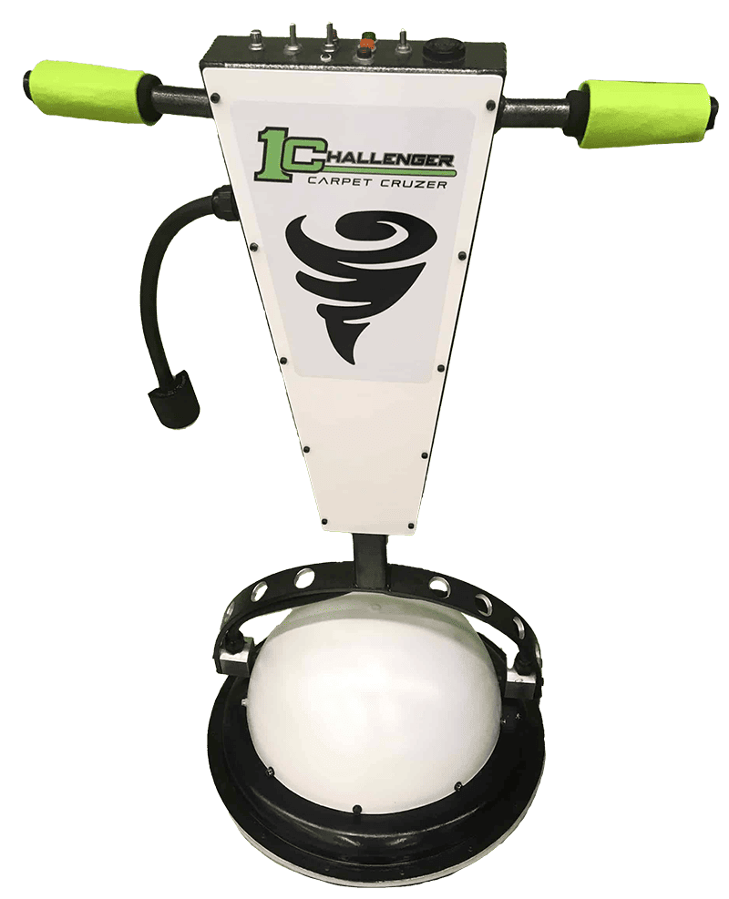

The wait is over, now you can dry carpets after steam cleaning. After 40 years with no real industry equipment built, The new surface-to-surface drying system is here.
Yes! You can dry stairs & carpet and solve customers’ concern for wet carpet and get paid for it.

That’s a pretty cool invention. So it’s a hot hair blowing machine over the surface??? Is that correct?

Ill stick with my good ole tried and true drag wand to rinse and if it needs to be dried more ill make an extra drying pass ( as i do on all wool carpets). What happens if you park that "giant hairdryer " on the carpet? Will it get hot enough to do damage?

No need to worry it is thermostats to kick off to low heat
Also eliminates the spin with customers not getting true value for topical products ie Re protecting causing over wetting and min protection because of the fear of over wetting

probably leaves corn rows behind...
Not really it lifts pile up and dries restyles with out leaving ugly rake lines also when you walk on wet damp carpet you crush the fiber down and it stays down till u rewet just like if you sleep on wet /damp hair it stays down till in the shape it dries till re wet thx joe

I was kidding, have you ever shown this to anyone?

Is this device for real like I don’t get it
Yes it is you buy a clothes dryer to dry clothes your wife buys a hair dryer to dry her hair you go through a carwash and a big fan blow dries your car in restoration you buy dehumidifiers and fans to dry pad carpets drywall all thing we do or have done for convenience conclusion dry carpets then to solve the customers concern after she /he asks price then next question is how long does it take to dry carpets I have a big blower not long I double and triple wand so not long etc etc or dry when we leave hope this helps you to get it thx

I don’t get the need for the new equipment
Is the tool completely separate from cleaning so I would do my normal routine then use this device?
My carpets dry fast during warm months but basements during the winter have been more of a challenge but more dry stokes less psi less flow and run the Everest on high gets it done

The tool complements the cleaning first then finishes the job so the customer won’t slip on areas when there feet socks area wet and they can use as normal and go through there normal as it is top down drying there is no wicking issues and it will pay for it self over time when you take into account the less fuel brakes tires and your self trying to do your daily quota you will pick up extra work with out wearing your self trying out on the web site there is 3 bars at top right on first page push those and look at what you can make plus as you change what you think your worth this is only a guide the smaller the area the more I changed I never did package pricing always sq ft hope this answers your question thx

Any videos of it in action?
Not yet because it rides on a cushion of air you can guide it with 1 hand and when first built one my 8 year old son could guide it and a wife could easily run it if your are a team it’s 45 lbs and 20 lbs of cord to power it
