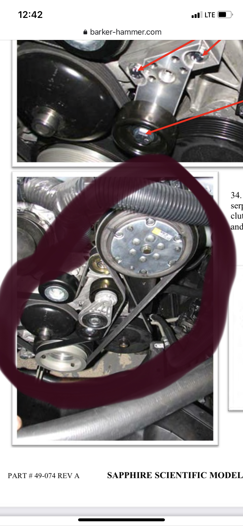

I have a 05 checy expressvan 3500 with a pro 2000 direct drive i need help finding the size of the serpentine belt that goes in the clutch
