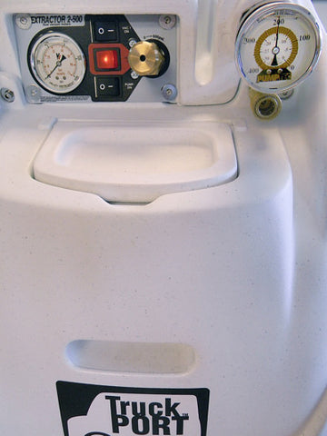

I see some good advice up above. Look for a machine with the vacuums in parallel, NOT series. The 6.6 vacs are pretty powerful.You'll recover more water and speed up the dry times. Get one with a 500 psi pump. Be prepared for pumptec or a cat pump. They drop about 100 to 150 psi when keyed. I've used some mytee machines and found there's some cheap parts, but they make a model with a General pump that looks pretty good. Be prepared to locate 3 separate circuits as the amp draw is over 15 with 2. I just added another cord to eliminate electrical overload. Never buy a machine with internal electric heat as it cooks the components in the motor compartment. There's a few options for external in line heaters, but again you have to find 2 more circuits for a decent heat. It all depends on what you want.
I agree with your recommendation of the 6.6 vac motors and 500 psi. Sounds like you just described our Truckport.

Looks like a nice machine Rick. How many cfm does it generate?

We don't have a CFM rating. CFM is an accurate way to measure truckmounts because they have blowers. With portables, their vac motor measurement is most commonly rated in inches of "water lift". As you can see from the photo below, the Truckport comes in at 200" of water lift –which is impressive!

When did you switch to the larger motors?
Imo you should promote this machine more..
14,637
15" of lift is impressive. I think with that kind of lift, it should be able to run 50' of vacuum hose no problem.
Maybe you could upsell some 75' heavy gauge extension cords to plug in to the 20amp outlets. Because sometimes those are hard to find
And is it hard to find 20amp outlets in big commercial office complexes and other commercial buildings?
It is common to have 20 amp circuits in large commercial buildings.
Adding a couple of these will get you some distance...
I'm not saying this isn't a good machine, but the drawbacks as I see them. Lift is good, but you've got to have air movement.In 40 years of running portables, higher cfm removes more debris and water. This will give you an idea on measuring airflow https://www.wikihow.com/Measure-Air-Flow.
20 amps is not always available' Can it be run on 2 fifteen amp circuits? Is it plumbed with 1.5 inch plumbing or 2 inch ?
