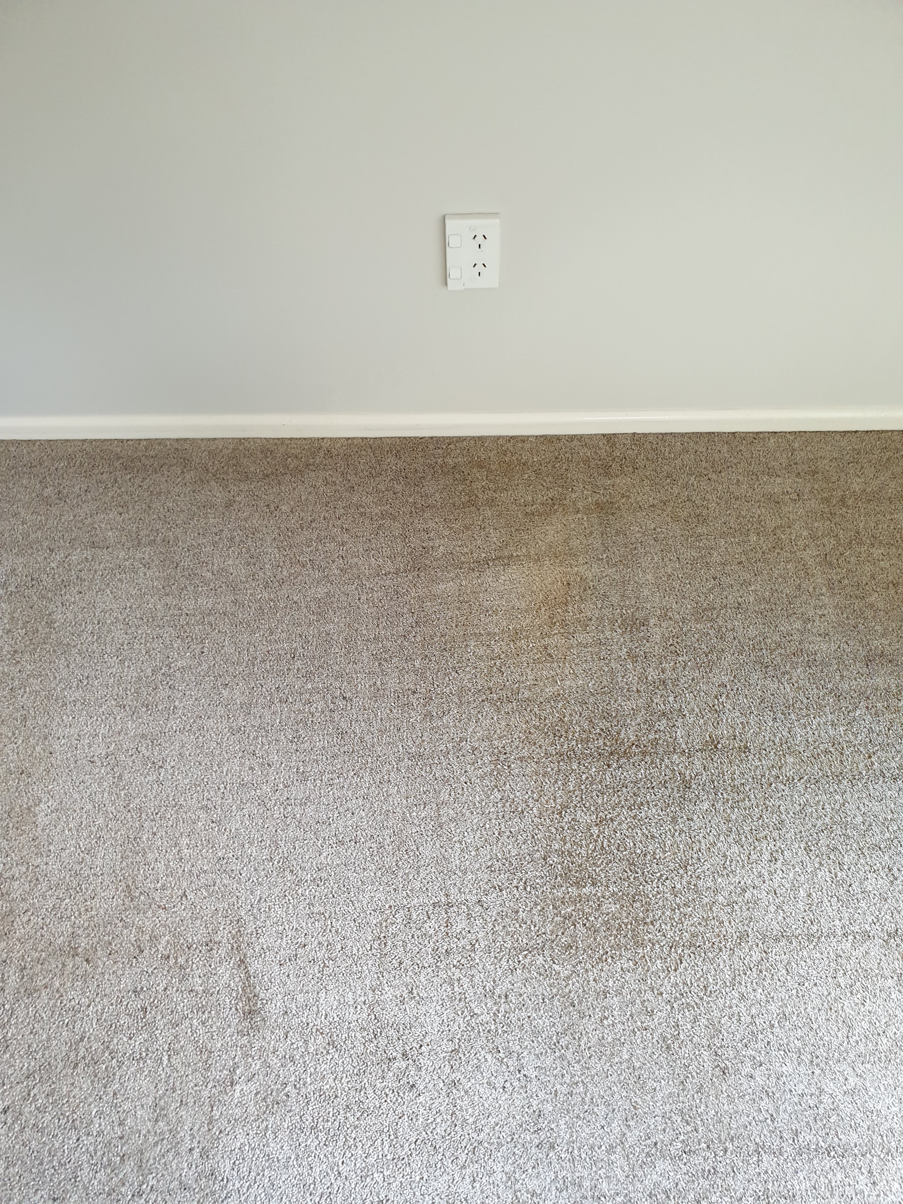

Geothermal fluid on wool Berber
Sierra Clean Care
Cleaning Professional
Jun 20, 2016
6,564
Jeff T
Is it R410 or propylene glycol?
Propylene glycol.
He also made mention that it is at a very diluted concentration, approximately 2-4%. Apparently it is supposed to be at about 30%.
There is also a slight orange tinge to it.
And there is sort of an oily substance present.
All they did was put a fan on it.
12,856
Clean it with products designed for wool. The fluid itself will likely be suspended in your detergent and come out. A little solvent based booster might help. The stain is more problematic. Don't use anything with strong oxidizers or reducers to make your attempt to remove it.

tell them to turn the fan off
stains are harder to remove once dry, especially wool being an absorbent fibre
*and you probably will need a diluted reducer or oxidiser
Be prepared to be patient to let the chemistry work... or fail

Thank you guys for the advice.
I am concerned with the ‘slight orange tinge’ thing though.
Any recommendations in regards to a safe reducer on wool?
I got a little to brave on a linen, custom made sectional earlier this year, and paid big for it....

I mix my own reducers and oxidisers so cant help you there
but I tend to mix weak and use heat on wool as its easier to control the heat than the chemistry once applied, will depend how large an area of course
and wool being so absorbent you can sometimes dry stroke the shadow of a stain out after HWE
but not always...

Was this from a leak? Could the orange tinge be rust from the system?
Yes, it was a leak. There’s 4, 3 level condos per unit. All have wool W/W.

I would clean it like Jim suggests, use some citrus pro or something similar to take care of the oily residue. Try a little rust remover on the stain and rinse.

if its rust from the system that is the orange tinge it should be pretty straightforward job

Follow Jim's advice. I would add that propylene glycol responds to a solvent, so boost your cleaning solution with Citrus Solv II or other solvent booster.
Leaks from fire suppression systems that are not flushed and cleaned regularly can contain rust. They can also contain harmful bacteria. Be careful if that is the source. Wear PPE.
