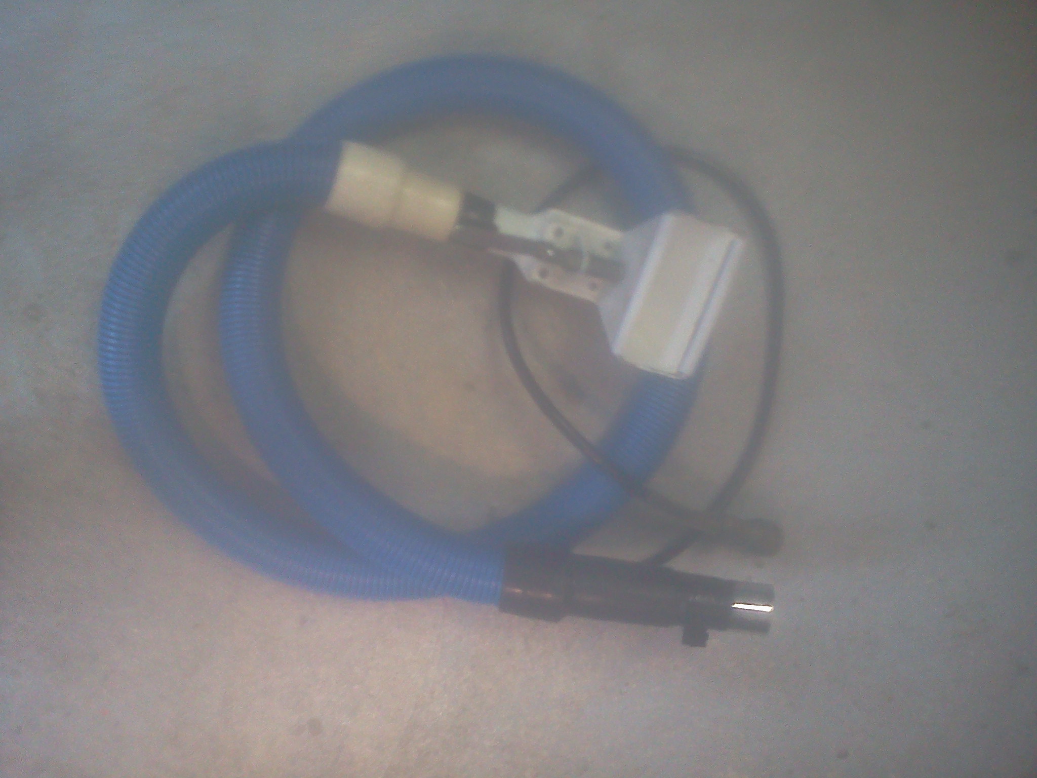

Kleenrite BlackOut Grout Brush and a old 4 '' SteamWay Stair Tool. I have a Crevice Tool but it doesn't flush very good and it only covers about a 1/4-1/2 inch out from the wall. Many times the filtration soil is wider than the crevice tool so a 4'' stair tool works better. Yes it means getting on your knees but it just does a better job and you can move faster. I run the side of the stair tool along the baseboards. I get good results and do charge extra for this work. BlackOut rinses easier than the gel type spotters for soil filtration.
I use this method mostly in the extreme cases.

It works great for tight spots. Between beds and dressers or cleaning the edge of area rugs. It puts out a lot of solution and works great for flushing/cleaning soil filtration. I don't use it for stairs because it's too small and slow.
