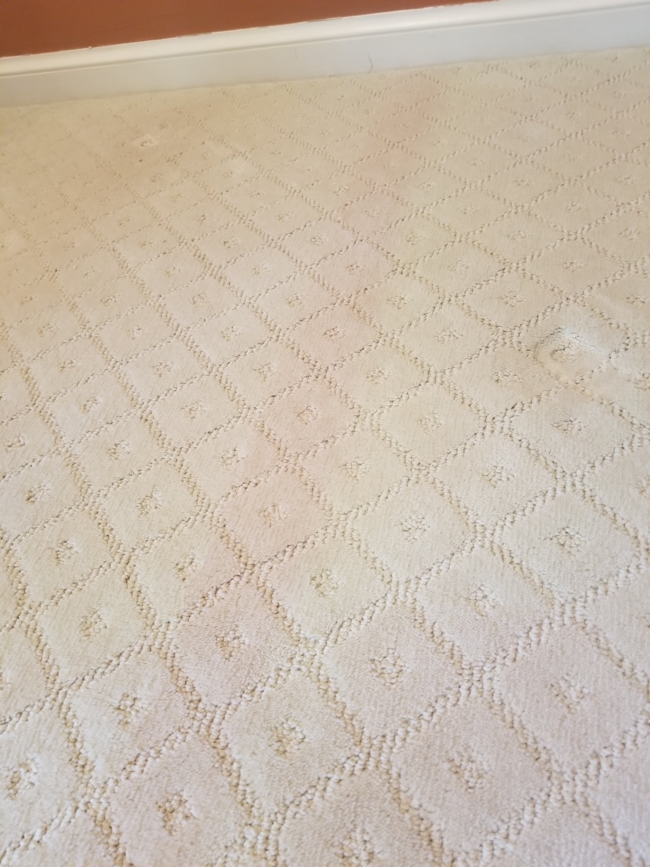

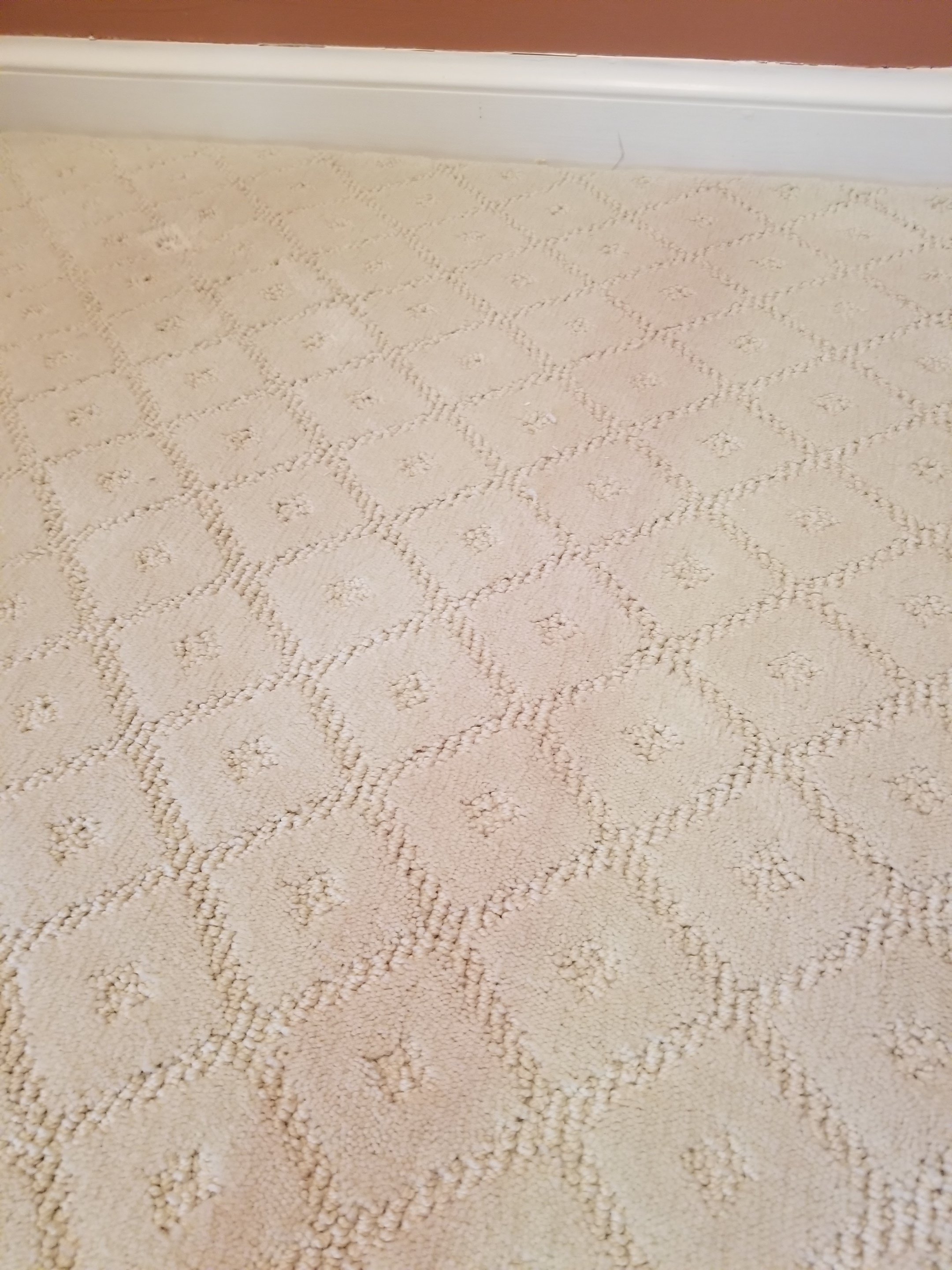

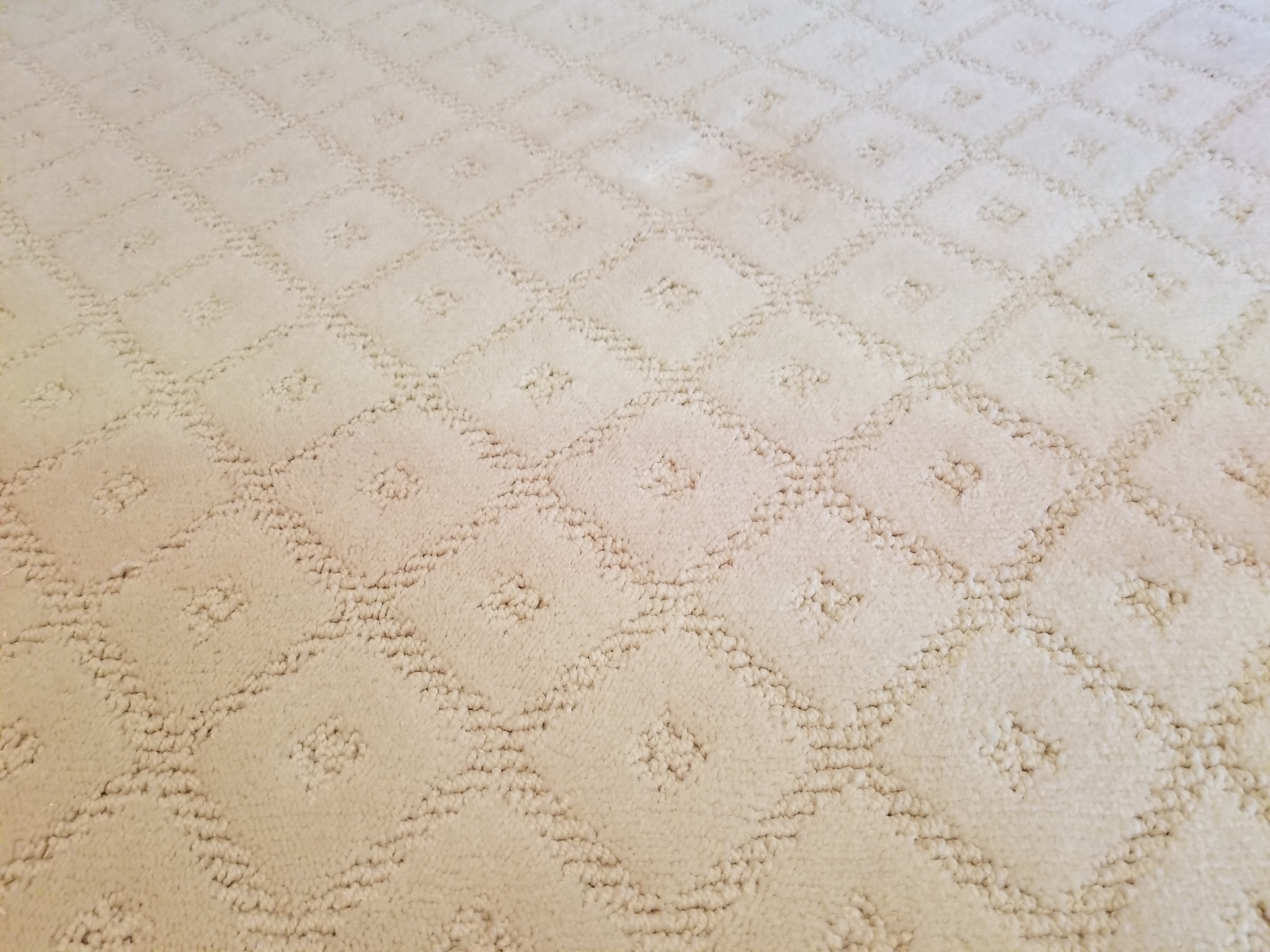

We cleaned this carpet and the homeowner says this line appeared after the cleaning. There is a seam more or less under the line. The carpet is 14 years old and in a bright and sunny room. The customer thinks the seam tape bled. If so, I have never seen anything like it, ever.

Yep seam tape but PH imbalance would be my guess. Check ph and try reversing it along the strip.

I can't see how the pH would get out of balance along just that strip. Seam tape should not affect pH.
Never saw that before. Would like to turn back that carpet and look underneath.

Carpet tends to peak or raise along the seams. Any chance this is a shadow or lighting effect due to being slightly higher along the seam?

What kind of carpet is it? On my phone it looks like wool.

I’ve seen this before. Can’t tell you why. Seam tape wicked somehow.

Masland nylon carpet on the main level of the home.
The suggestion that it may be peaked at the seam is interesting as it was one of those jobs where the carpet rippled when wet. I looked at it though and it is pretty flat, though I can't rule out that it is very, very slightly peaked.
I have never seen carpet seam tape bleed or cause discoloration.
This was also one of those type jobs where we are just coming in to touch up already clean carpet, so not a lot of any type of excess cleaning solution. We have cleaned in this room several times over the years and it was done by a crew leader with 20 plus years experience with us.

Is there a color difference? Sorry a little color blind. It just looked like nap reversal to me, if that is the case, the seaming iron was run against the nap of the carpet during the seaming process. The fix is to take a clothes iron and run it in the direction of the nap.

On the last pic, it looks like more pink discoloration bottom right. If you can find a way to help your customer, great but not really your problem. Not a cleaning problem in my opinion.

Had a white carpet that turned bright yellow right on the tape. Looked like a football field.
I believe we rinsed it with citric acid to correct it. That was 25 years ago though.
