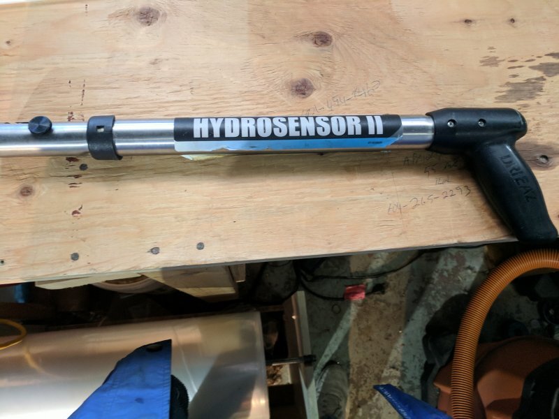

I’m interested in knowing when the rugs are dry. Due to the limited dry room rack space, I was wondering what moisture meter I should get. I would like one with a digital readout, In order to confirm how dry it is. I know there are a few of them that will beep if there is moisture. I want to KNOW how dry it is. Any recommendations?
Jeff @ SCC
27,946
Jeff @ SCC
Just a hydrosensor. It will pick up the moisture on you fingers. If it doesn't beep, the rug is dry.
