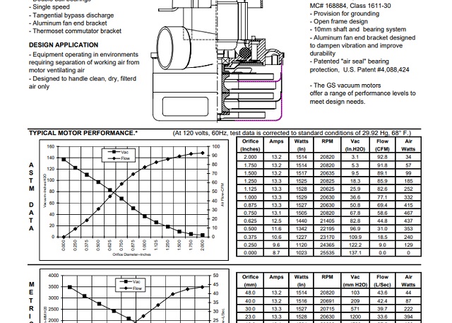

2-6.6 vacuum motors in series will give you 200 inches plus of sealed vacuum. Open flow it will give you aprox 138 CFM. In parallel it will give you about 130 inches sealed vacuum and 200 plus cfm. Either way, it's a pretty decent machine. You don't want to leave it in the van and call it a truck mount but as a portable it will perform well. Good price too.

A vacuum performance curve would be helpful in determining the performance one could expect running their porty from the truck.

58 cfm @ 68" water lift for a single blower, using the 3/4" orfice rule of thumb.
Much harder to calculate performance from a truck. You dont have any drop in suction but the longer the hose, the bigger the drop in CFM. The longer the hose, the more CFM you need. You can measure it in time. Put on a certain length of hose, seal it and time how long it takes for the motors to rev up to full capacity. Then add more hose and repeat. You will find the longer the hose, the larger the time lag.
Here's the configuration curve for the two vac motors in the Truckport.
http://excellent-supply.com/assets/images/Ametek_Lamb_2-Stage_6-6_Airwatt_Configuration.pdf
I'm not a fan of running a portable from the truck. Electric "truckmounts" have their limitations. Running long hose runs off an electric blower will see a fall off in performance. It's easy enough to just roll the machine inside and have it close to the area being serviced.
