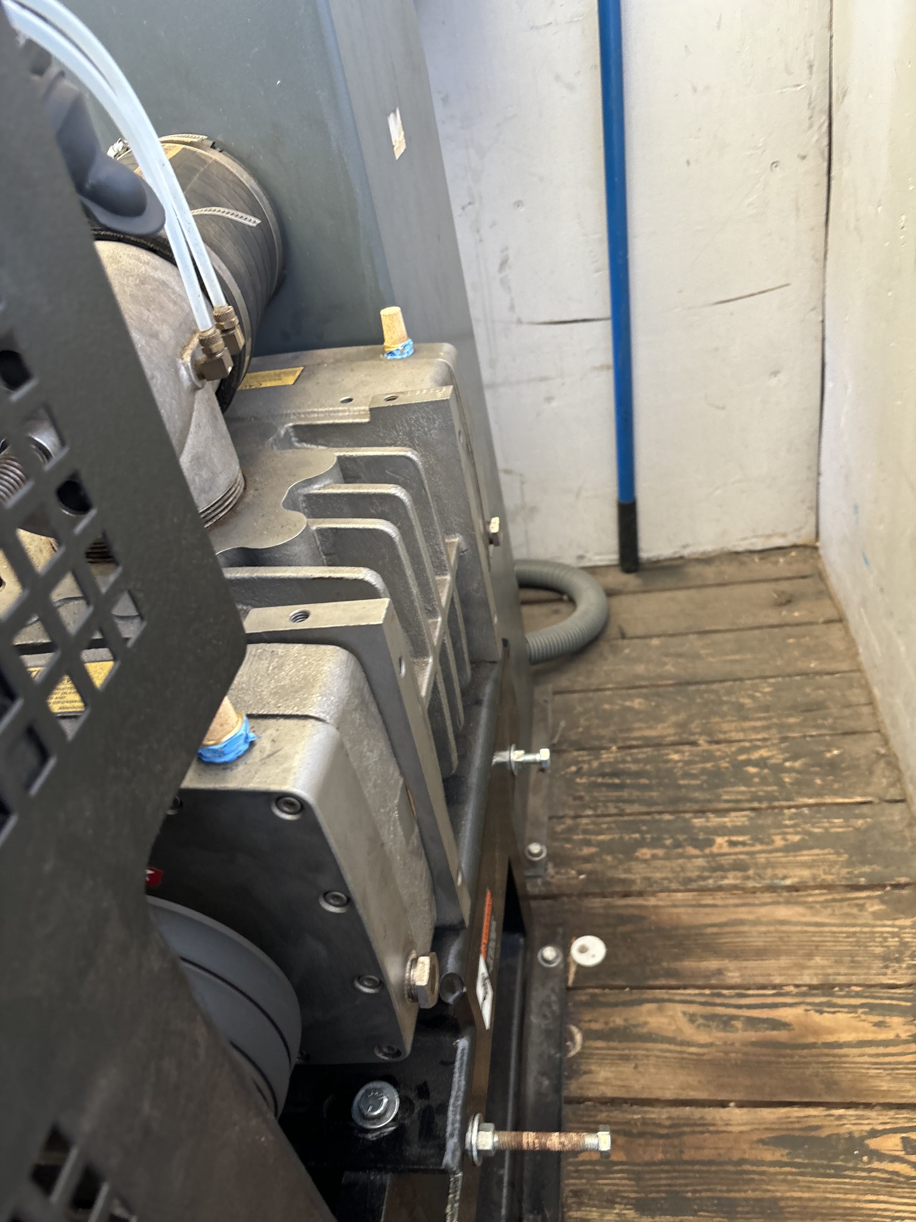

This is what CleanSource in Columbia has been putting on the blowers for 6 years. He told me he’s seen no problems.
A pinhole breathing tube on the one with the stone or a 1/4” breathing hole on this one helping the heat escape makes more sense.
I’ll reply back to this thread 500hrs later and 1k hrs later also

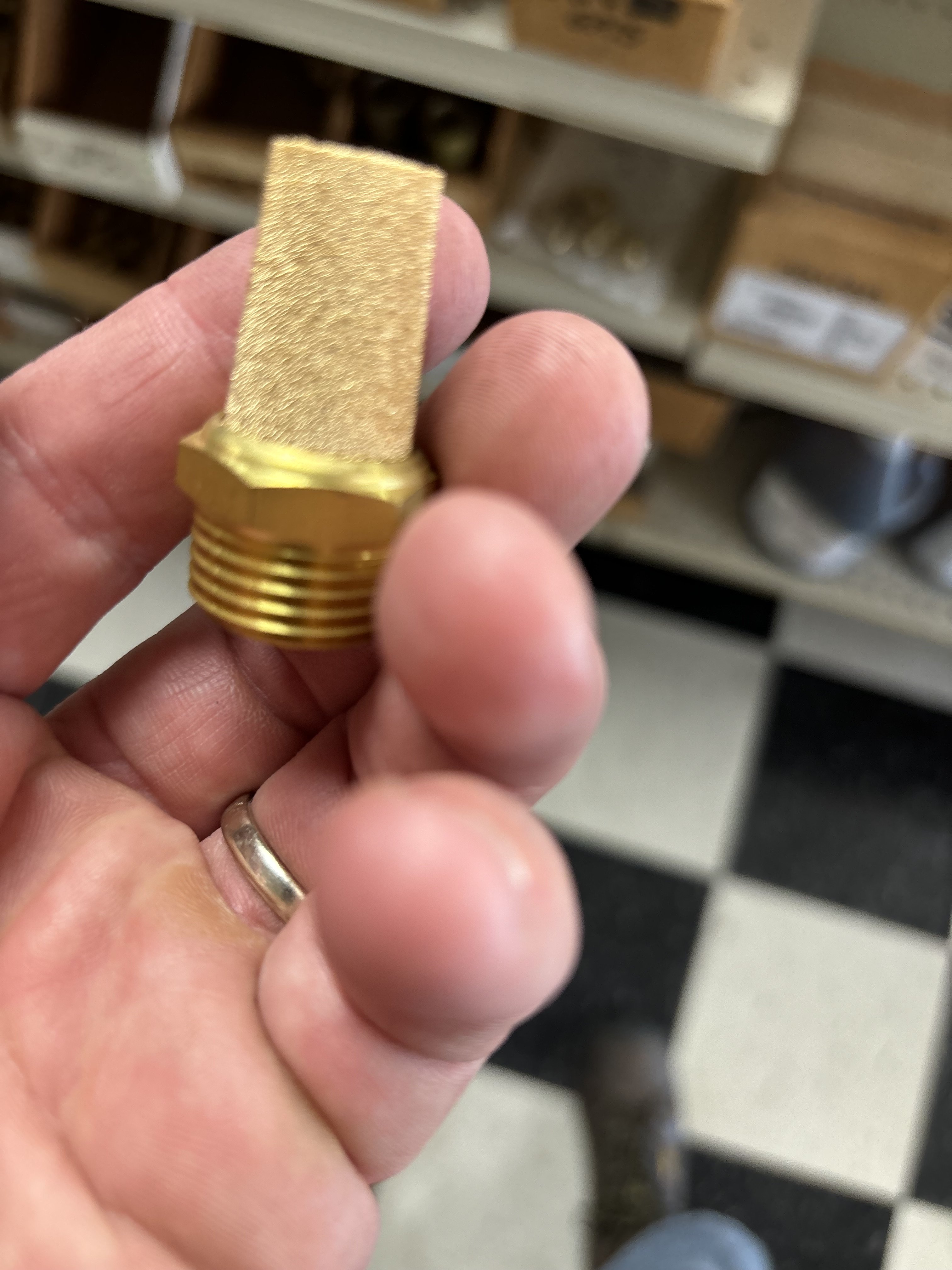

I found these brass mufflers on the shelf of my industrial supply store today when I was buying some new belts today. I figured I'd get a couple and see how well it works. I made a couple calls from the 2 guys I trust for these kind of technical questions and they both said yes.
It went through 5jobs today (9hrs) and it seems to work great
The hole to breathe is 10time bigger diameter than the tiny hole in the stock cap
And I don’t see any way for this brass filter to get wet with oil like the little filter does so it shouldn’t build up pressure in the blower since it’ll breathe better
9hrs and the filter stayed dry. I’ll update more about a month from now

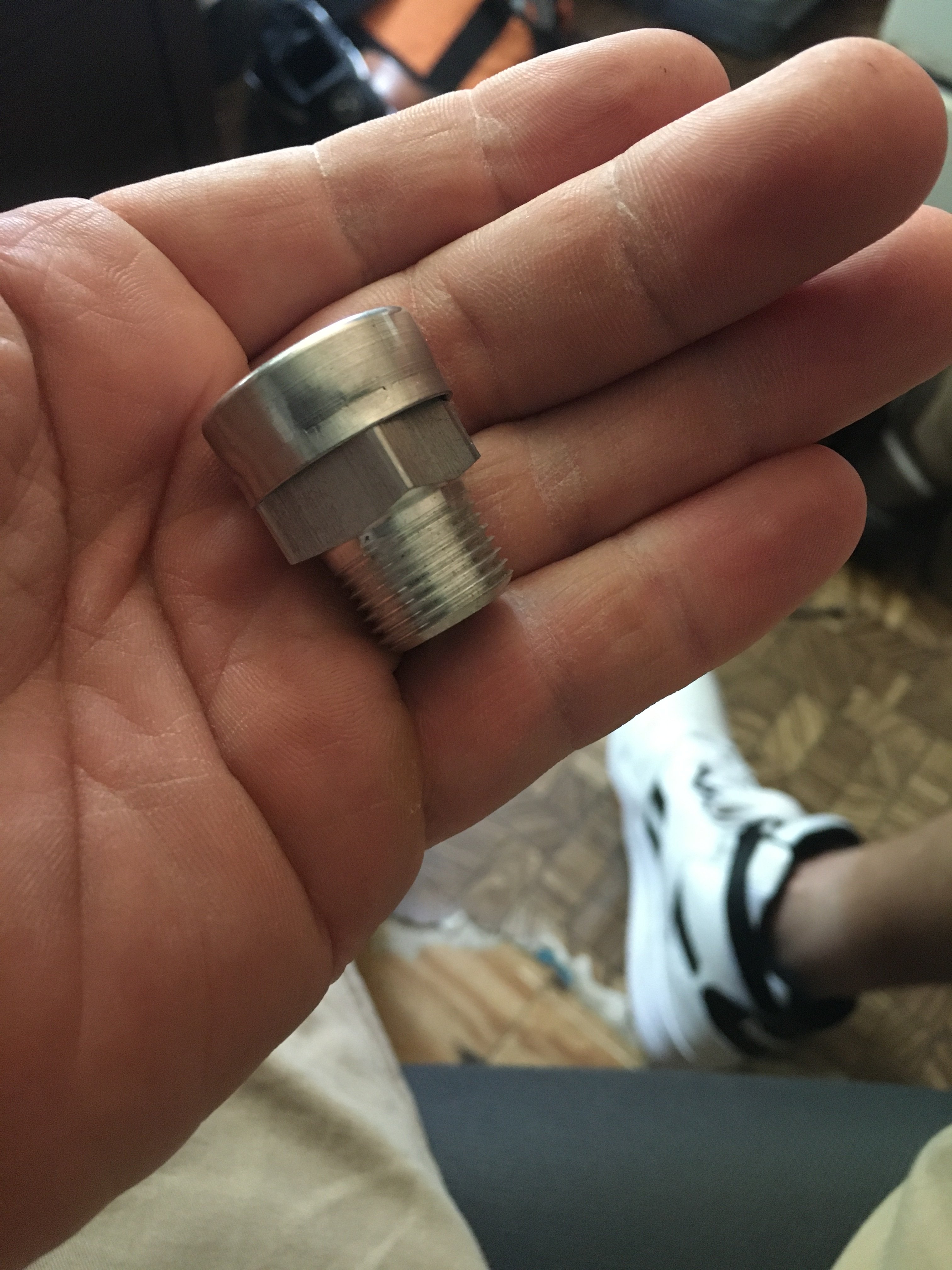

I replace my vent (FILTER) caps EVERY time I change my blower oil…. About every 2 months. The stock ones on a Roots is very similar to the ones Matt was talking about 2 years ago.
The replacement pair cost me about 12 bucks…
Excessive? Probably.
Smart? YUP…
