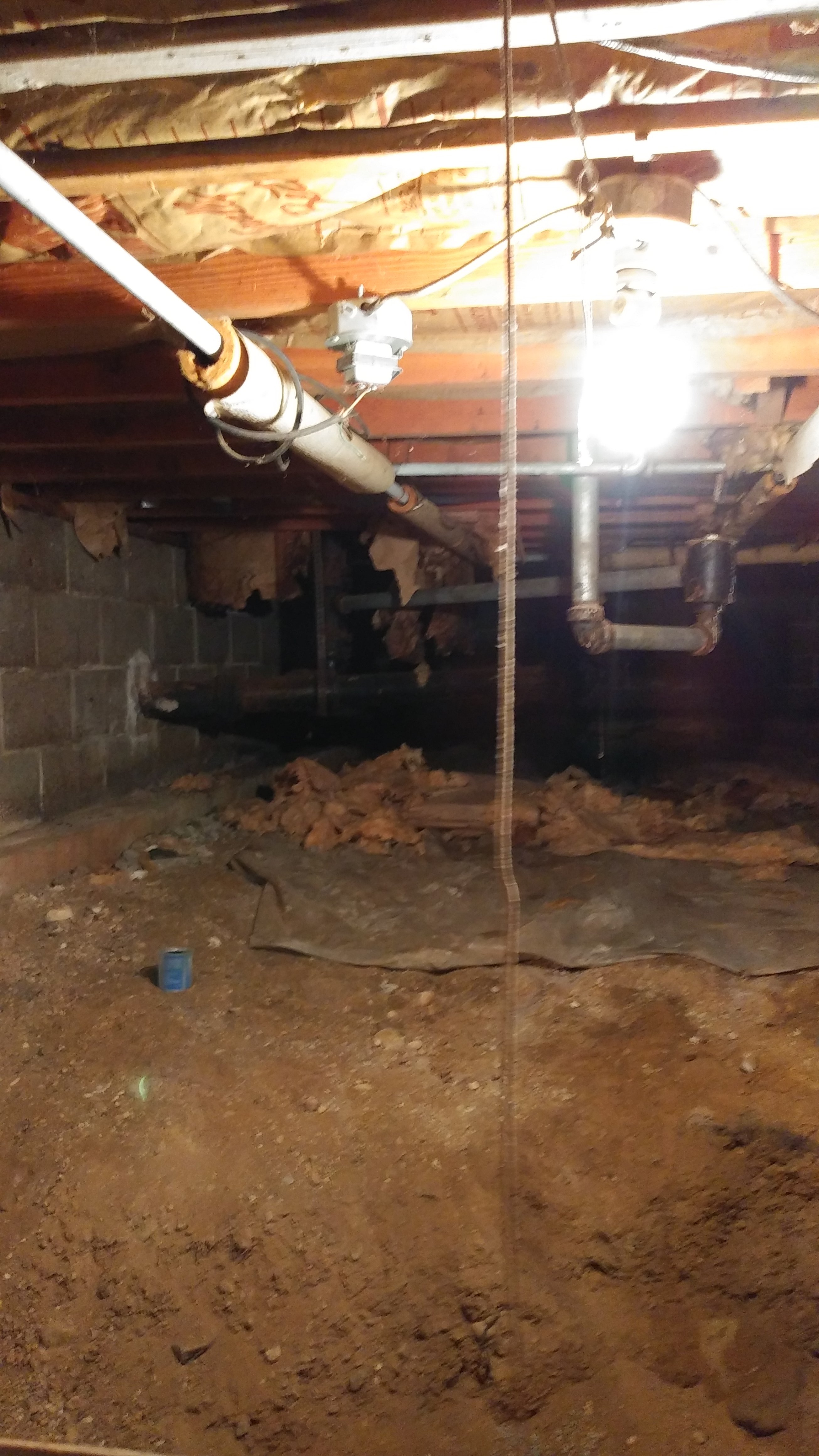

Theives!I paid somewhere around $1200, I think, to have my main drain line replaced a few years back. It collapsed. I wonder why yours is so darn much?
They tried to.Did they sell you their platinum package?
I have 3 lines and 2 are under concrete.
I've got work 3 days next week, hope the boys can keep doing it solo.
Because they can't lay it above ground like in Bama.I paid somewhere around $1200, I think, to have my main drain line replaced a few years back. It collapsed. I wonder why yours is so darn much?
I thought about that lol.I had the same thing in my house years ago, under concrete. The plumbing bill alone was $7000, luckily insurance picked it up I think we blamed it on seismic activity or something lol
Thinking about that on the north side of the house and abandon the pipe under the garage and porch there. Still have to go under the driveway though.Can the drain be rerouted to avoid breaking so much concrete?
City water and sewer.city water and sewage, Steveo?

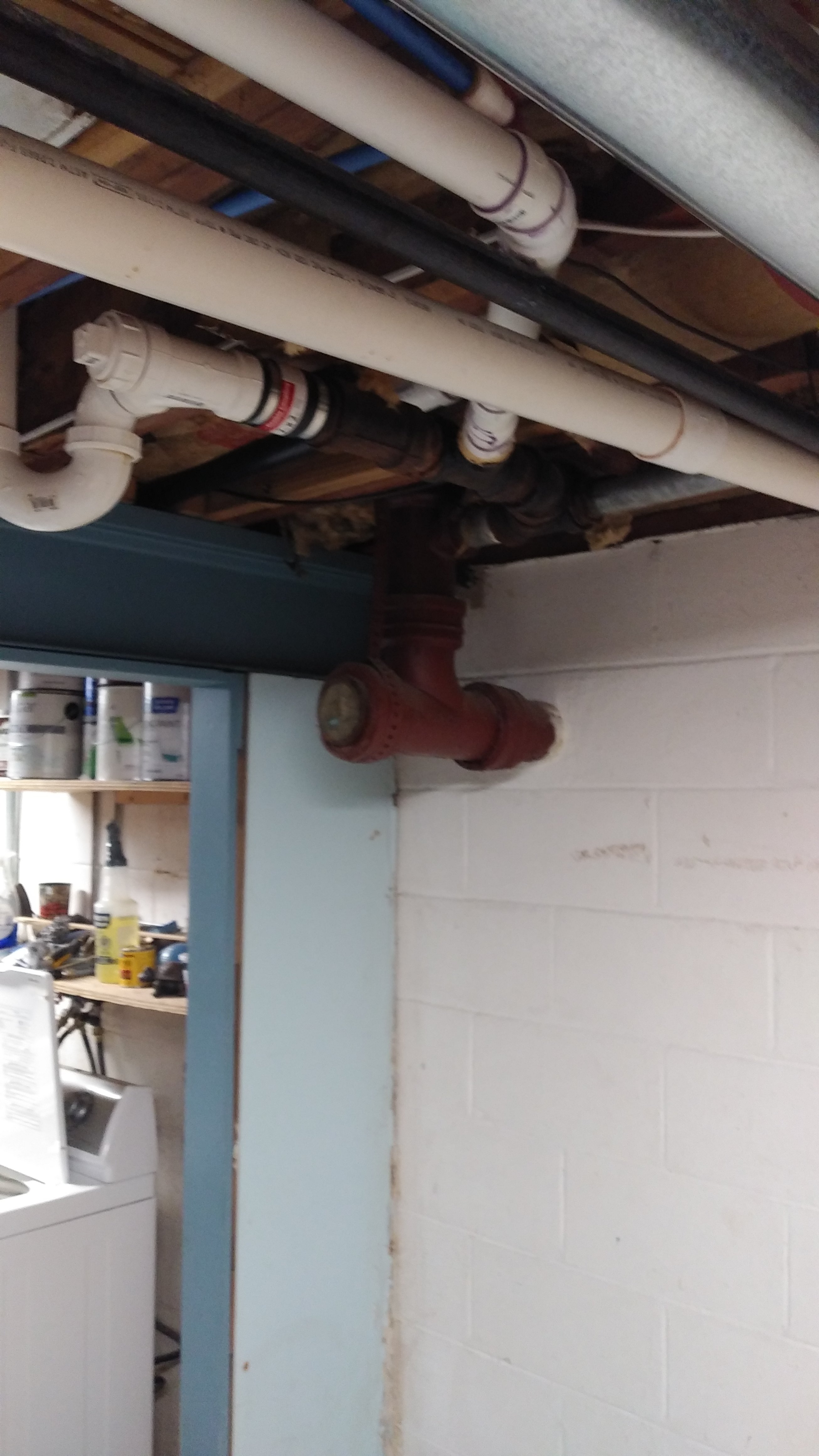

Unless your house is prettydamnbig and has two main stacks in the basement, only one line out and to the street is sanitary waste water
the others must be storm drainage (gutters, driveway drain, etc))
They may tie into the sanitary line outside somewhere
if that's the case, it's unlikely the city will allow that now, so they have to do something with storm drain lines too
what exactly are they doing for the $12k quote?
.LT.A.
We have 2 bathrooms with 2 mains coming out

you have two of these in your basement?
(4" cast pipe on left that goes from floor joists to into concrete)
