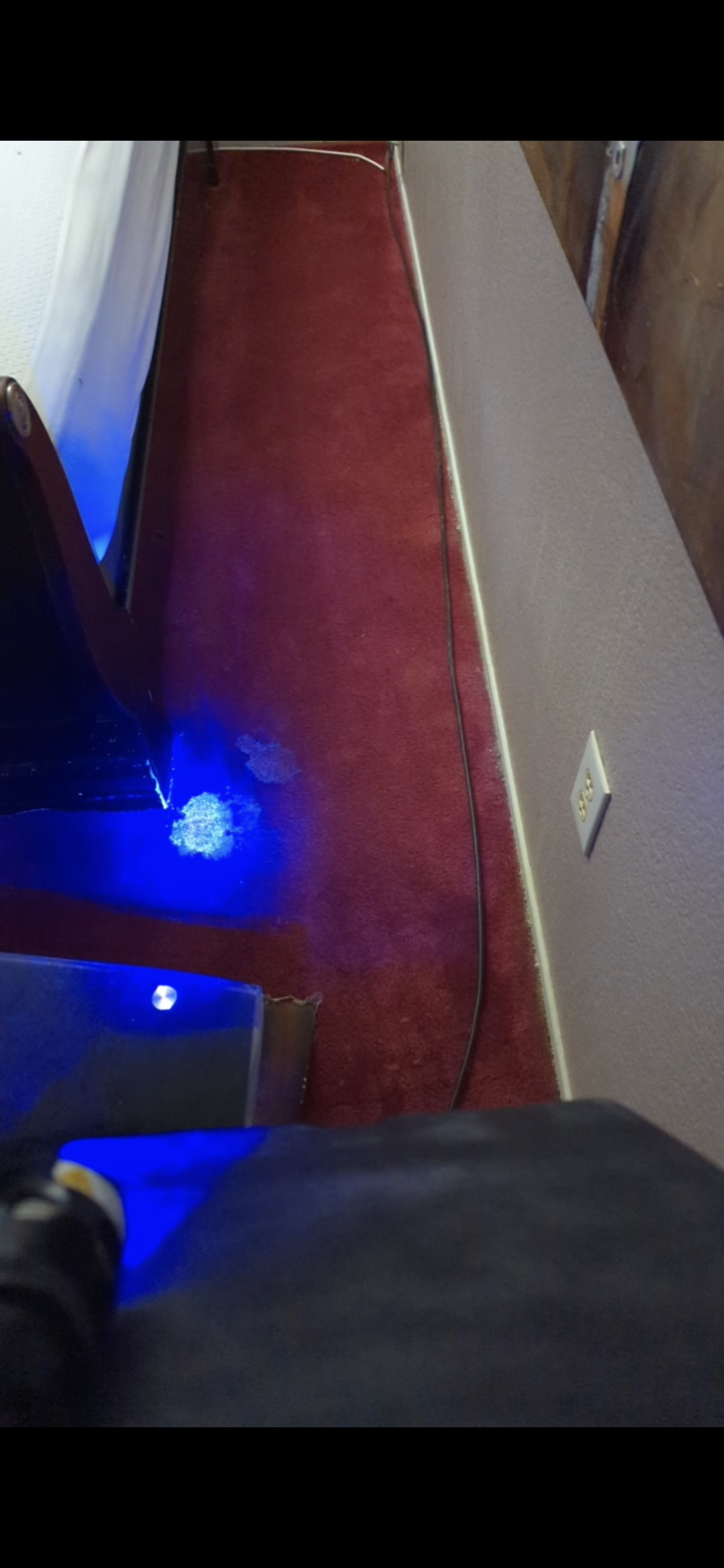

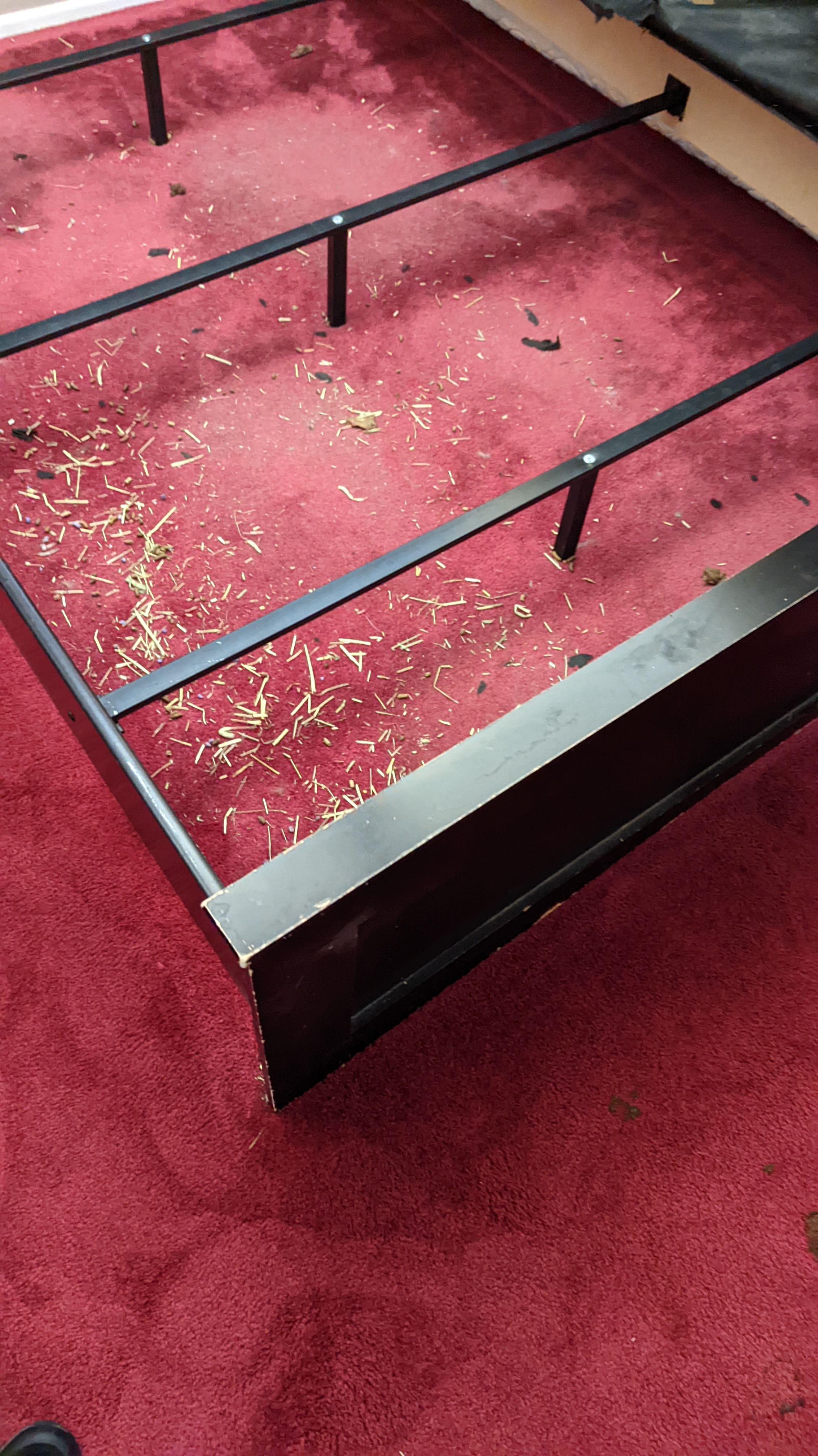

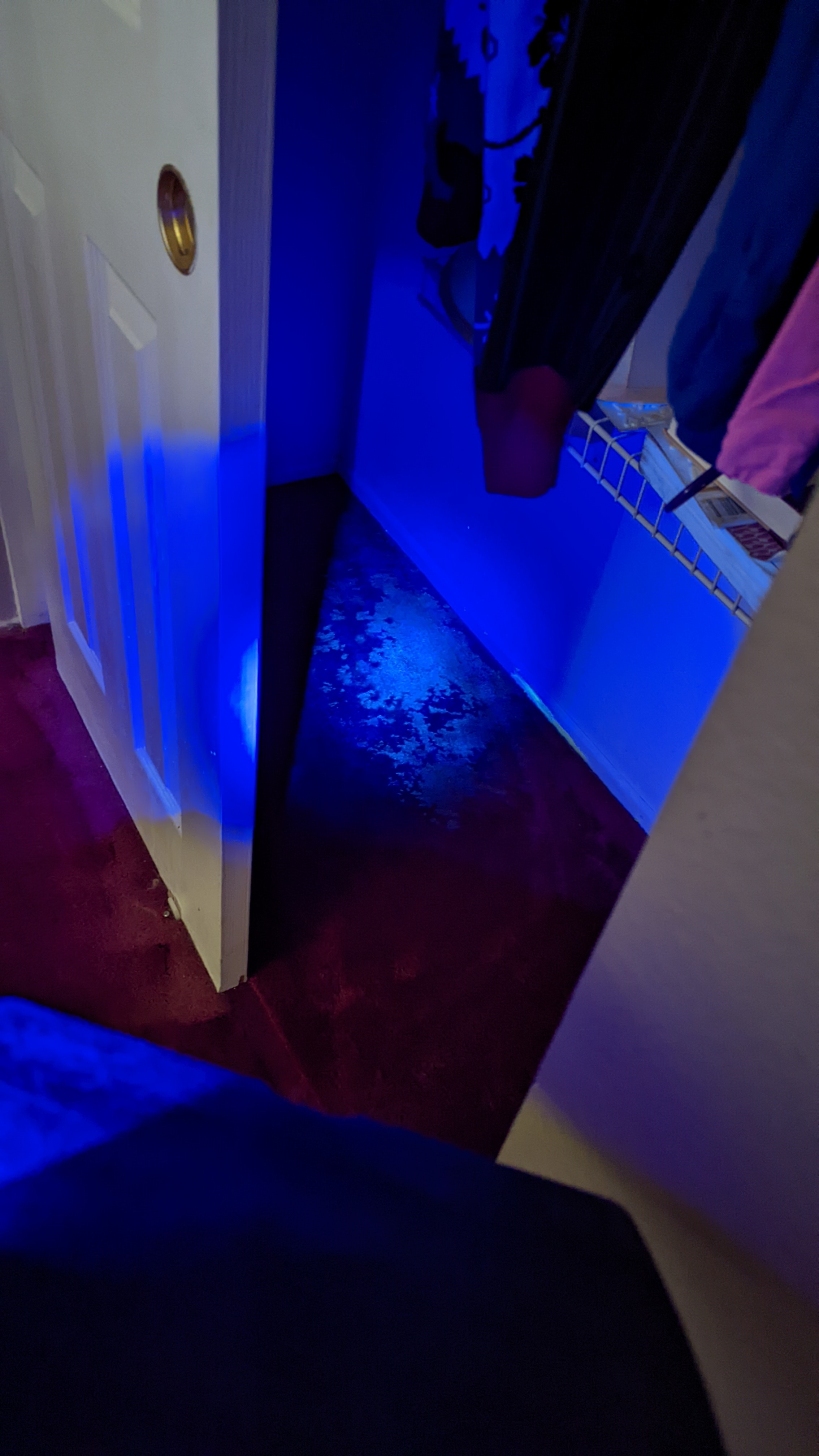

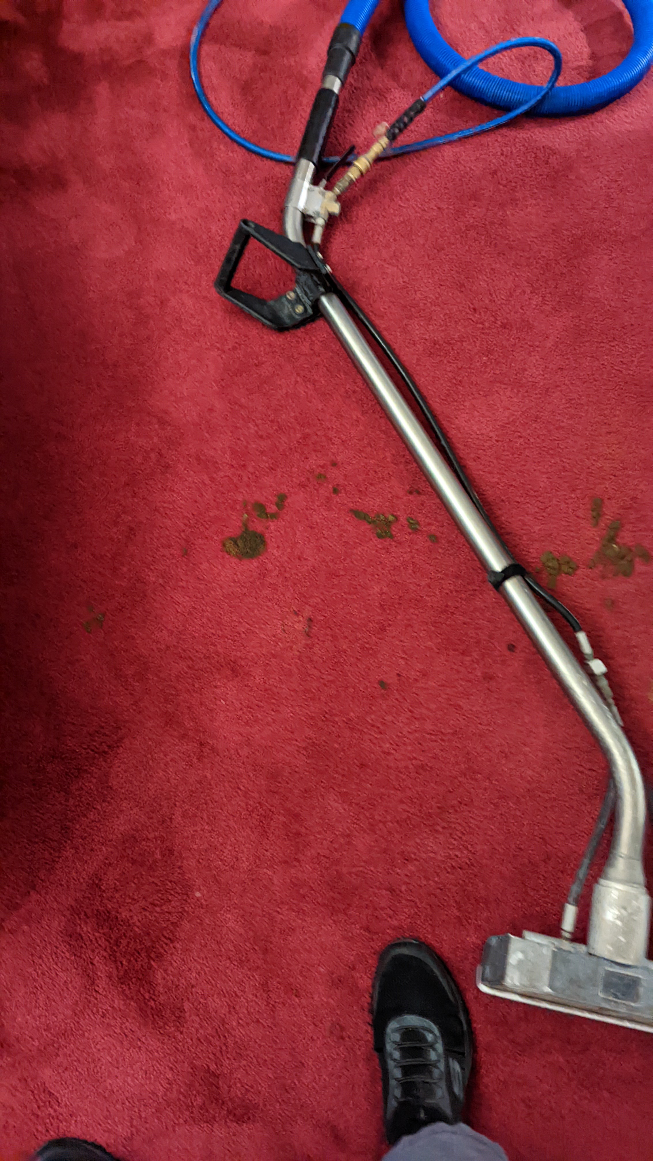

Every 3 months, customer rescues cats and has 3 dogs, and some Guinea pigs.
I move the beds, and dressers, clean some mattresses and nuked the carpet, next time I'm trying stabilized clo2

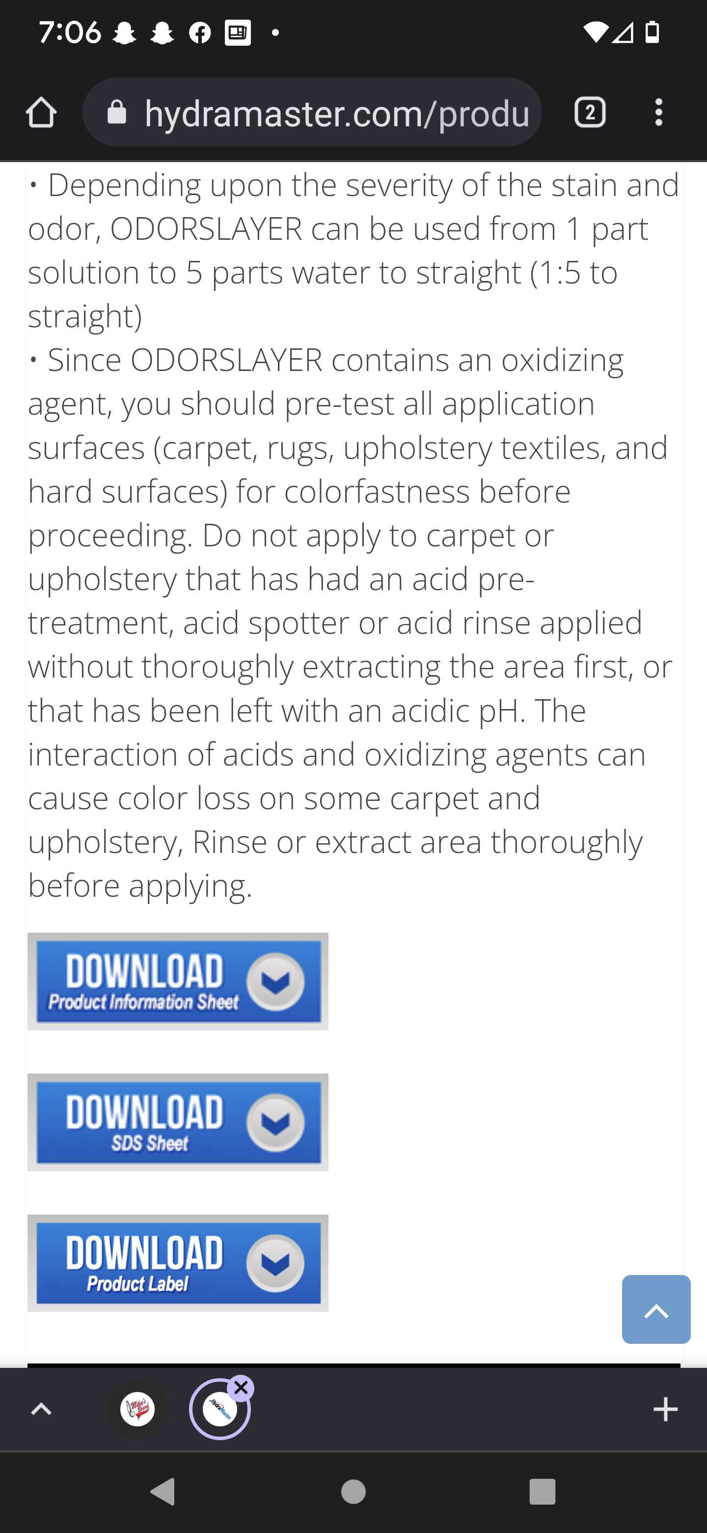

It's say an acid used with it can cause bleaching?
It also before , I'm wondering if after rinsing with an acid would effect it too????
11,548
Why would you mix CL02 with an acid?
You wouldn't, but odor slayer has a warning not to use an acid can cause color loss, I always rinse with last step, that's an acid.
I guess I could rinse with water.
