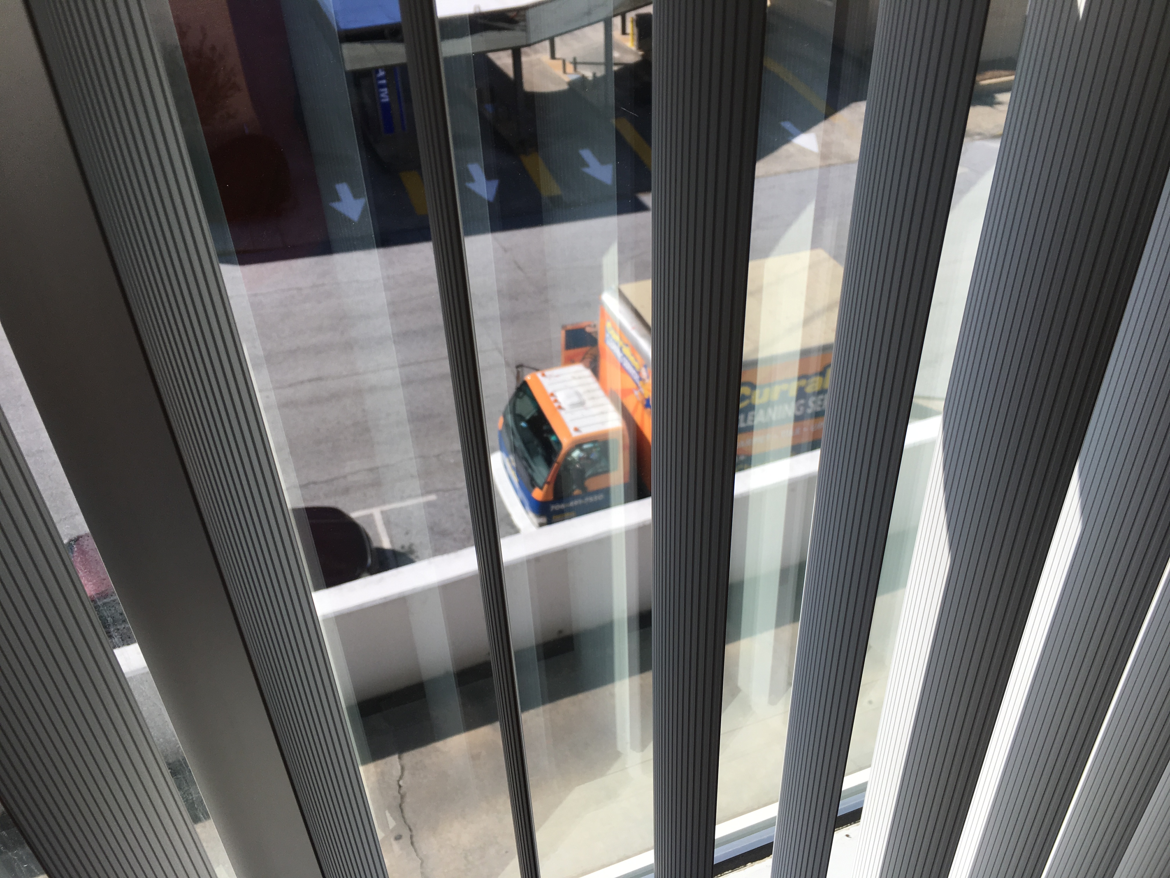

Did a job today that I thought was applicable to your post. We do not have any BIG AEROTECH STYLE TRUCKS but have multiple standard size Truck mounts. If making long runs (250’ - 350’), I will schedule, if possible, 2 trucks per wand. Run a 2” hose from each truck maybe 100’, then “T” it to a single 2” hose for the remaining distance. I don’t have an Aerotech to compare to but I think something like this gives you more flexibility for the same money.
Standard days, run separate routes, but when you need the power of a larger truck, just combine them.
