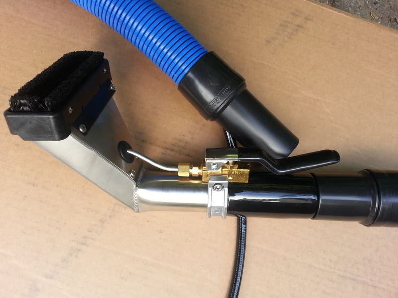

Hey guys!
A couple of quick questions:
1)Which tool would be best used in, conjunction with a TM, for situations where a customer has tile/grout for the stairs? For the floors (ie: not the stairs), I would be using the Hydro-Force.
2) I have a GMC Savana and need to install some J-hooks to hold my wand, and some extra length garden hose. The hooks I've found from suppliers are meant to be attached to chemical shelving units, which my van doesn't have (my van has a chemical holder built into the fresh water supply tank (molded). Which J-hooks would be a good option? I'm looking to have a easy-to-install solution that does not require drilling.
Thanks!

This one..
