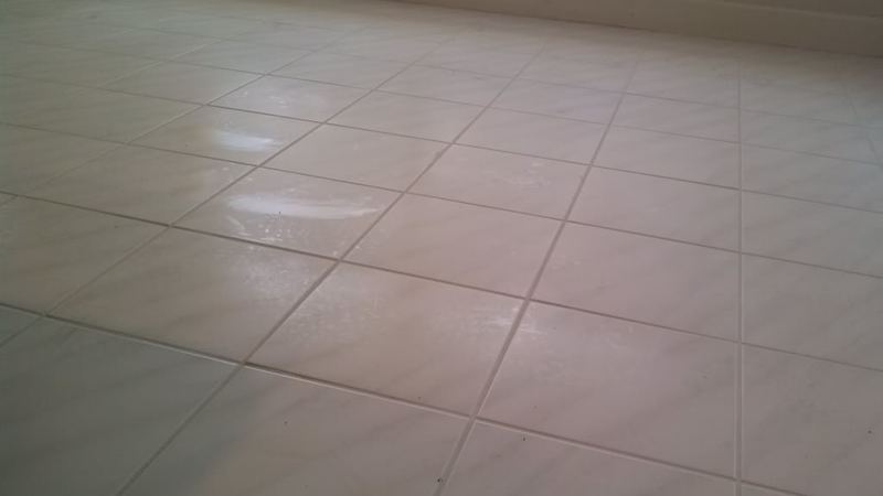

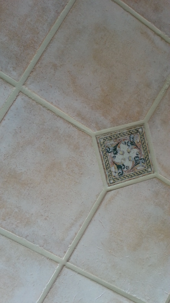

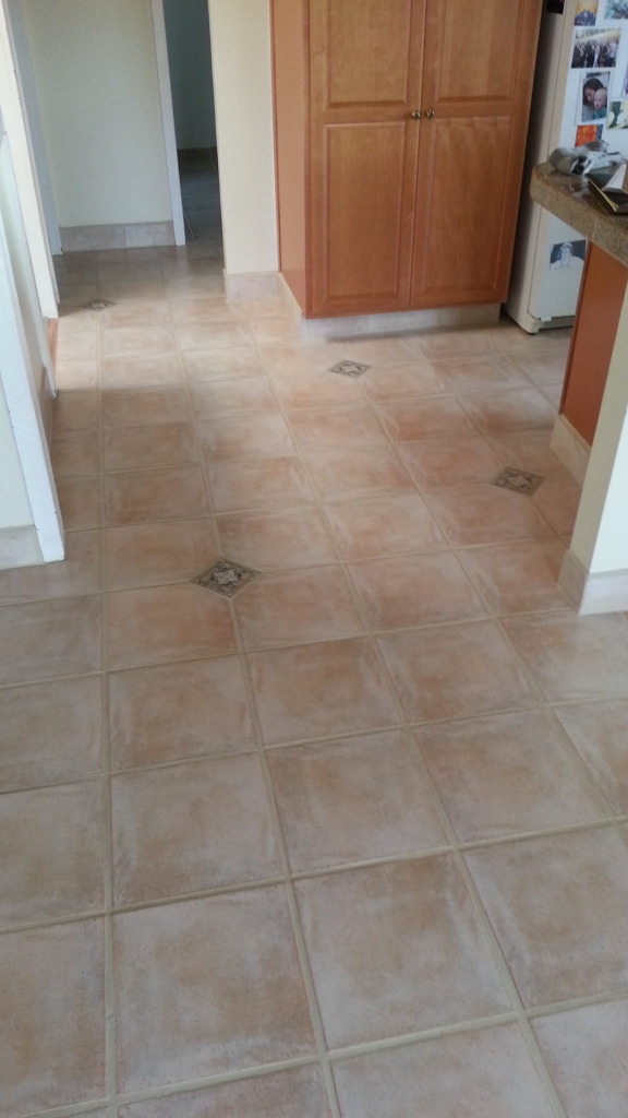

color seal awesomness.
117,324
now that we've done hundreds of Color Seal jobs they are finally starting to call back for a cleaning.
It salways a piece of cake, neutral ph prespray, light scrub in the heavy areas and a Ti Wand rinse..
Still looks "perfect"

If the grout has been acid cleaned and ZERO (topical)residue is present applying Grout Perfect is pretty darn easy..
Can be rough on the back and shoulders on big jobs but kitchens and baths are no big deal at all.
as for durability, if the product does not attached upon contact and you have to fudge it on, being careful to wipe around the grout line or applying two coats, you can pretty much count on it peeling of flaking off at some point.
Just try and get GP off a well applied scenario
takes gel base paint strippers to budge it.

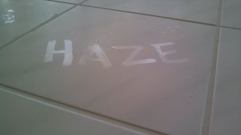

What's your clean up for haze? what are you using Mike just watched the video, got the salesman kit.
They had a oreck orbital cleaner with a white pad then clipped a terry towel to the bottom of it and buffed, what do You do?
I have a 13 inch hild. with a block and a carpet brush

Is that grout haze or sealer? Looks like a wet cloth takes it off.
M
Mardie
I get the odd job now and then to clean grout haze. I pump spray pure white vinegar on the tile 10 min. dwell lightly agitate with a deck brush, then use cotton towels to remove then rinse. Don't know if this is a text book method but it works great for me.
White color seal haze left by Stainly steamless. It takes more than that. A white or tan pad then lightly moist cotton pad. They told the homeowner to mop it off themselves.

After color sealing, I spray MR Clean and buff with a tan pad. White pads work, but may not be aggressive enough. Hog's hair pads work really well, but you have to be careful. If you hit a dry spot or work it too much it can affect the glaze of the tile. I have had to refinish porcelain on more than one occasion.
If you have gnarly color seal to remove, use Acetone and a terry cloth towel. Or a white pad under a floor buffer.
B
Bee Busy
we use a white pad with a 35 lb drive plate spritzing easy oxy or other neutral cleaners works great as well, except for those high groutlines that need touching up
