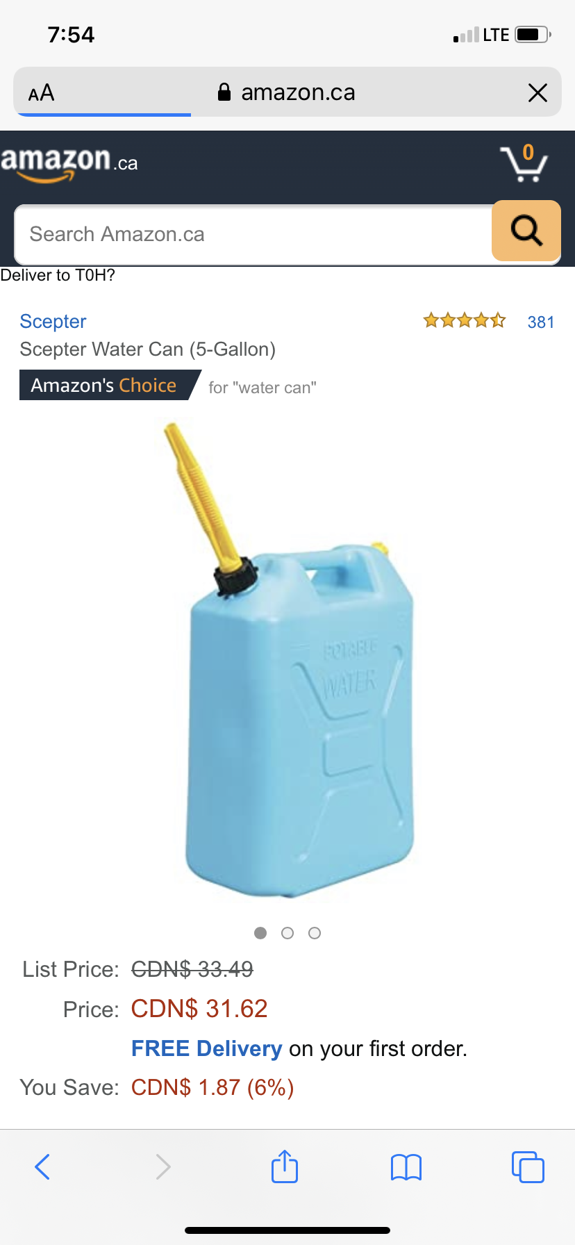

what jugs would you buy to keep my techs full of juice
Jun 20, 2016
6,564
Jeff T
These... get a heavy duty trolley/cart, and prefill the jugs MIXED with the chemistry. Then, all you do is drop them randomly throughout the job with a change of pads, and production increases...

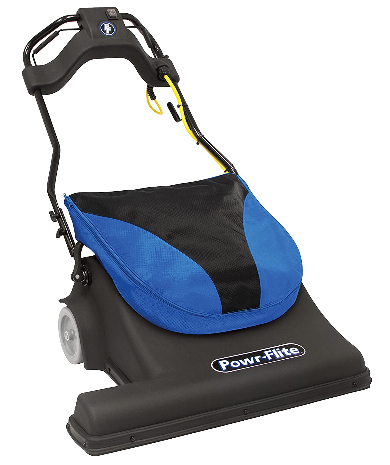

thoughts about buying one of these vs putting more man power on more regular upright vacuums
Jun 20, 2016
6,564
Jeff T
Unless you are cleaning football field size open area, it would be useless. Most commercial is offices, cubicles, and normal width hallways. You need a 12”, a 15 or 18”... AND a backpack vac..... I almost never use my 18....
Think of VLM as a system. Yes, you can just plow through with the Cimex, but prevacing is what’s going to get you back in the door 3-12 months later....

I believe that vacuum is more a top debris vac. You do need a large area vacuum like a 28, but it needs to be a sure enough vacuum. I use an old Clarke upright that you push with two hands, but it’s a beast and heavy. Matches my Cimex😀 Still need a regular upright too.

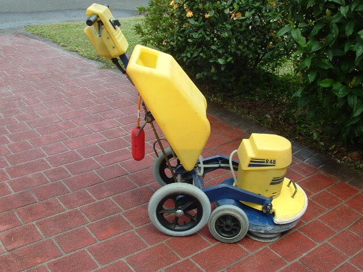

one thing to think about is the wheel upgrade for the cymex I have one with and one with out I use the one with the bigger wheels .
It handles a lot nicer its worth the couple hundred bucks in my opinion but also not a must have .I want harly grips for mine lol.
Shorty
RIP
Nov 8, 2006
5,111
Shorty Glanville
Mine has both.
Pic of the Big Wheels was taken in January 2008.

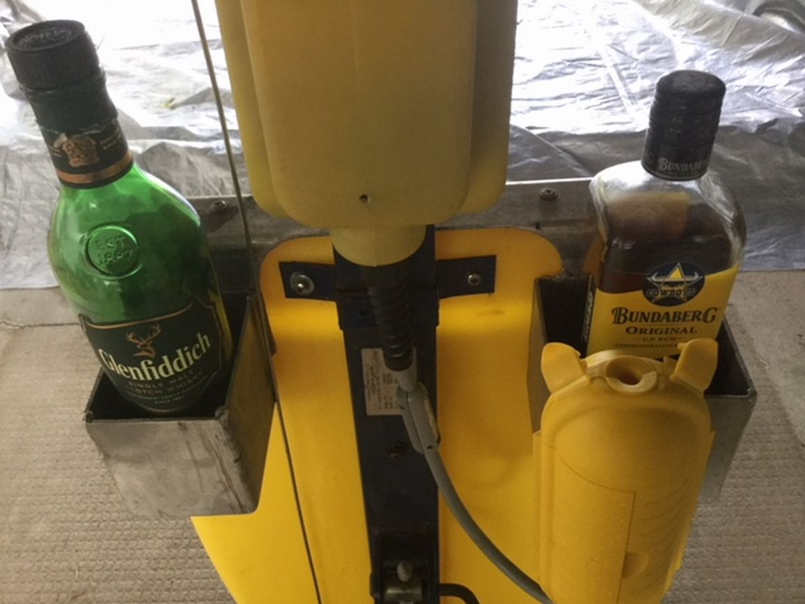

Your cymex looks different then mine mine do not have the plastic cover .
Is that a upgrade ?
