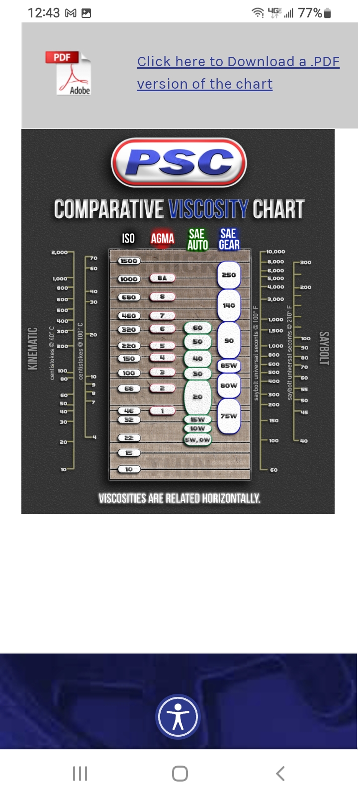

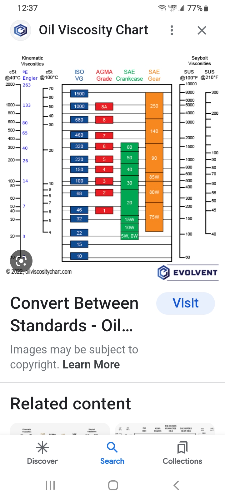

When giving advice i try to lose as much techno mombo jumbo as possible to get the information across and sometimes i dilute it too far. For those techmo geeks this one's for you

According to Dwain's chart, Amsoil Severe Gear SAE250 is too heavy. I would just order some Aeon, but it appears my distributor is closed for the holidays, as is PD Blowers.
I have some Amsoil Severe Gear 75W-90, which is too light.
Will try mixing 250 with 75W-90 for now. Or pick up some quality SAE 90 gear oil.
Thanks, Dwain!

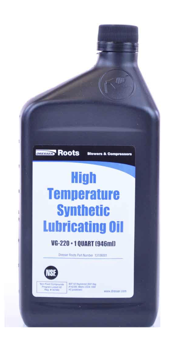

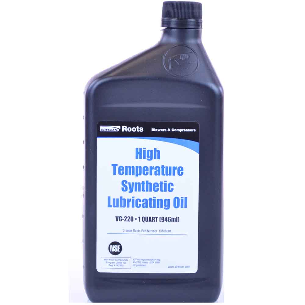

my 47 has been very good to me since 2003. I bought the high heat roots.
drained, cleaned her up, refilled…sounds and sucks better then ever. A few extra bucks for oil verses $3k plus new replacement well worth it.
Was quoted $1,200 to drop off and have my 47 serviced/rebuilt. my have it done at some point but runs great at the moment.

Where do you buy Roots oil? I don't dispute the wisdom of using the best when you can find it.

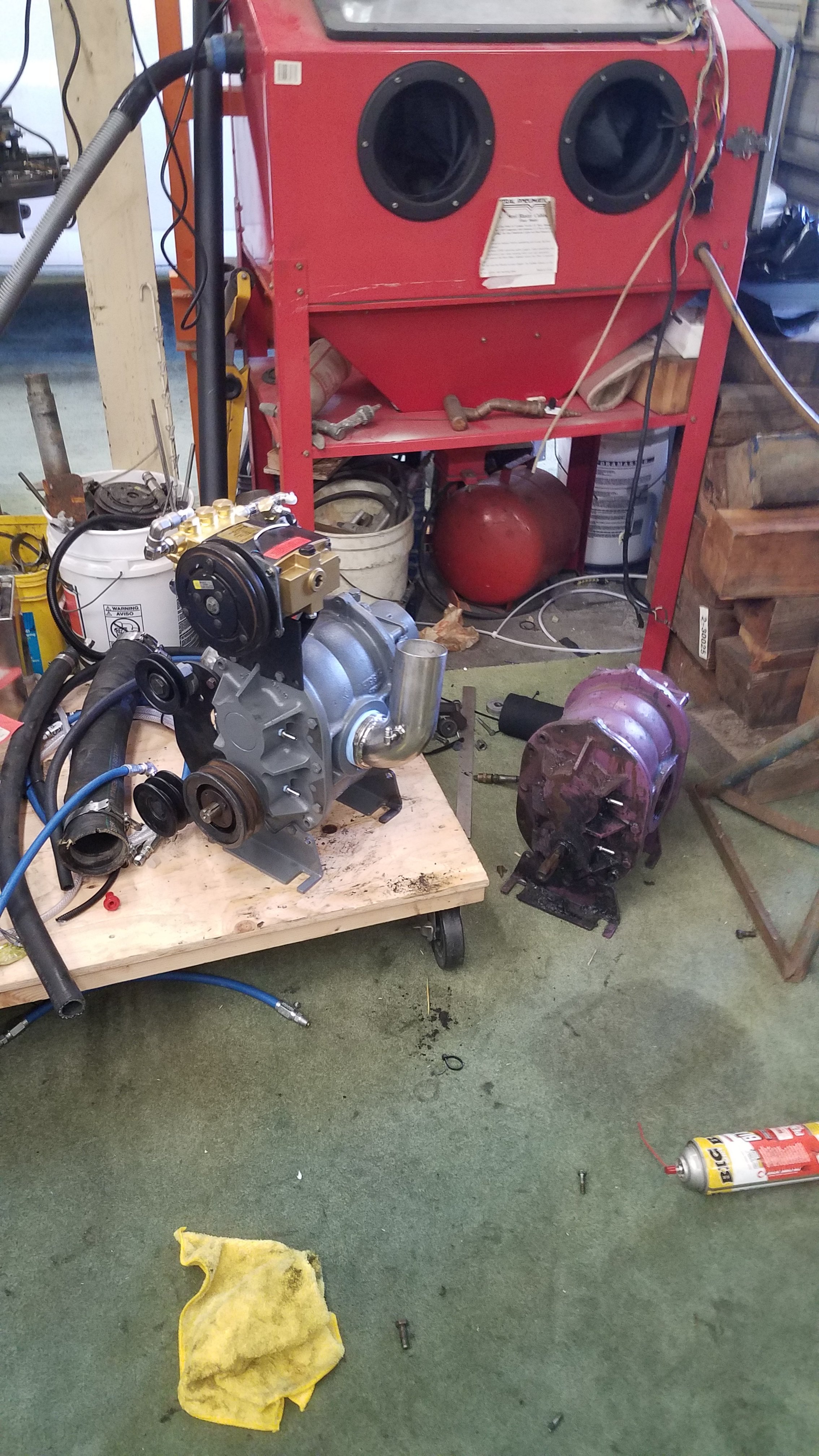

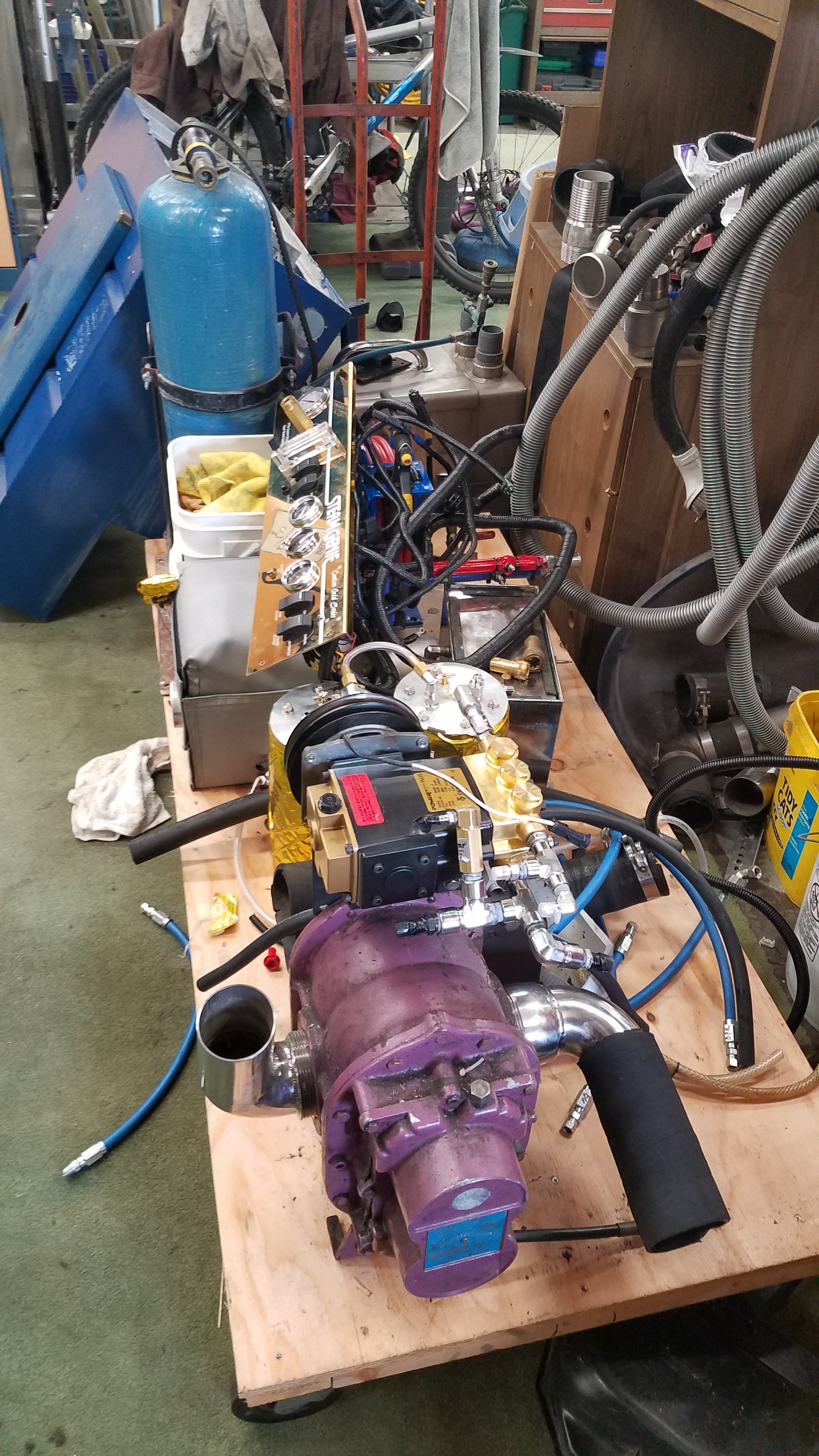

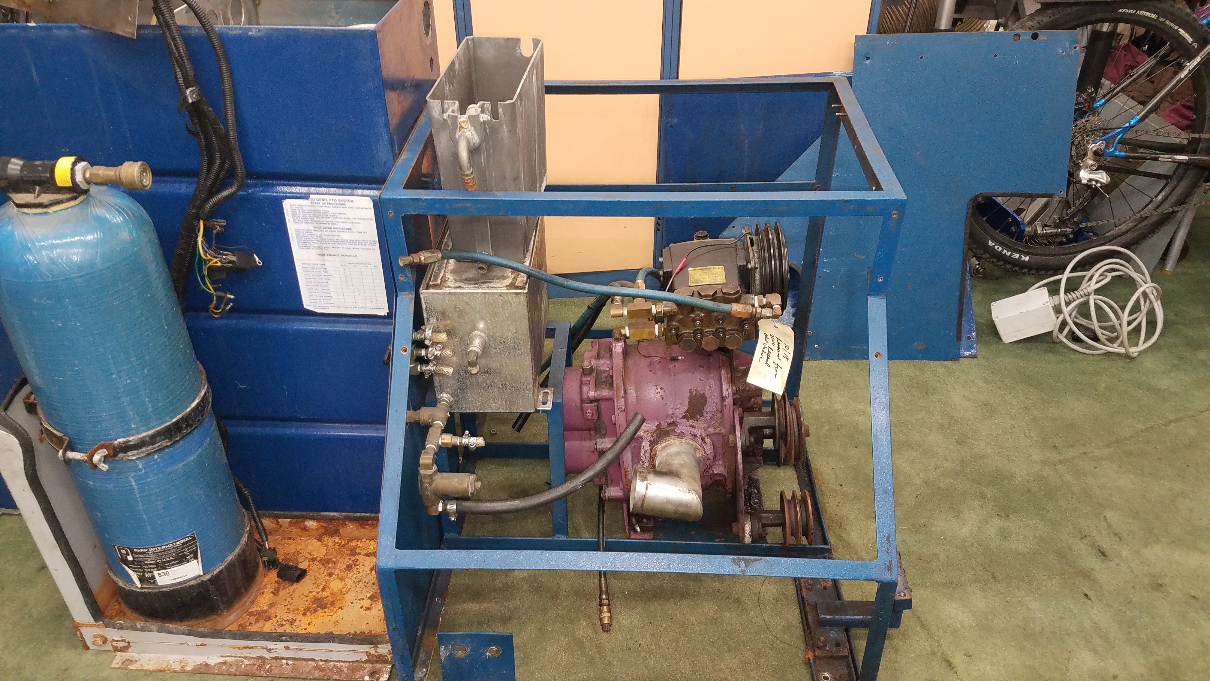

I think now you're just splitting hairs now if you look at the picture of the aeon bottles 1 says gardner Denver which is sutterbuild it's like pump oil , i have a hypro pump but i use cat oil in it instead of hypro oil because i can get cat oil from home depot and id have to special order hypro , it is more important the frequency of service intervals than which brand of blower oil you use when i built frankinstien i retired a 47 blower that was new in1991 and passed down thru 3 machines and has approximately 14,000 hours on it but i changed the oil in it every time i changed the pump oil 500 hour intervals

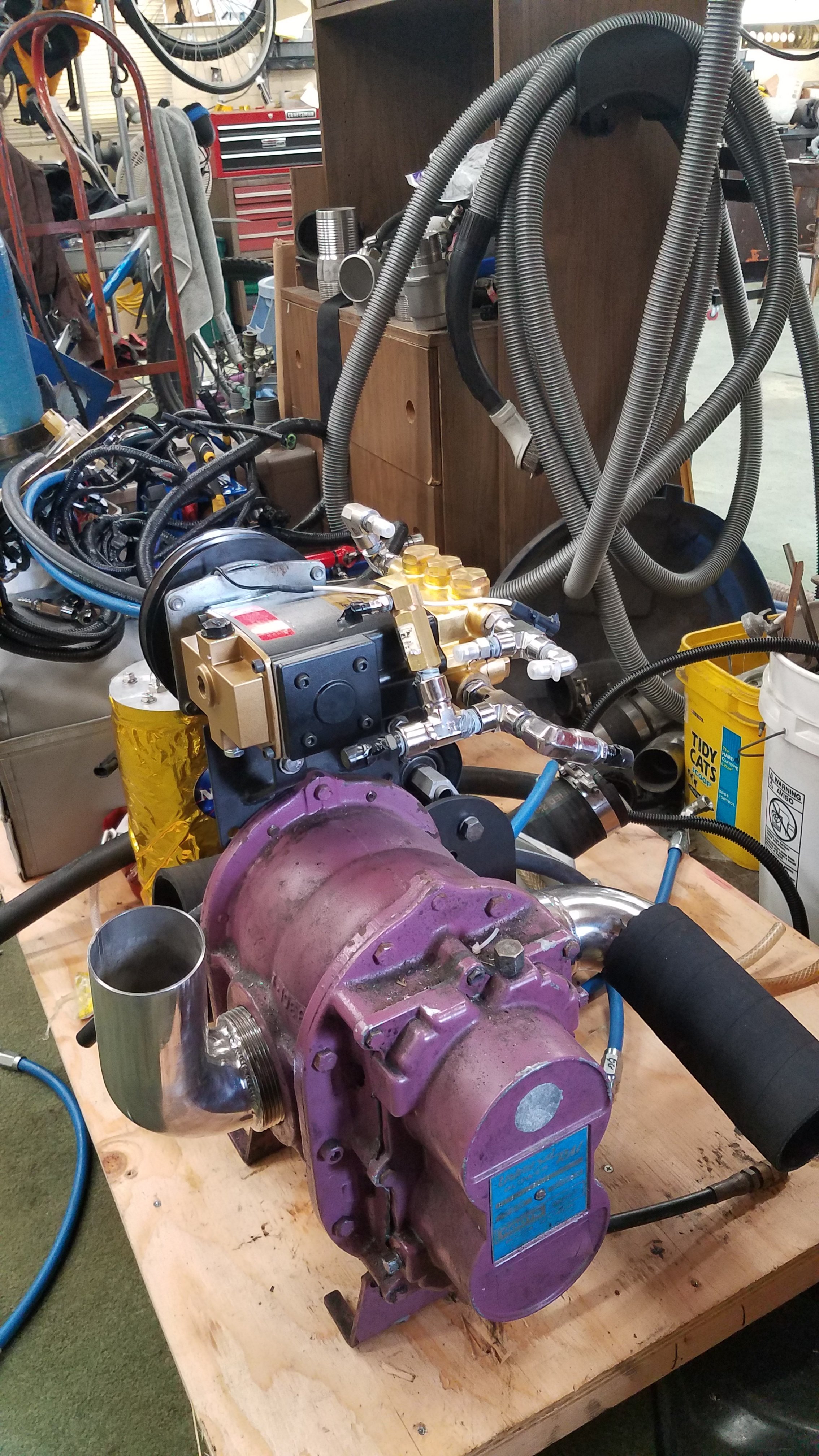

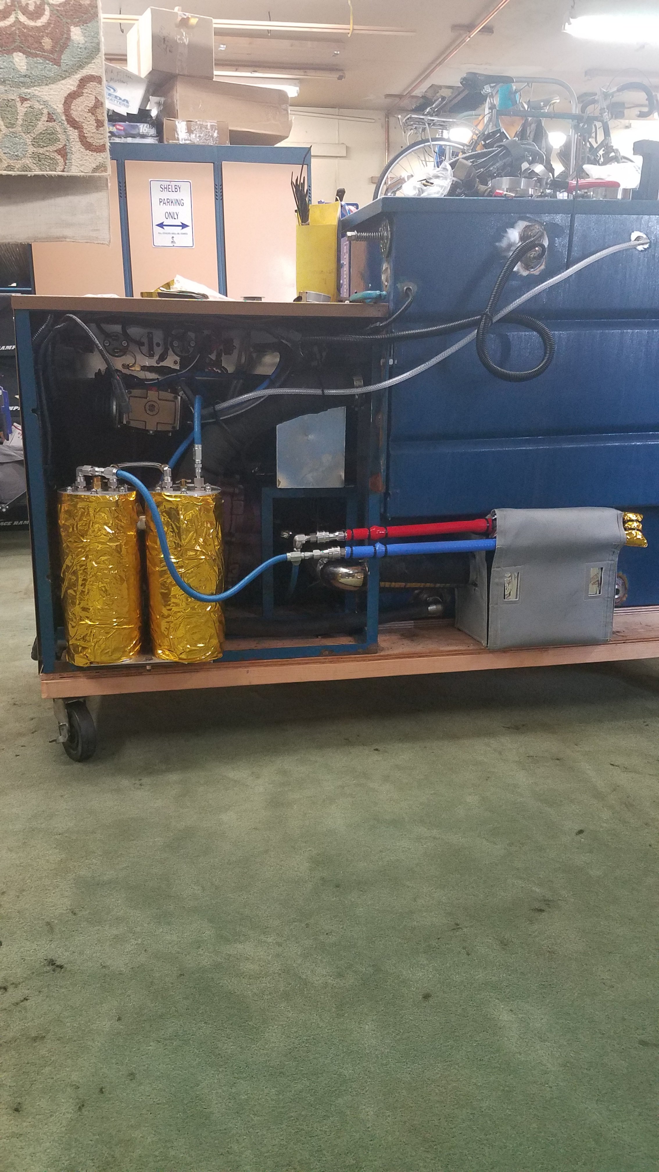

why did the cool purple need to retire? Couldn’t it be rebuilt? Cracked housing?

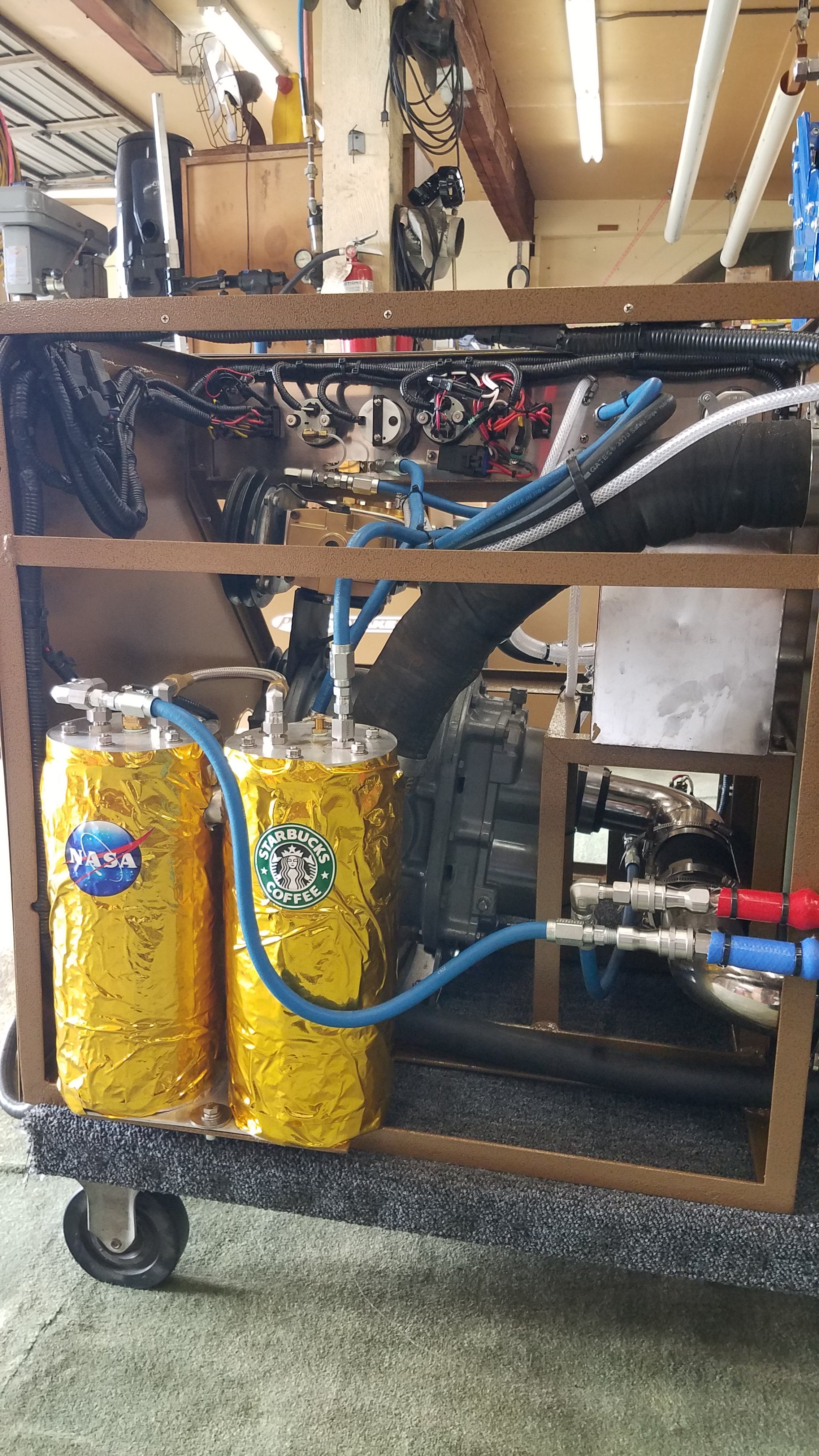

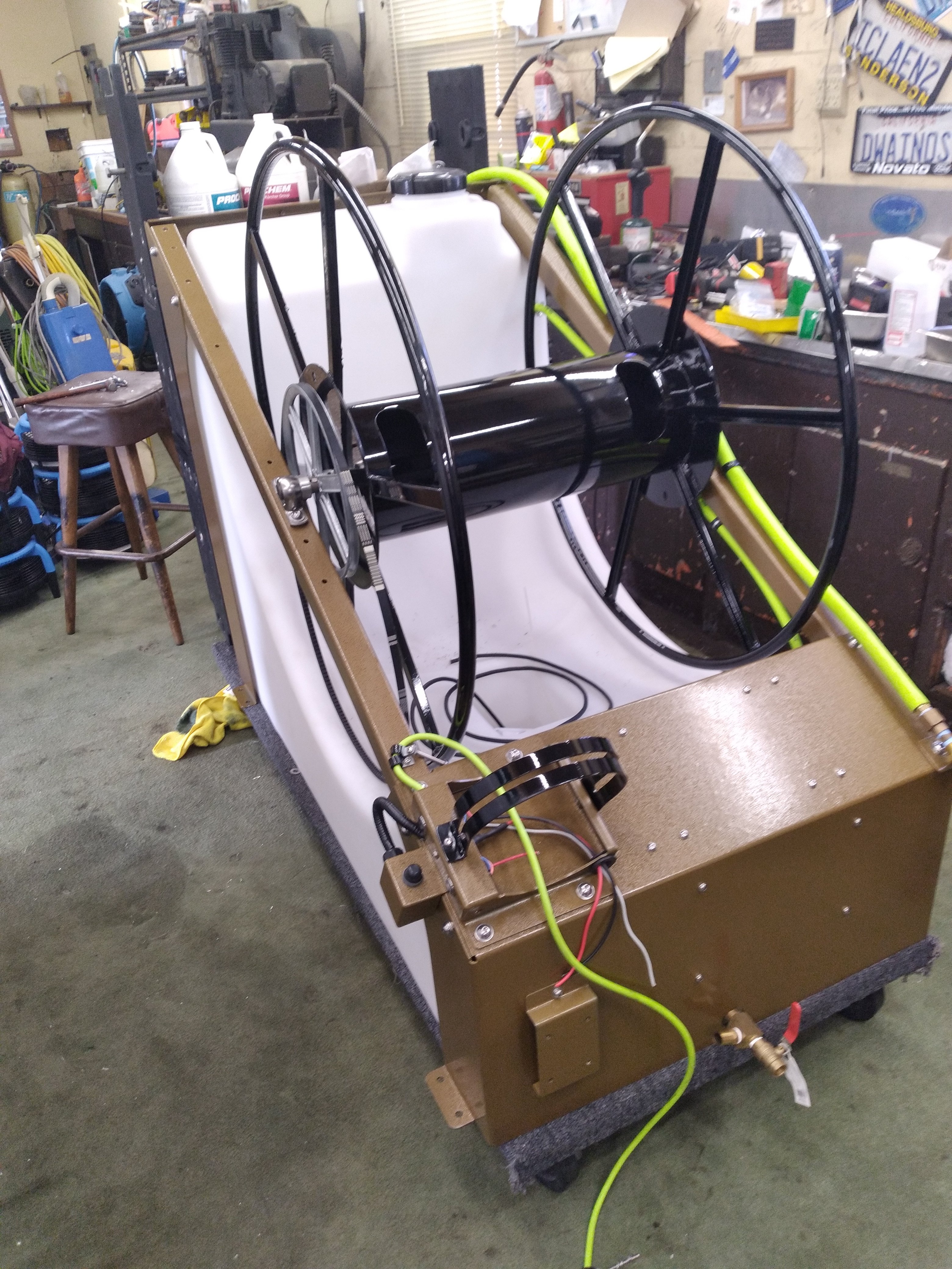

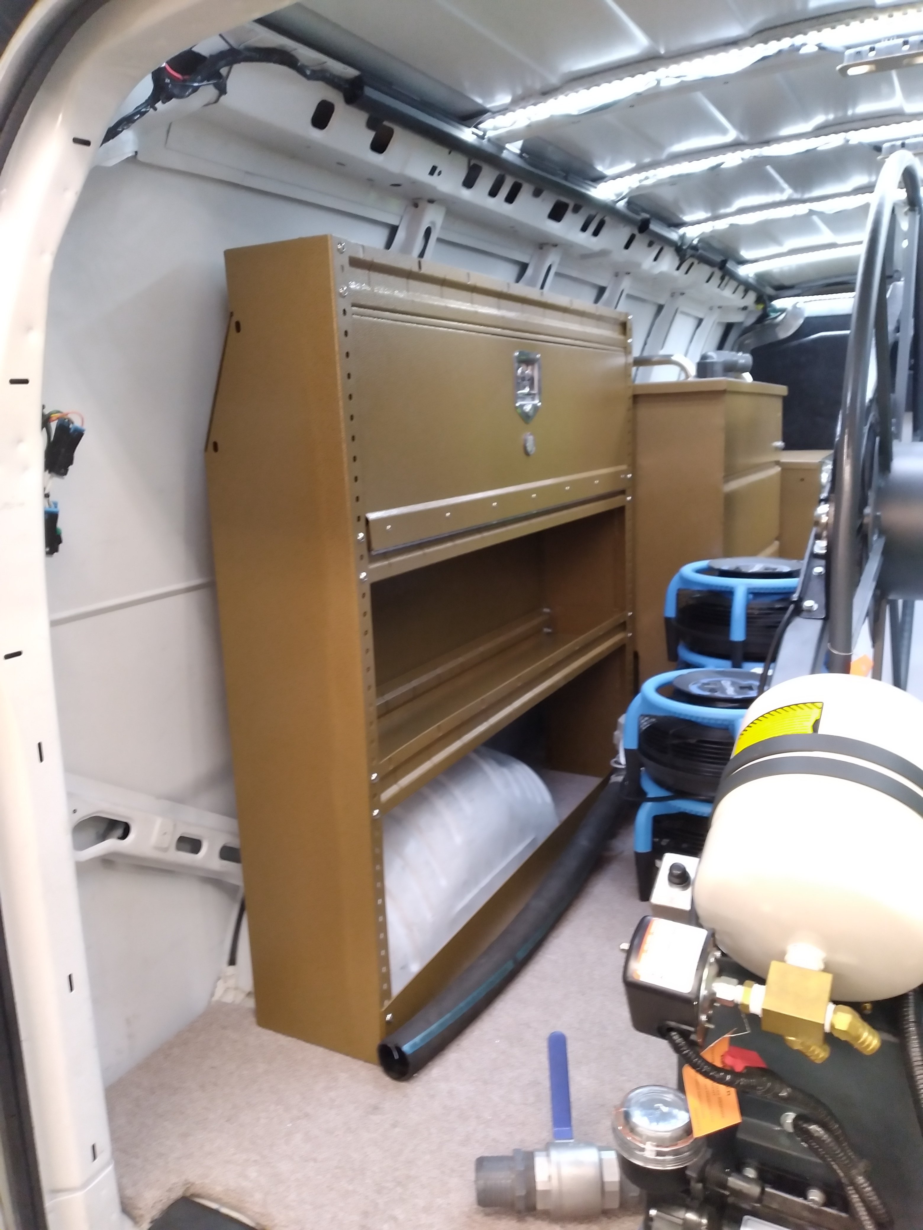

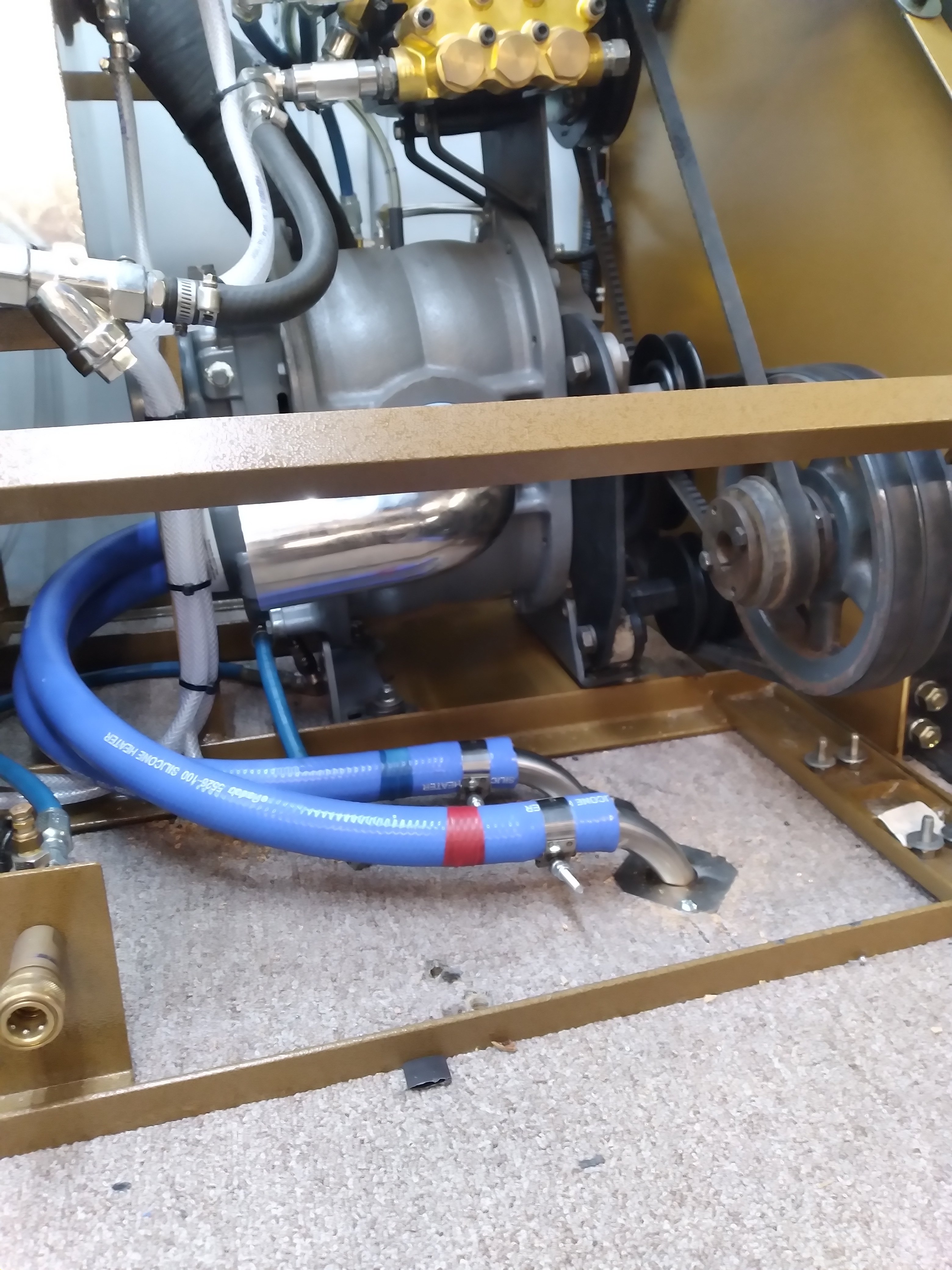

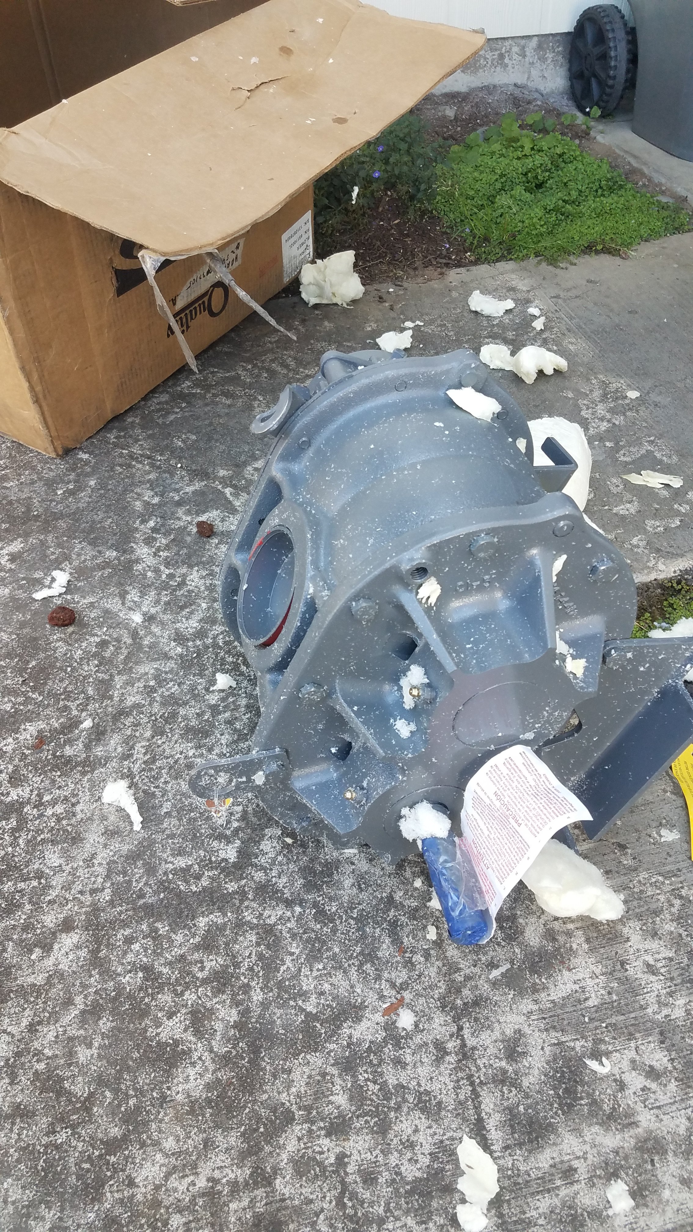

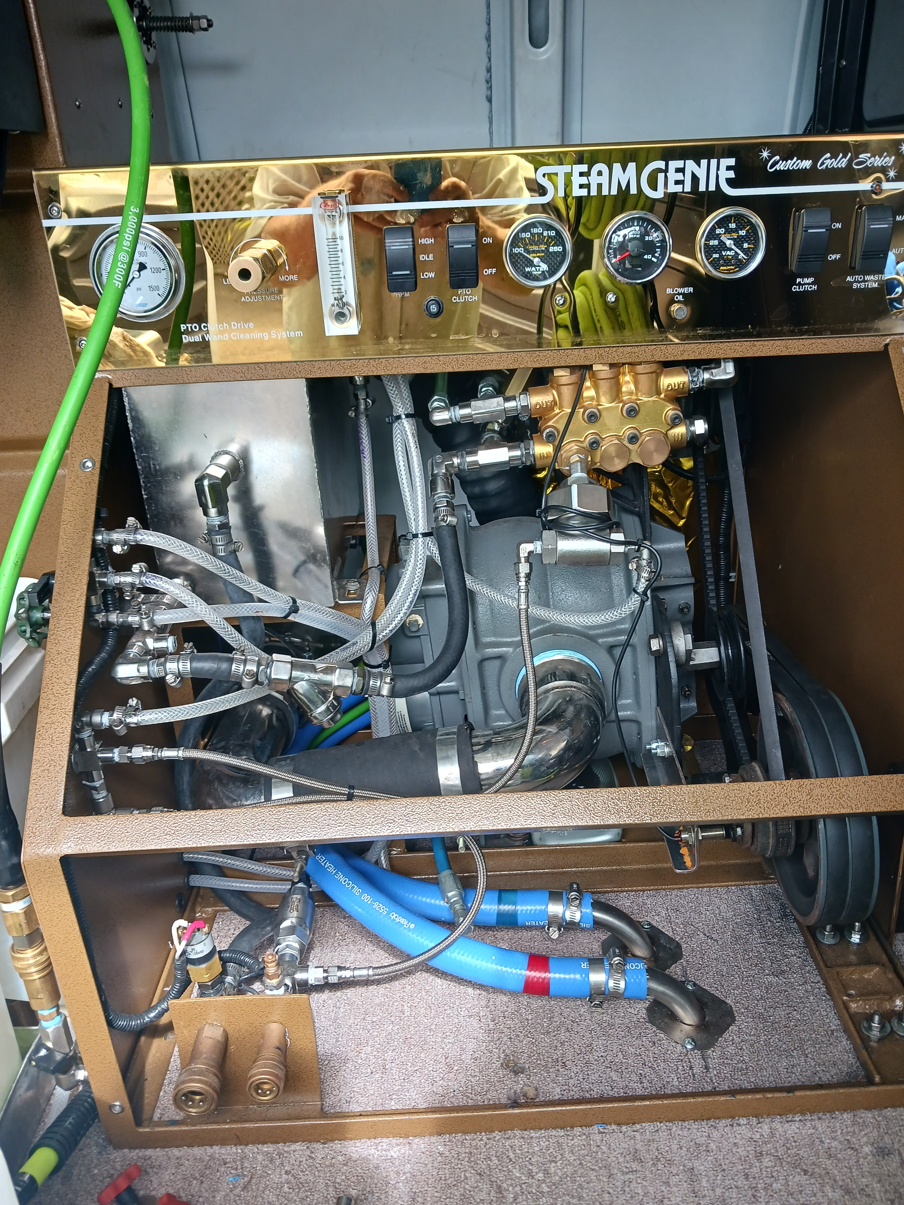

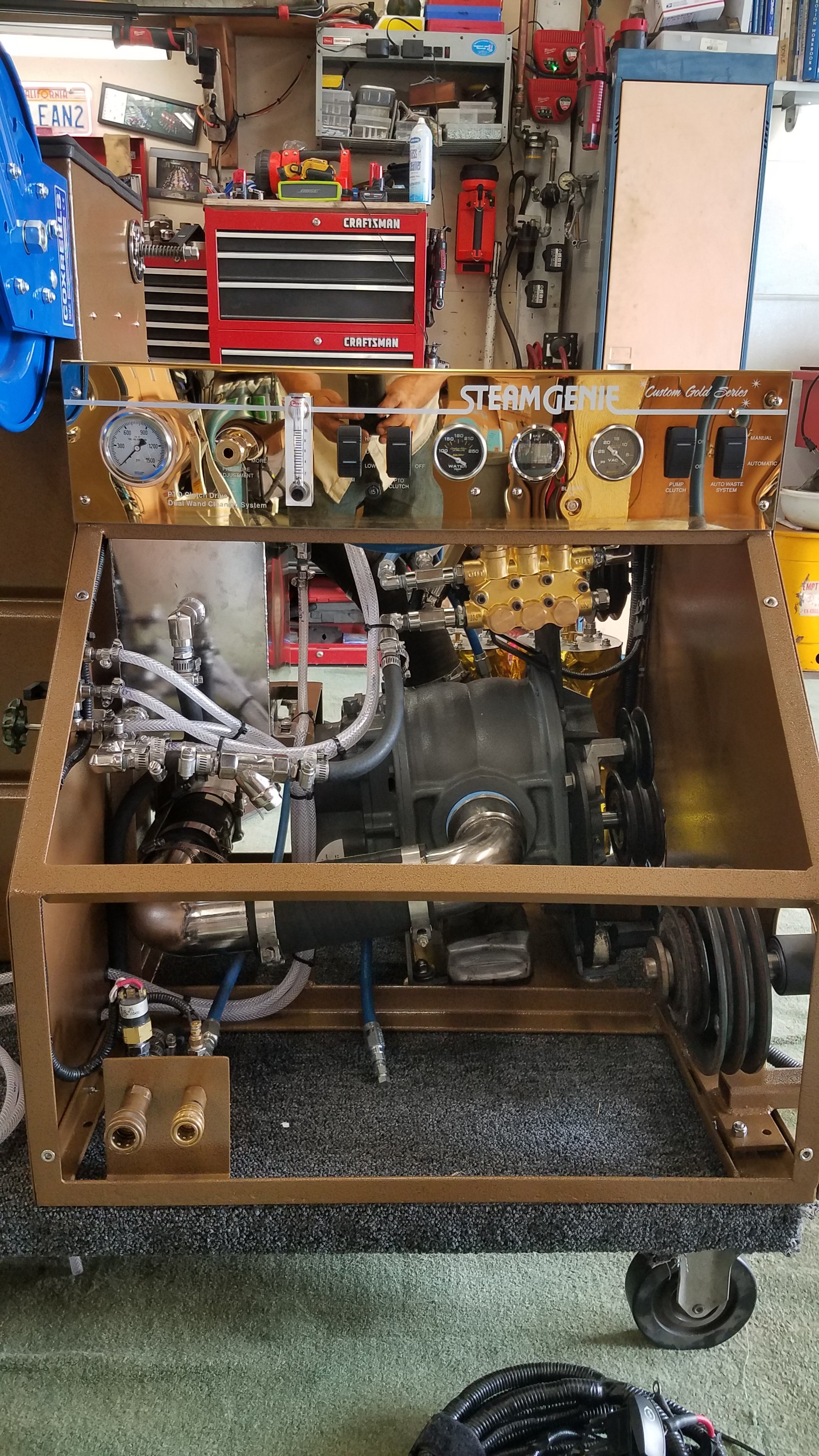

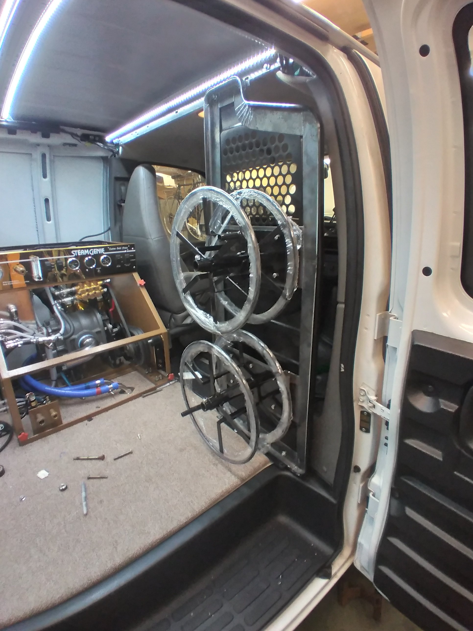

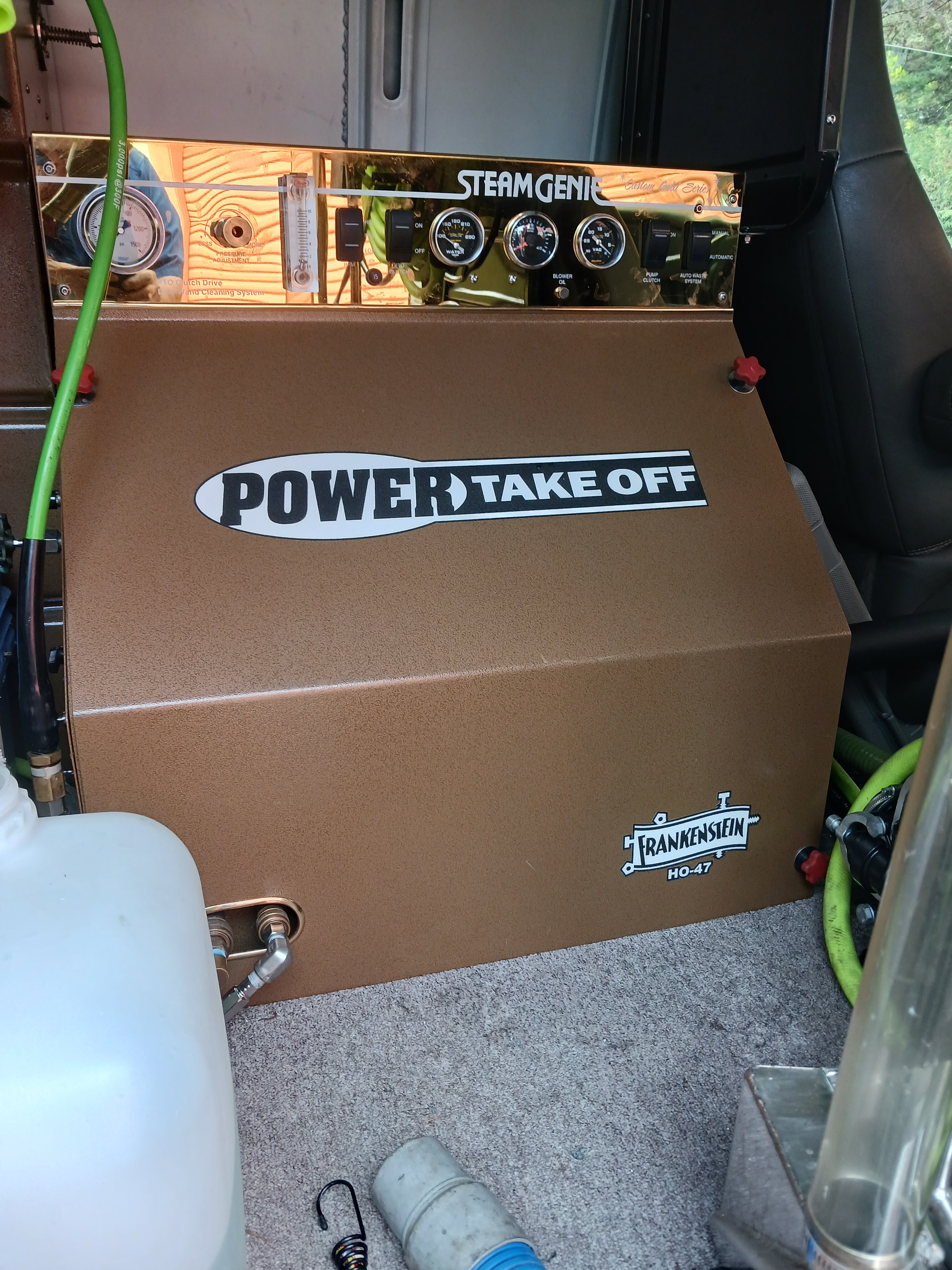

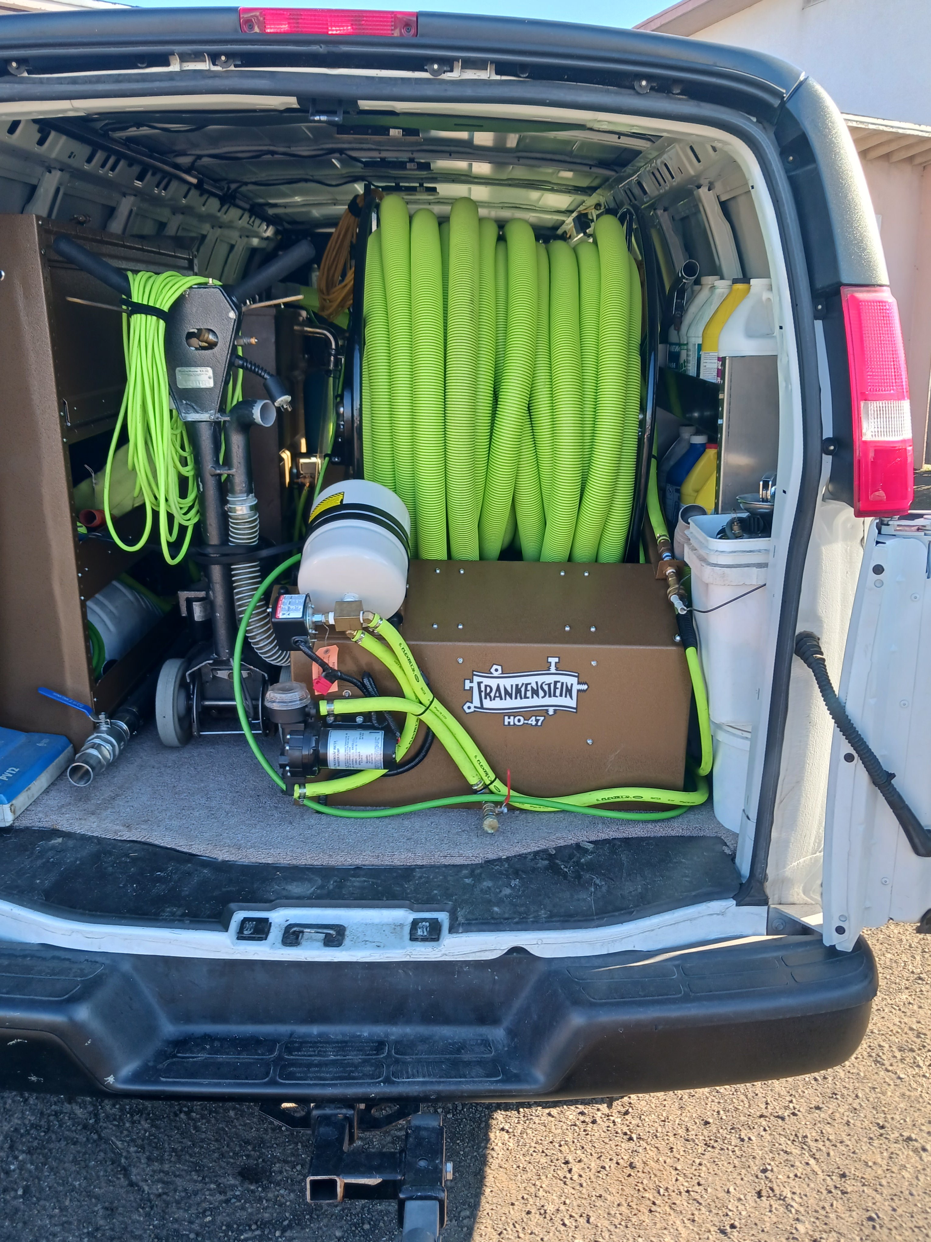

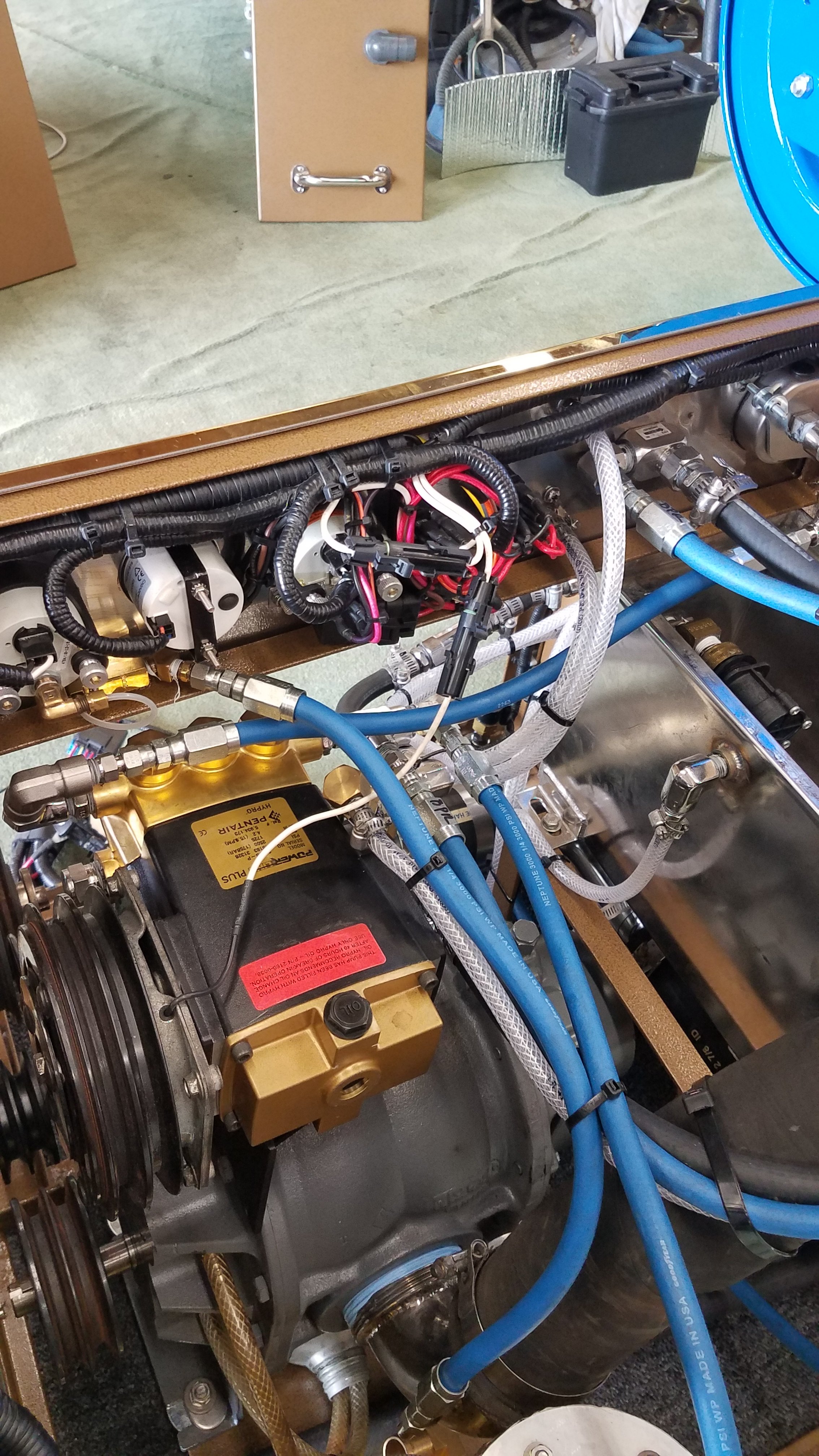

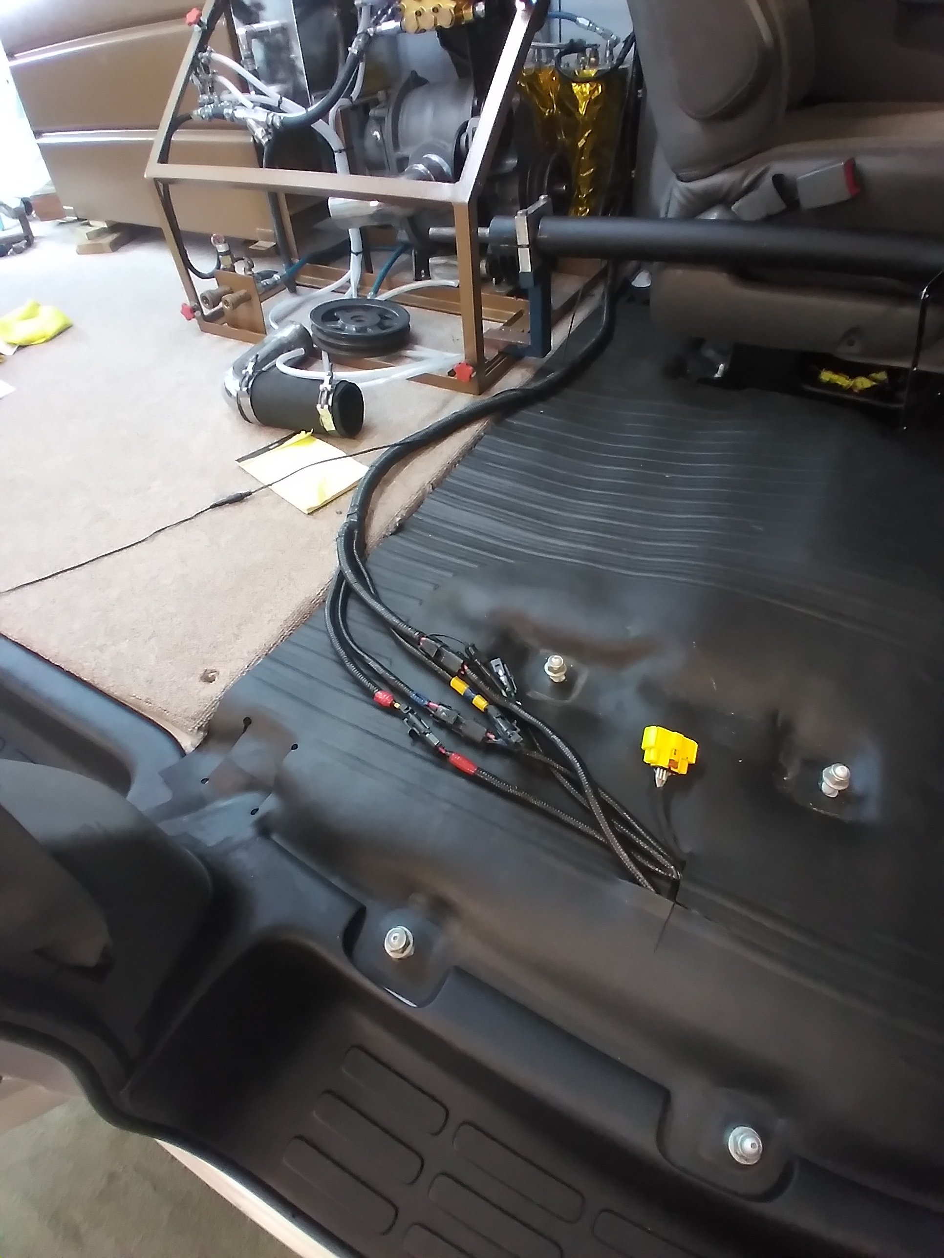

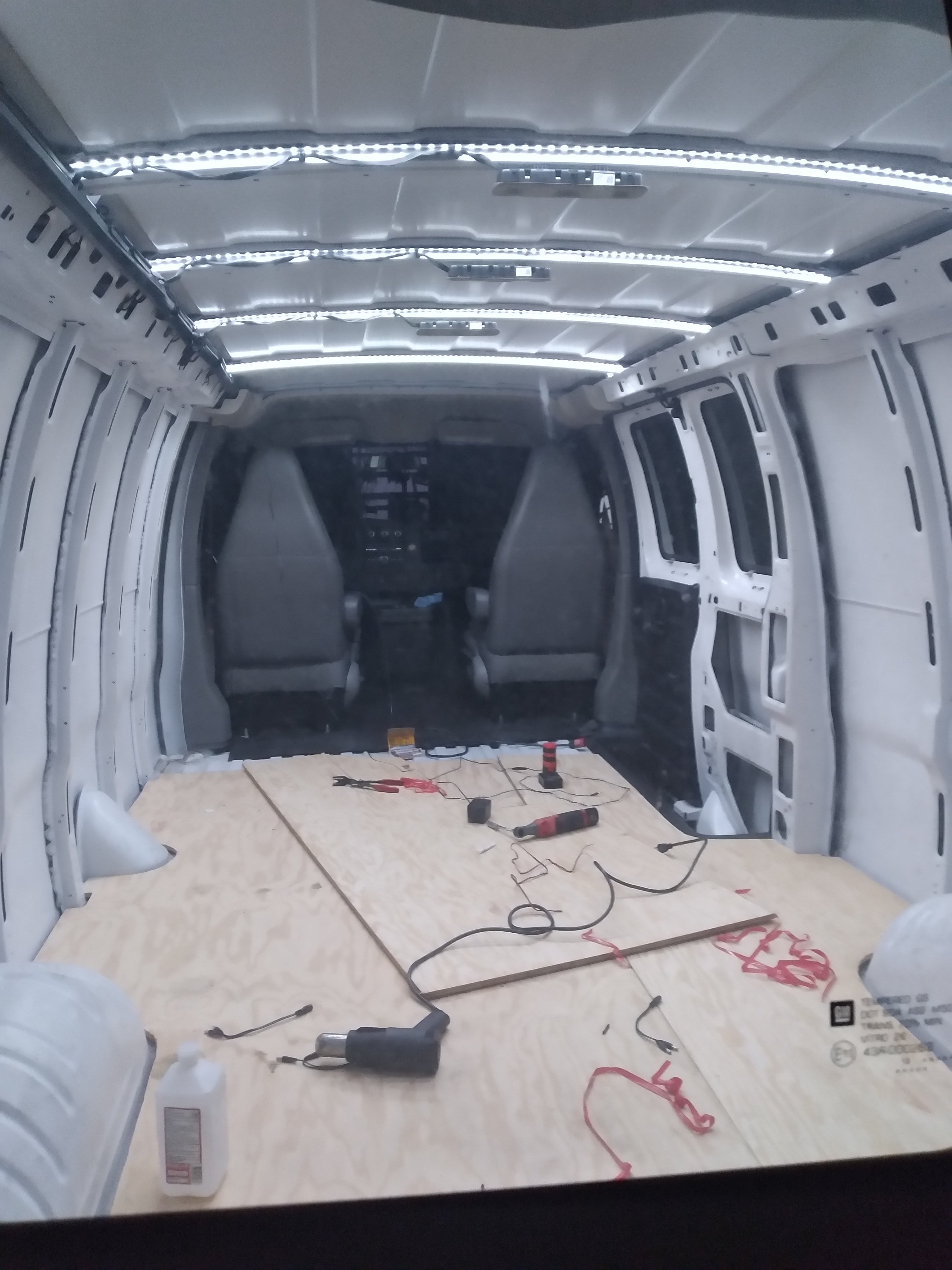

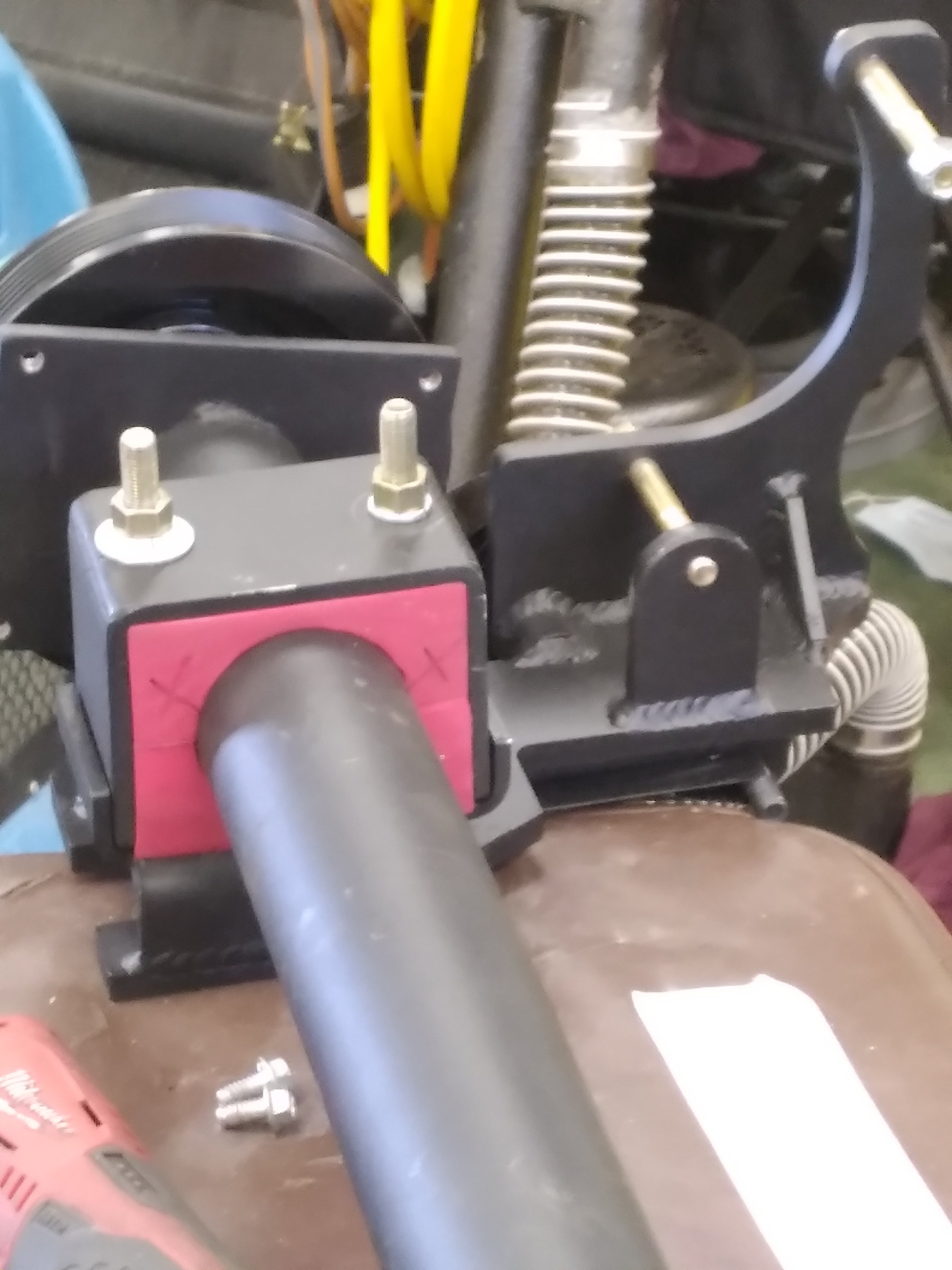

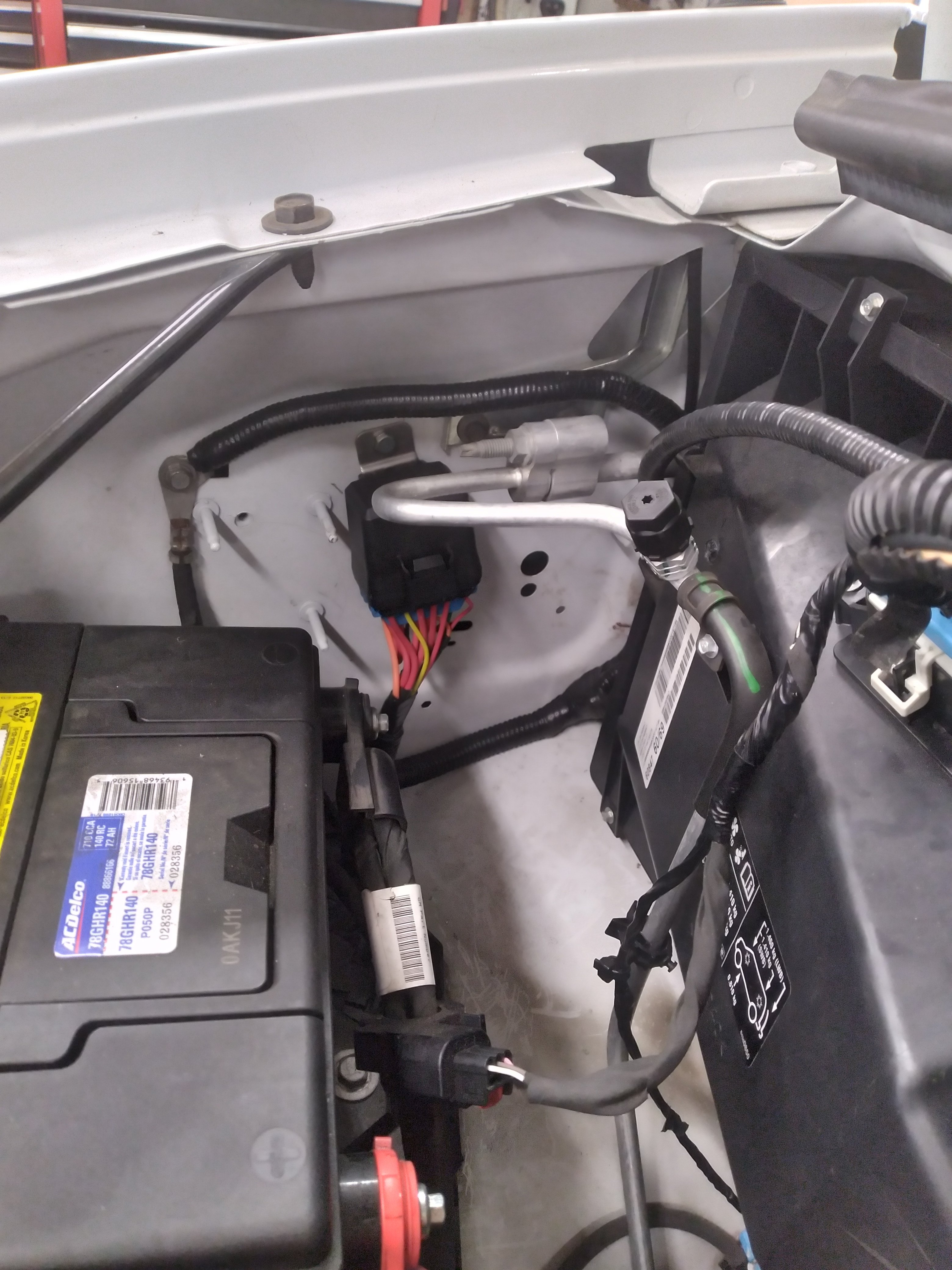

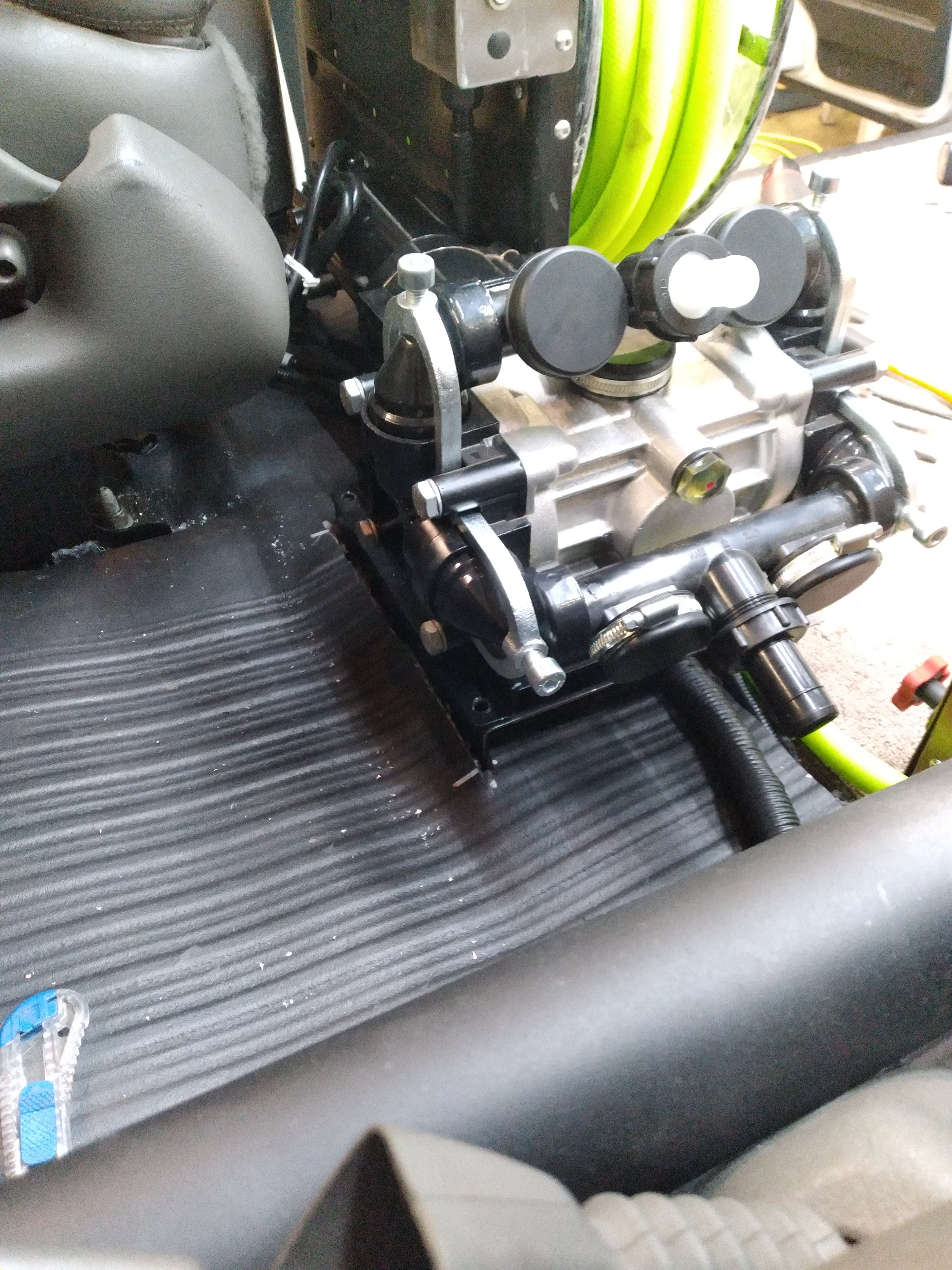

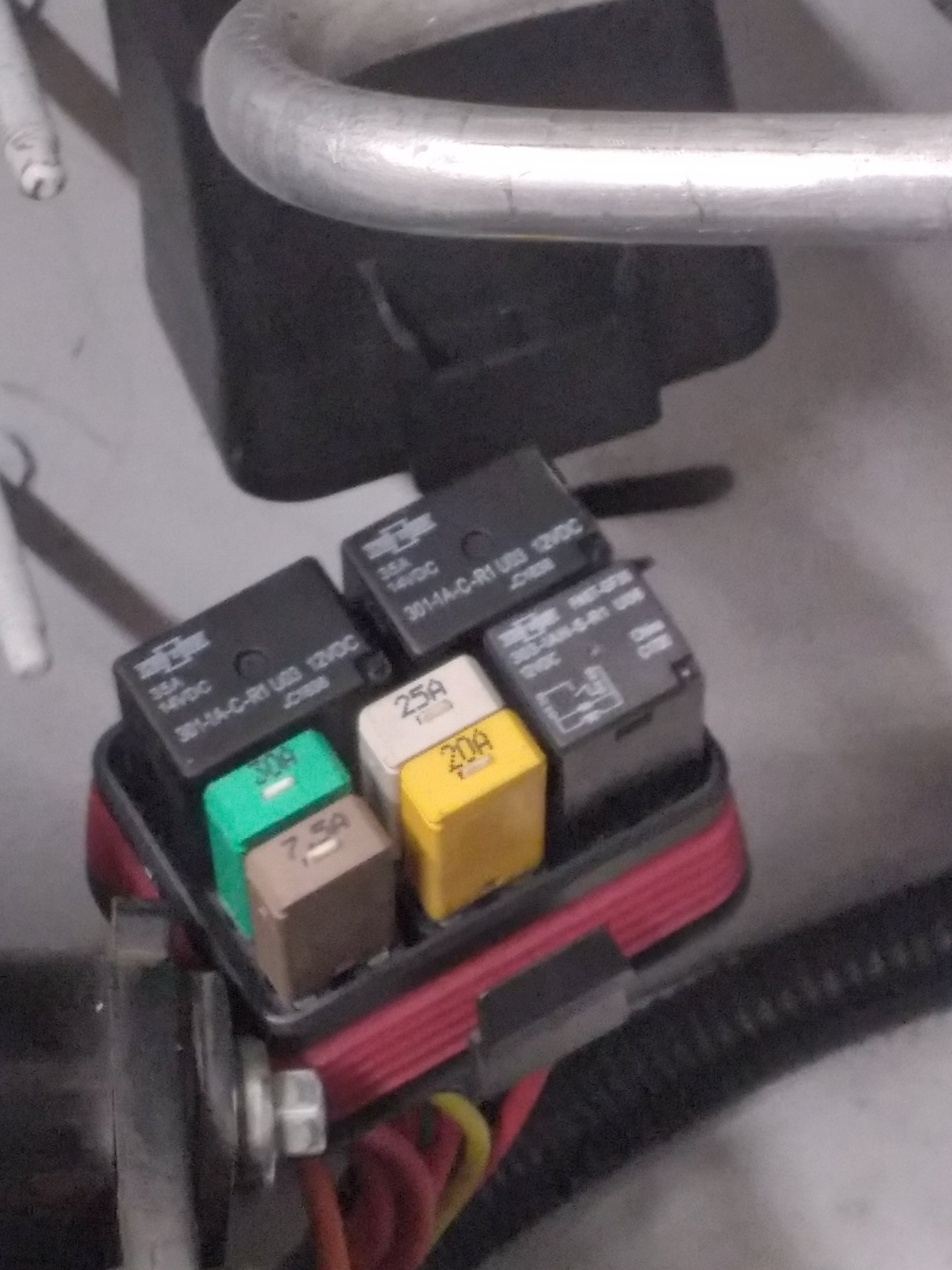

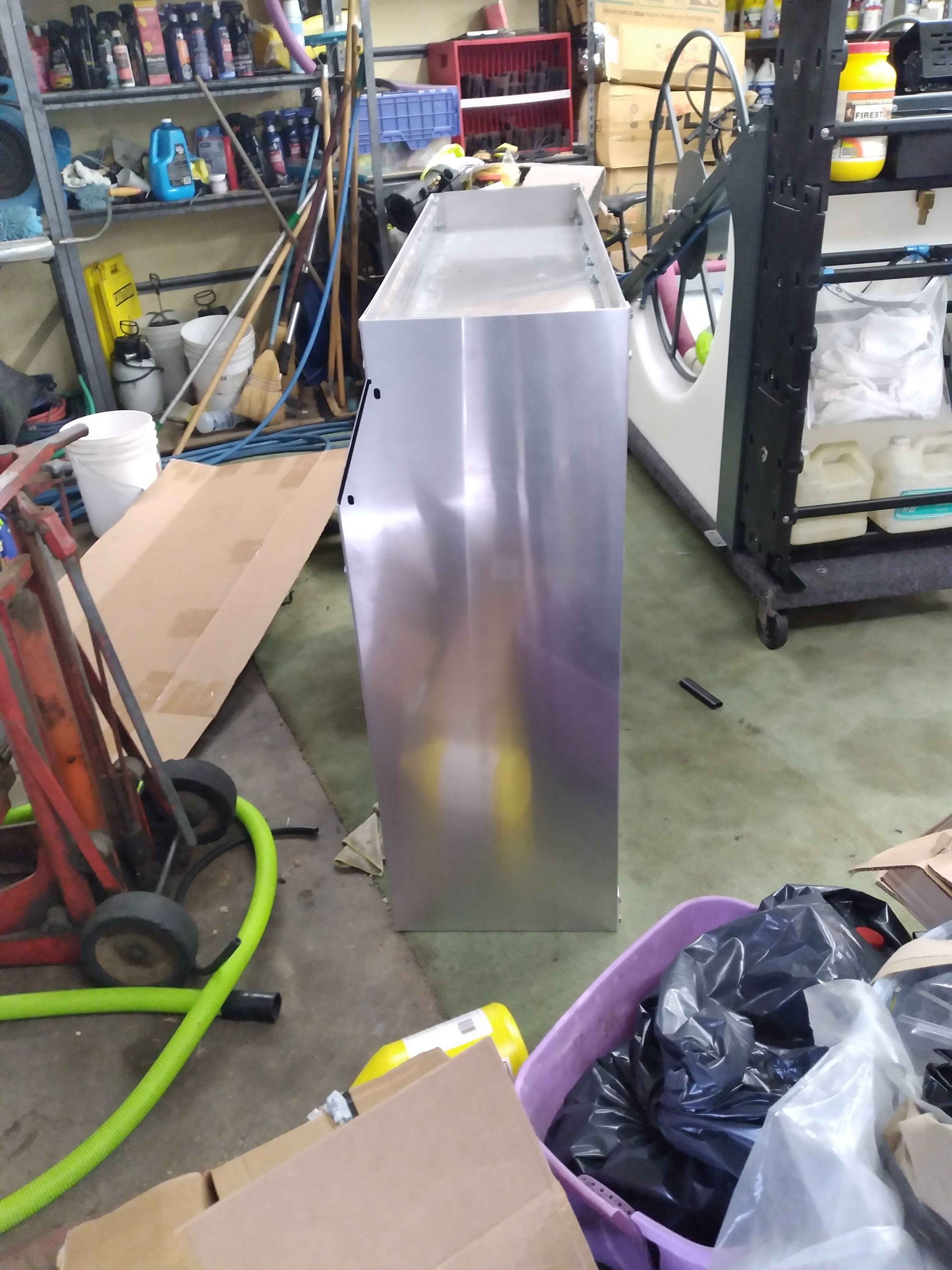

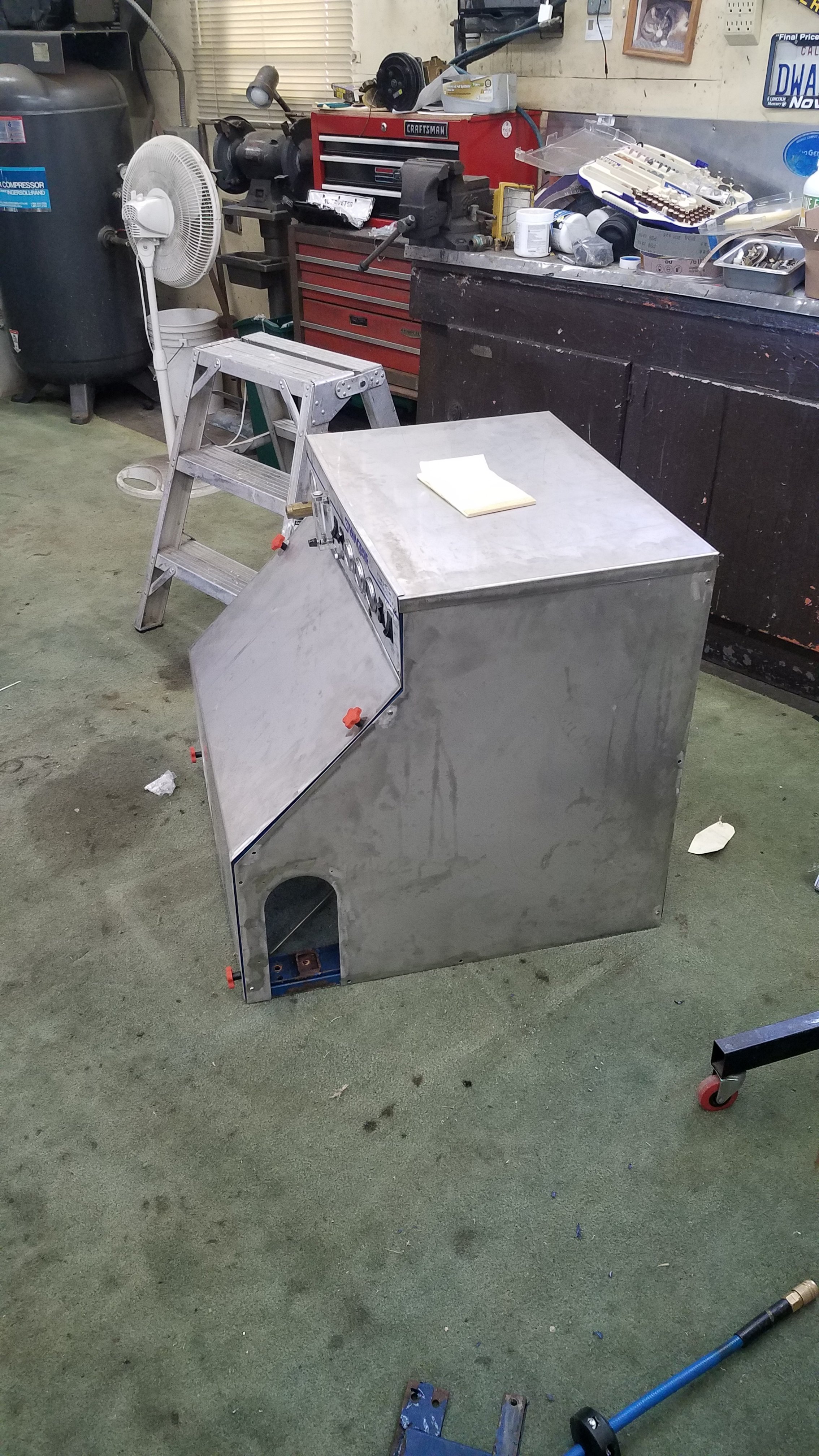

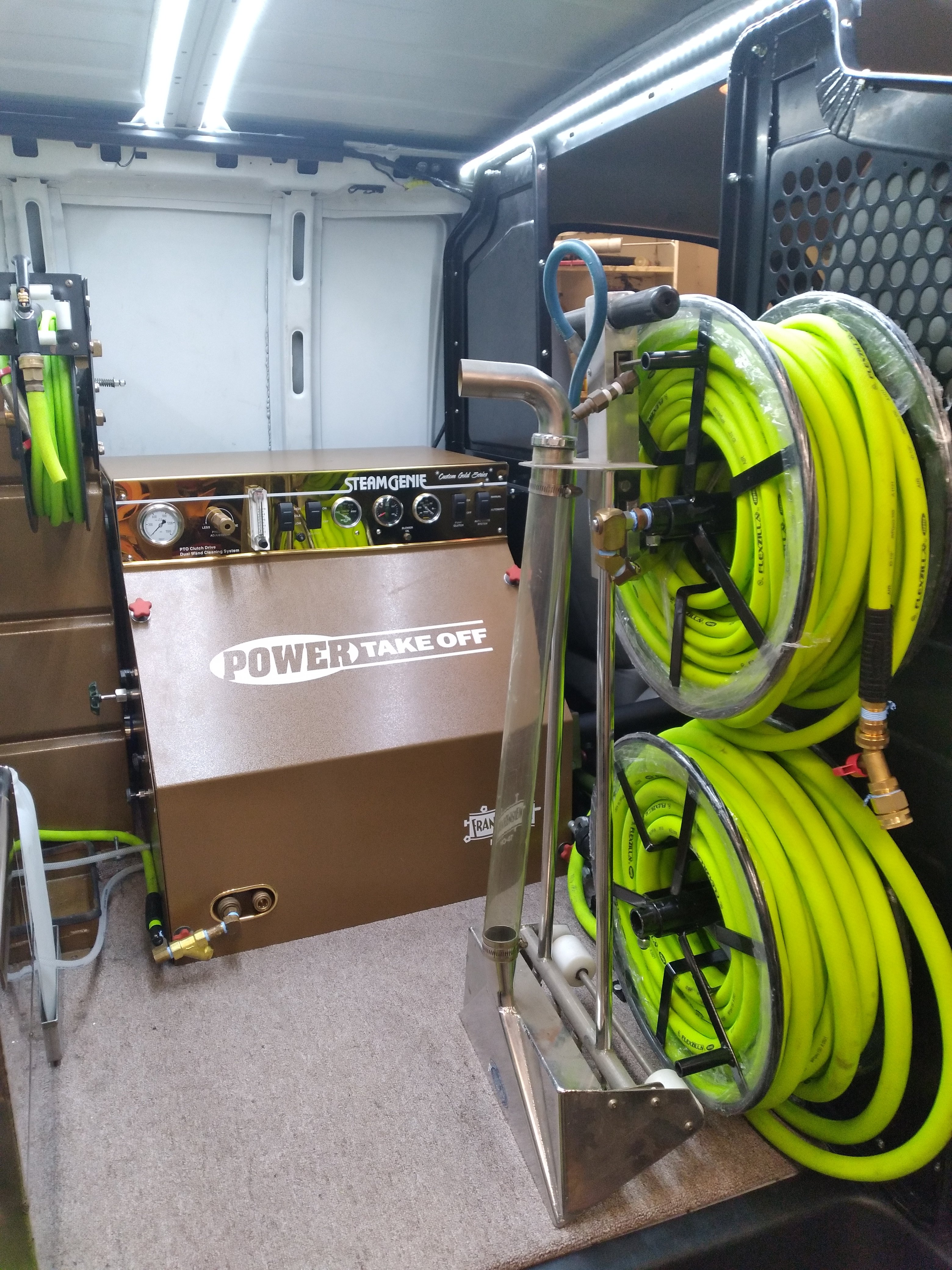

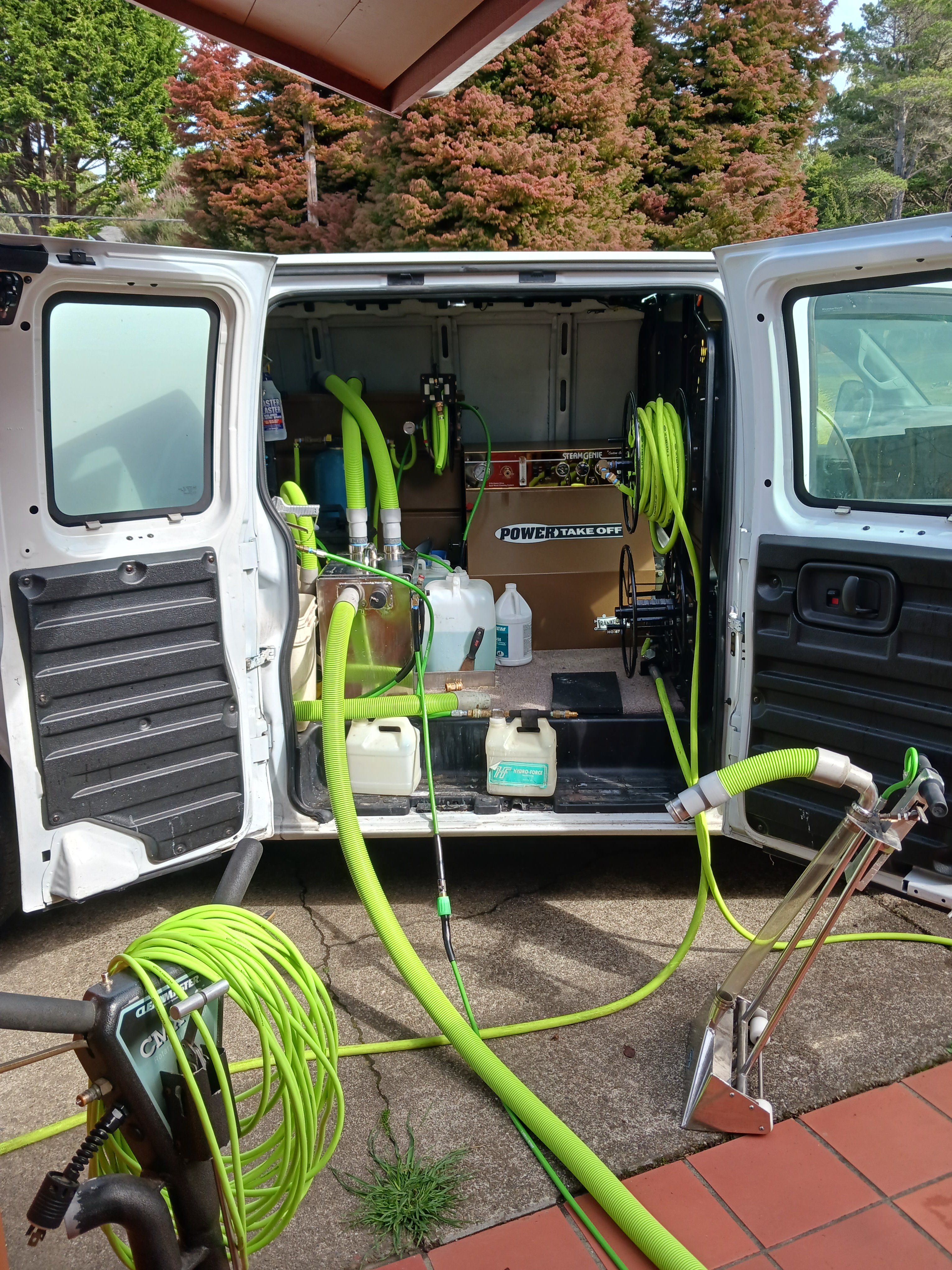

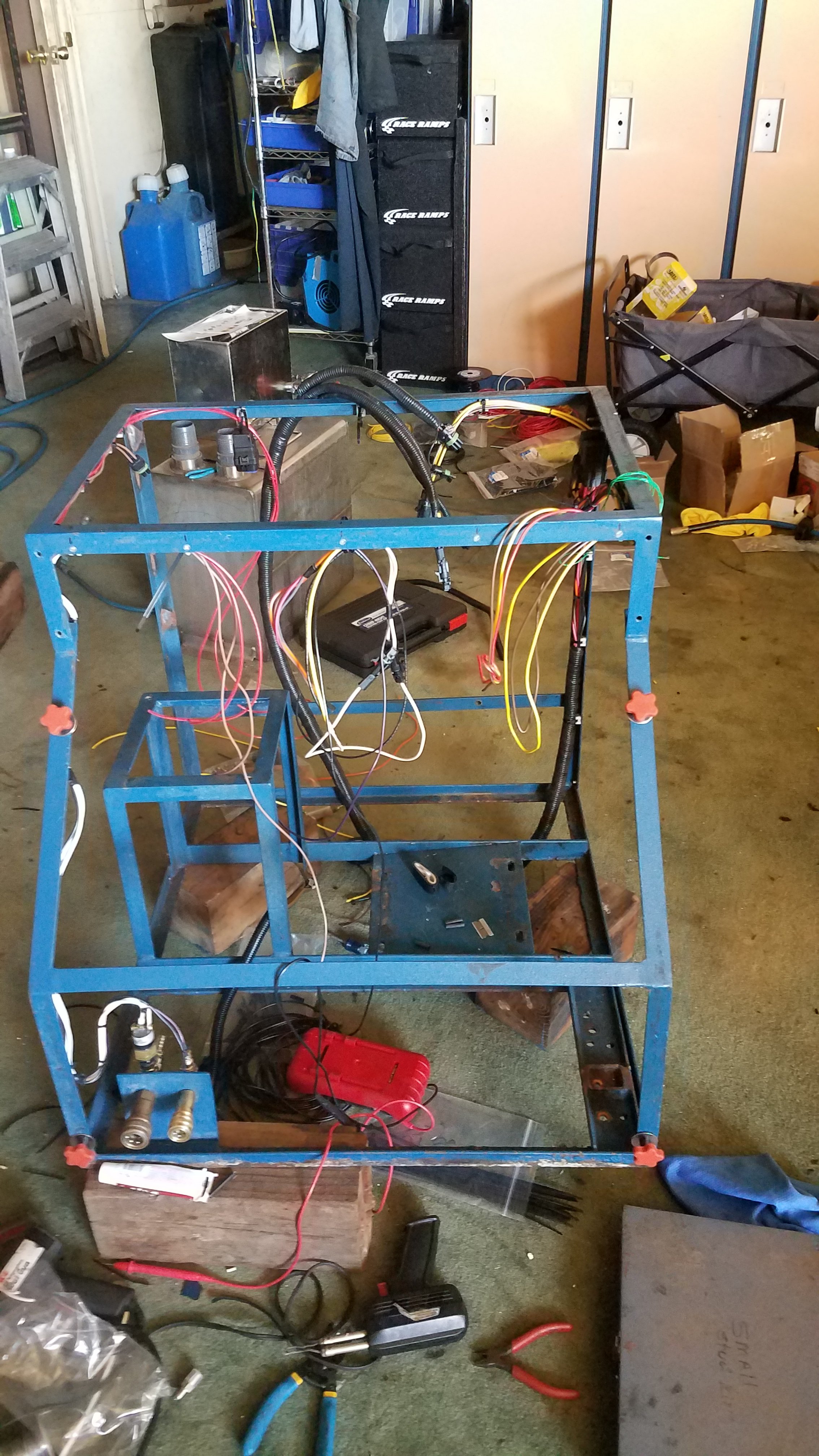

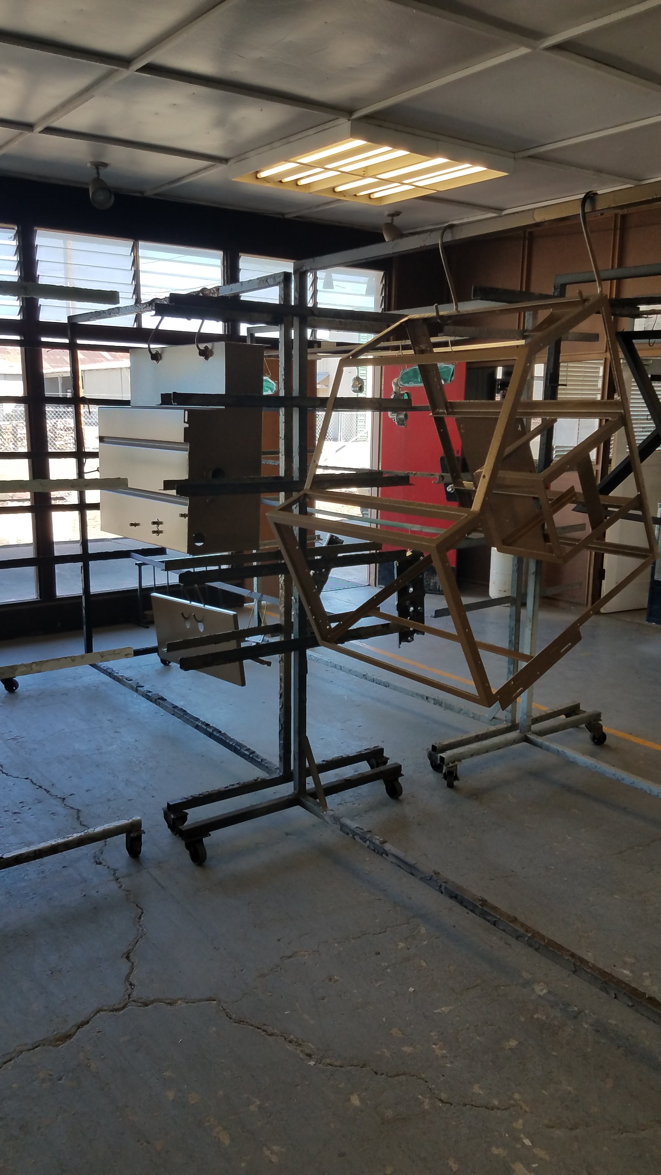

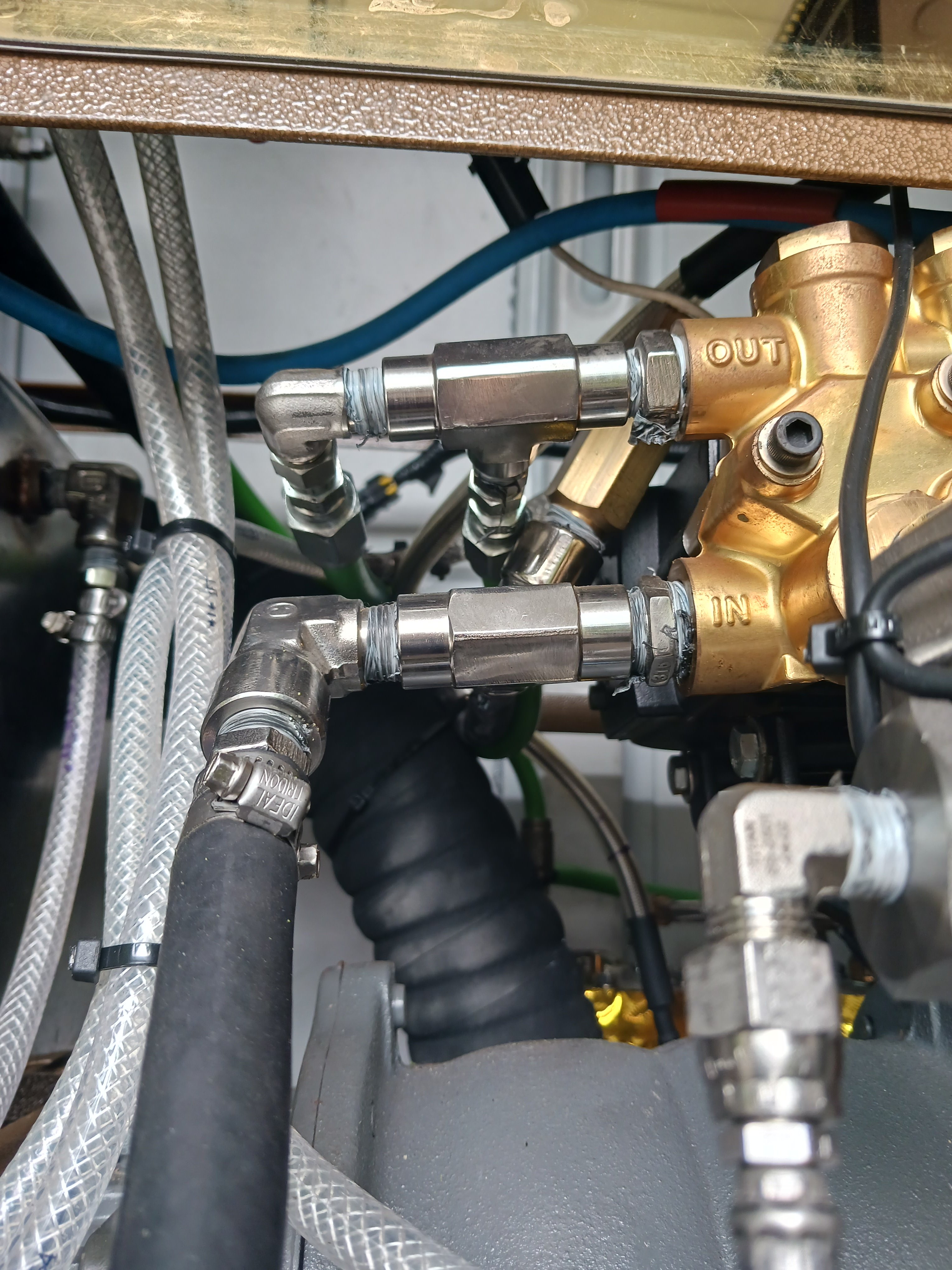

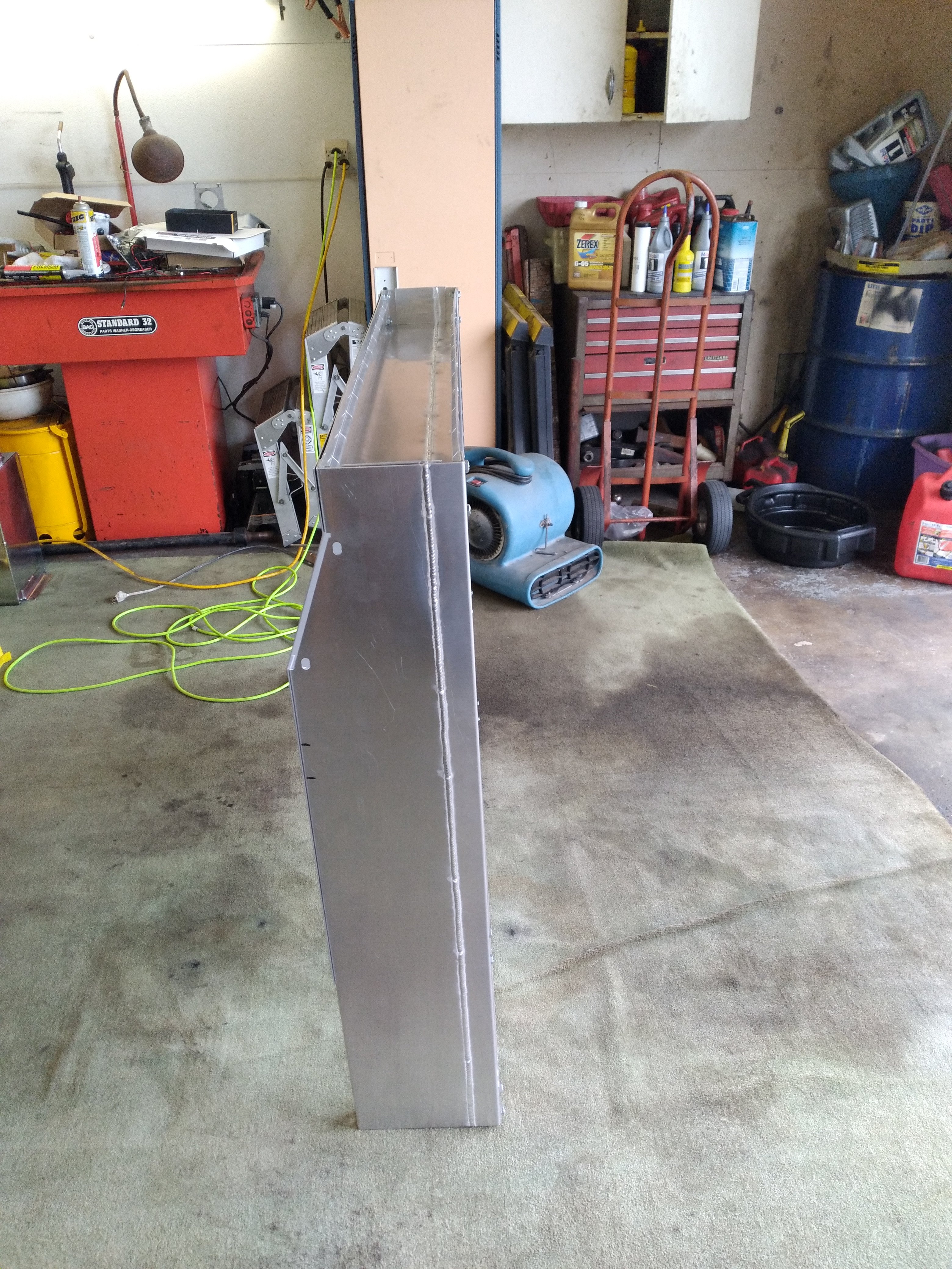

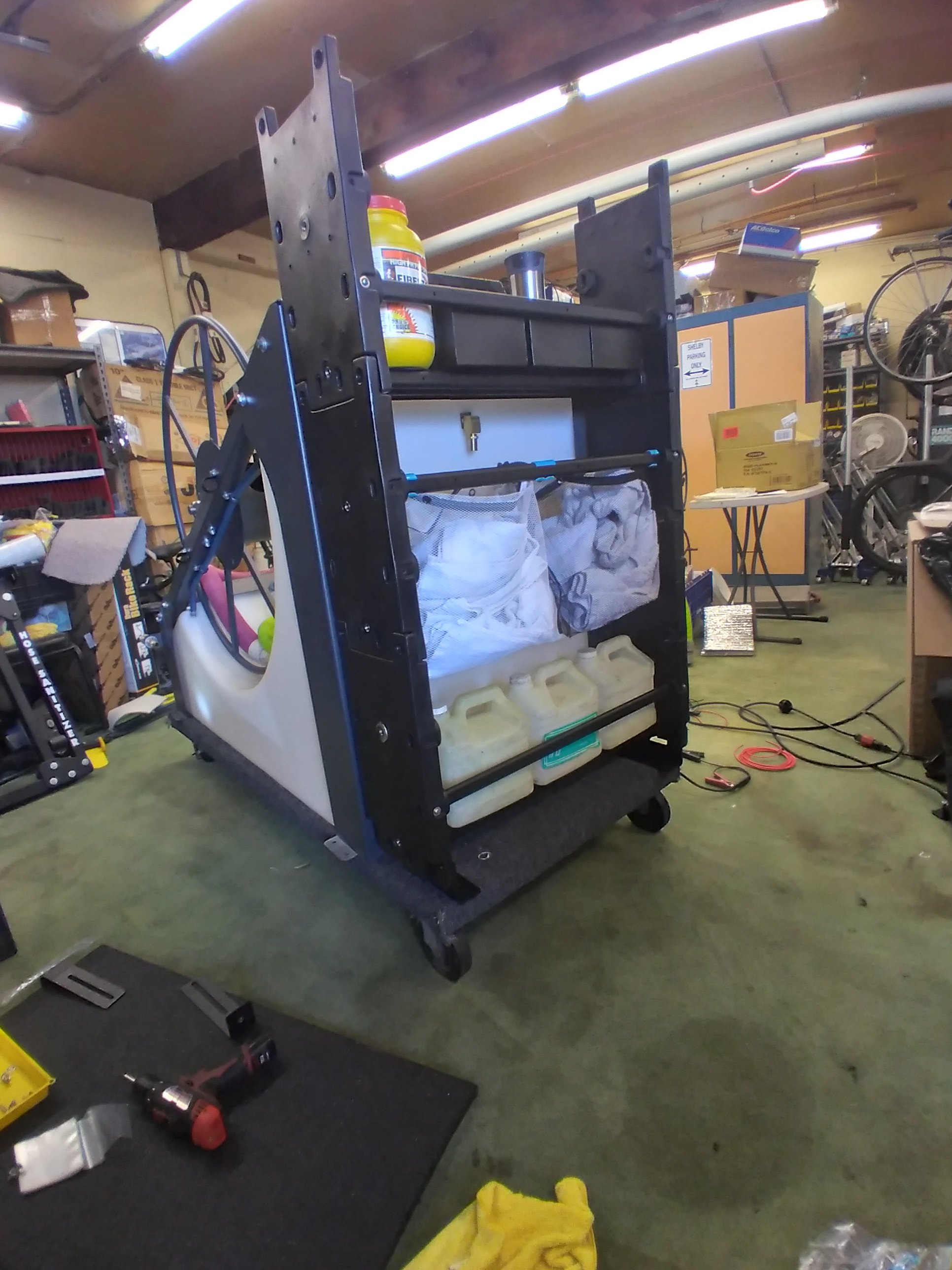

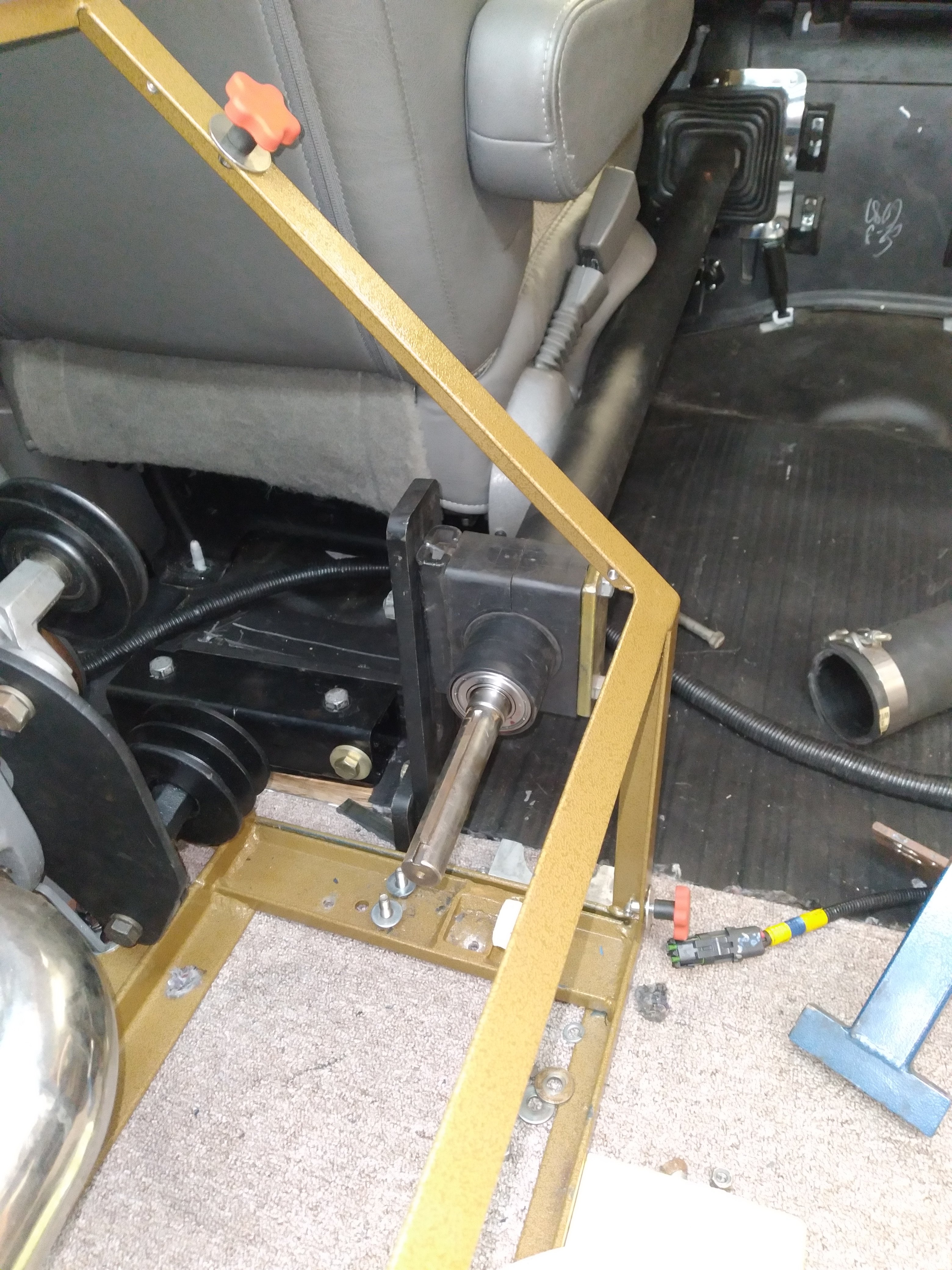

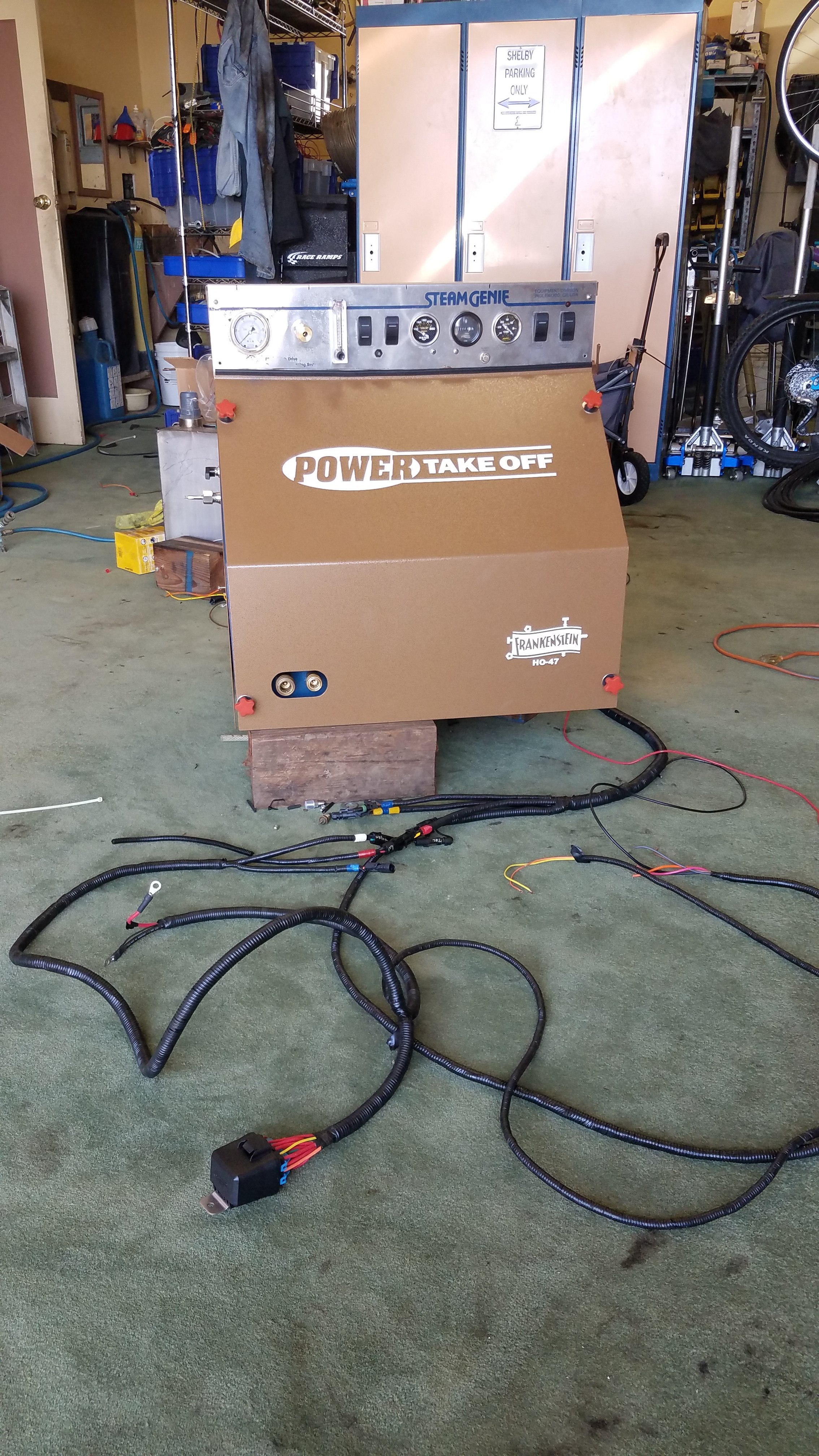

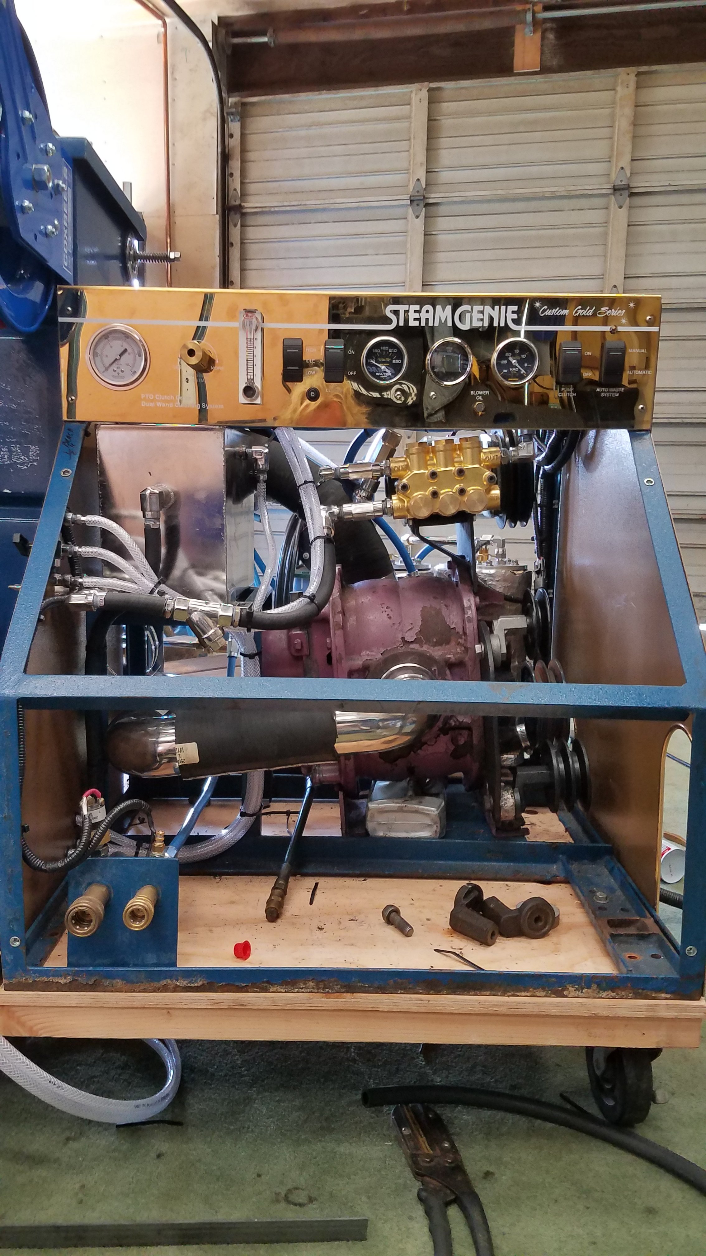

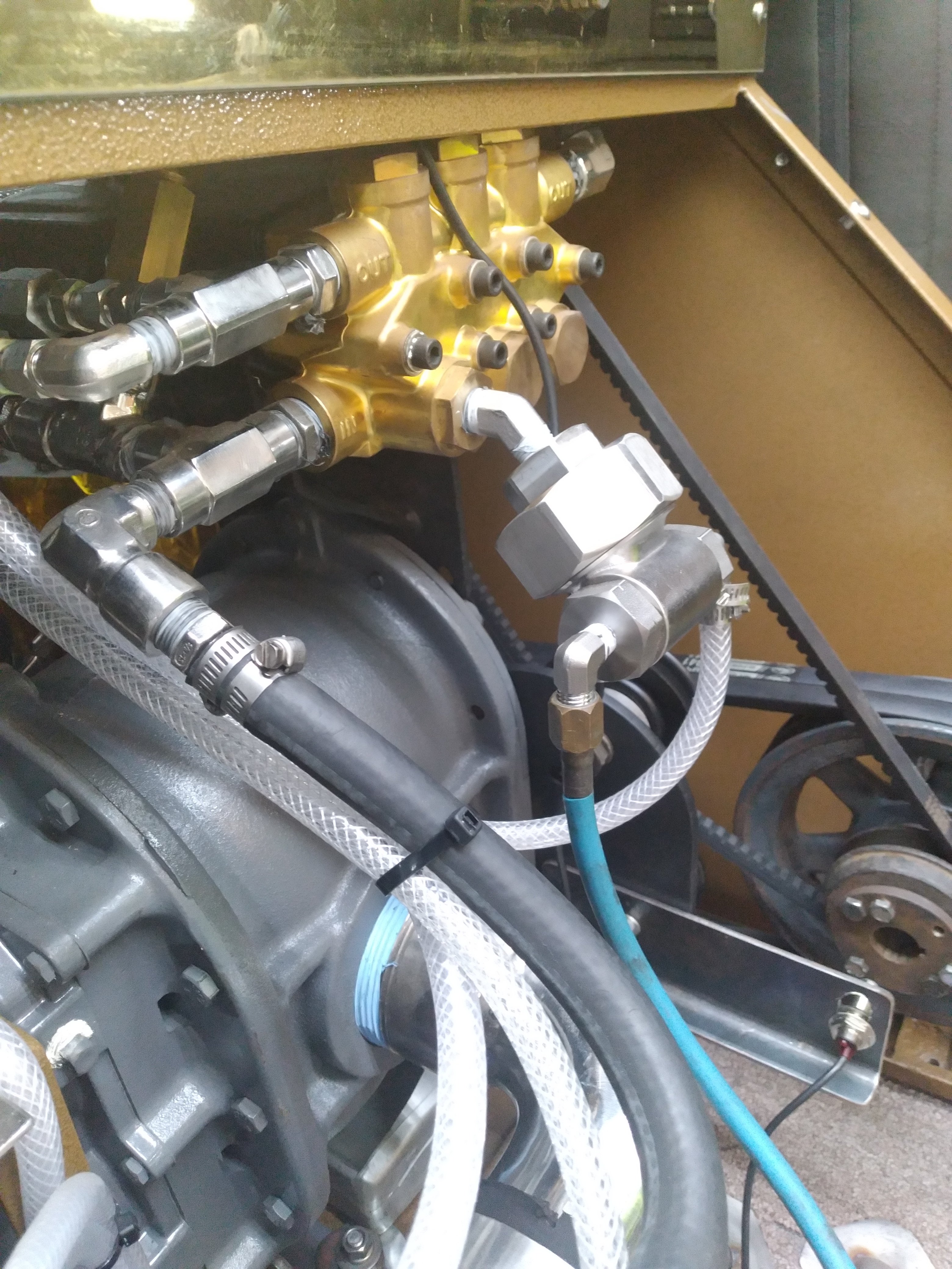

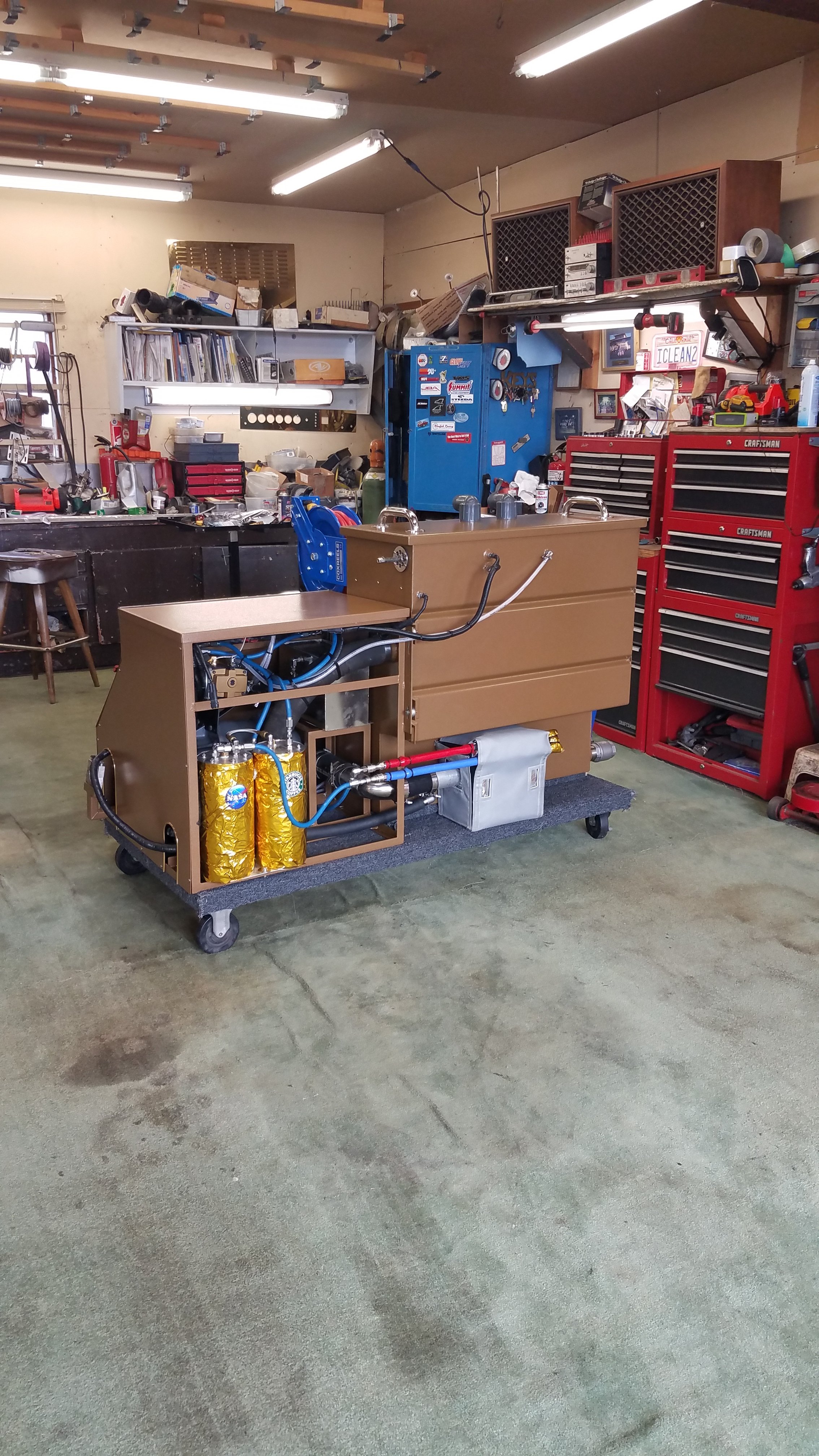

It doesn't need rebuilding it still runs fine, when i built frankinstien i wanted a new machine . Not another machine built from used parts. Properly maintained The machine i built has a life expectancy of 20 to 25 years. It is replacing a 23 year old steamgeni pto(now delegated to be a backup machine) , this machine is solid stainless steel construction, 50gallon wastetank ,machine tins and custom filter box no brass fittings all stainless. It started life as a 1998 steam geni 45 pto it has the best of the best cleanco engine mount with steamgeni drive shaft Cleanco's water to water heat exchangers with hydramaster salsa afterburner, prochem/comet waste pump ,hypro pressure pump roots 47 blower, prochem/general chemical pump, custom electrical distribution prochem waterpond with modified mytee shelf across back custom narrowed side shelving custom modified crash screens all installed in a 2020 chevy 6.0L extended van all pieces custom powdercoated no paint all in chicken feathers everything $61,000
View attachment 119766 View attachment 119767 View attachment 119768 View attachment 119769 View attachment 119770 View attachment 119771 View attachment 119772 View attachment 119773 View attachment 119774 View attachment 119775 View attachment 119776 View attachment 119777 View attachment 119778 View attachment 119779 View attachment 119780 View attachment 119781 View attachment 119782 View attachment 119783 View attachment 119784 View attachment 119785 View attachment 119786 View attachment 119787 View attachment 119788 View attachment 119789 View attachment 119790 View attachment 119791 View attachment 119792 View attachment 119793 View attachment 119794 View attachment 119795 View attachment 119796 View attachment 119797 View attachment 119798 View attachment 119799 View attachment 119800 View attachment 119802

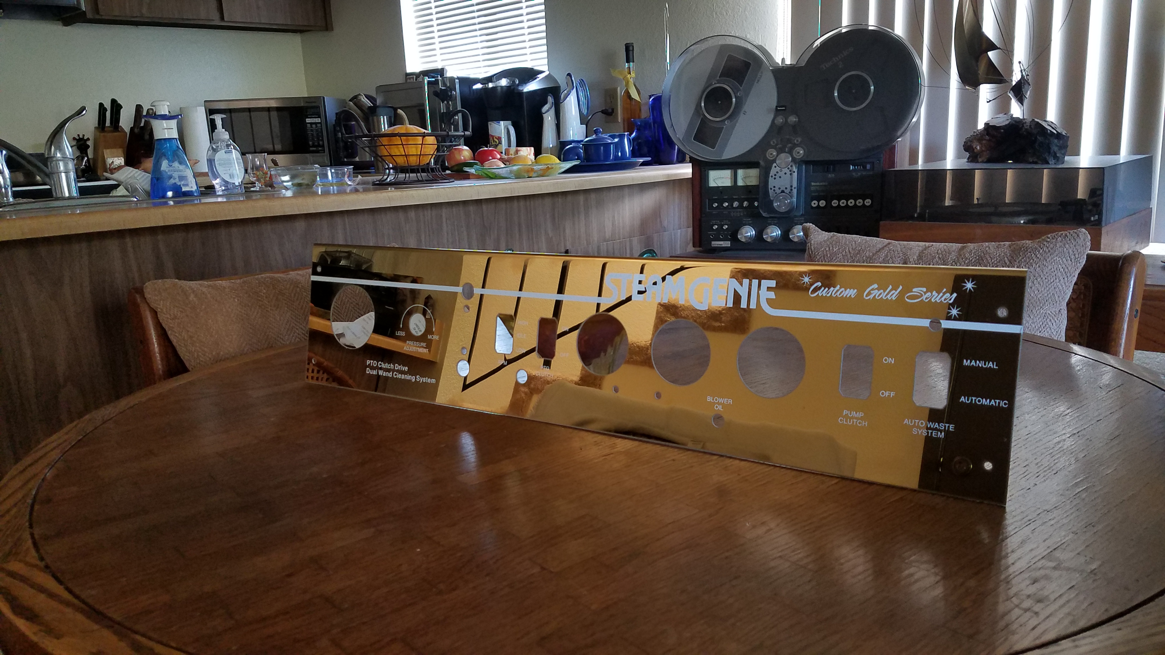

Forgot, the control panel is 24k titanium gold plated polished stainless steel sent to Nova Scotia to be lettered, they were the only company to return my emails about silkscreening on 24k gold

Probably how it should have been done in the first place.

The steamgeni pto is and was a great and highly reliable machine, but i want to do tile and grout and the heat exchangers won't handle the pressures necessary for that and thats what started this whole project, i looked into buying a new machine to do tile and grout and was very disappointed with what is out there, as it stands my 23 year old steamgeni backup machine will probably outlast anything on the market that i could buy now. It was my supplier that convinced me to build frankinstien i started building 2/19 finished the machine 10/19 started looking for a van then covid hit 2/20 bought the van 12/21 started the installation 1/22 completed it and put into service 9/22 have about 200 hours on it so far

Holy Mack! Call him Dr Ray!
nice man. Really freakin nice. Thanks for sharing.
