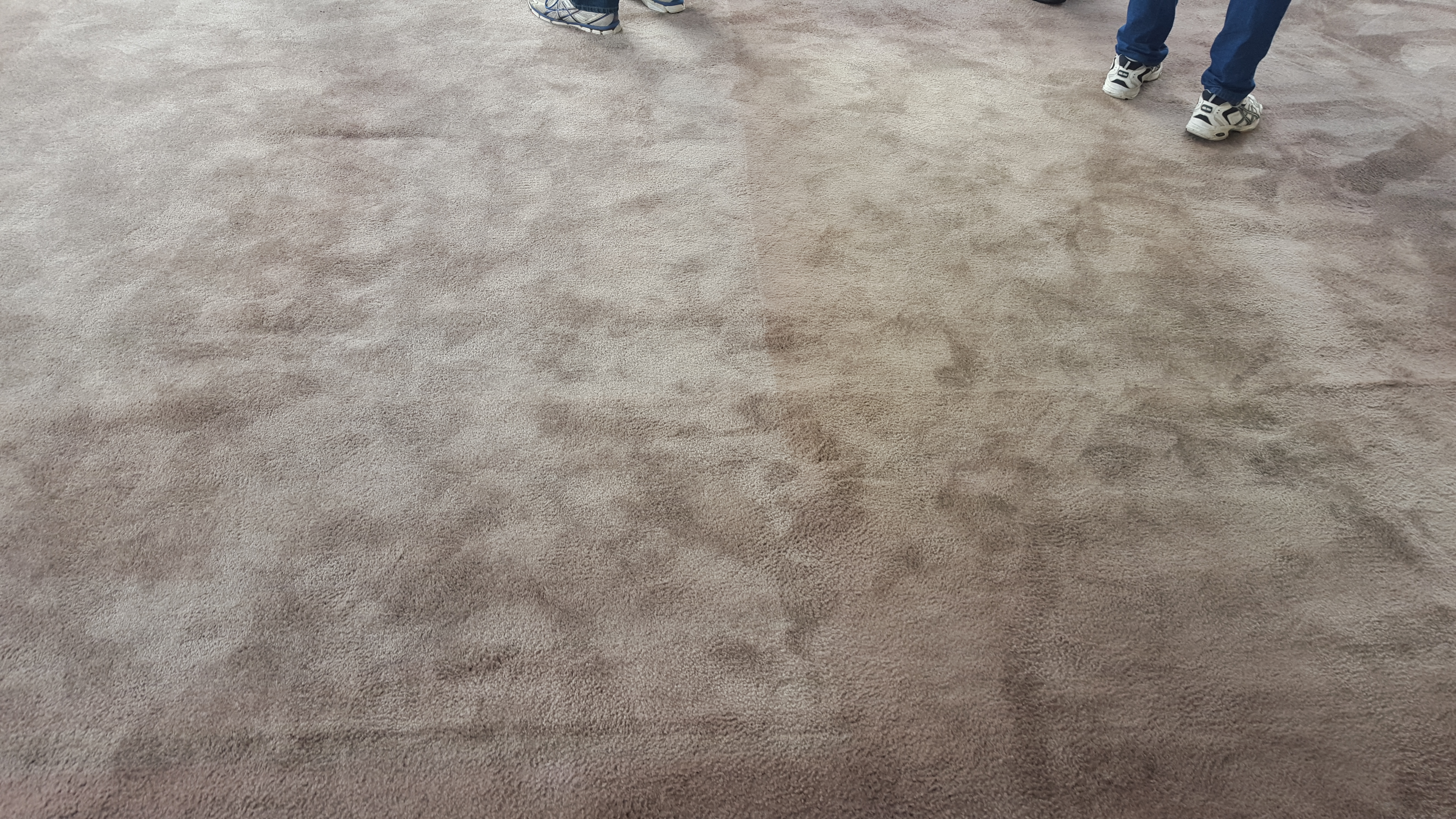

looks splotchy af in my eyes, but it could still be wet...?
Horribly uneven. Carpet dye doesn't disperse perfectly but that job looks off. It looks like the dye was put down with a 175. When I was subbing for Langenwalter we did a hotel top to bottom every January and February. I wonder how they did the carper base on the wall.
We used to do whole room carpet dyeing. The problem is, wherever there were previous "issues" with the original carpet color, the dye does not cover like painting a wall over again. The end result was sometimes splotchy.
That's why we quit doing whole room dye jobs.

Used to have a good guy here. He would bleach and spot dye until he the carpet as uniform as possible, then dye the whole room. Some of his results were fantastic.
Some were not so good, if it's the same guy that came down to Melbourne Australia five years ago.
Here his completed full room job.
