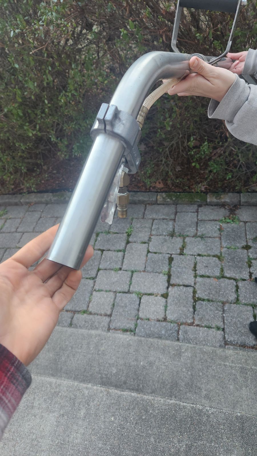

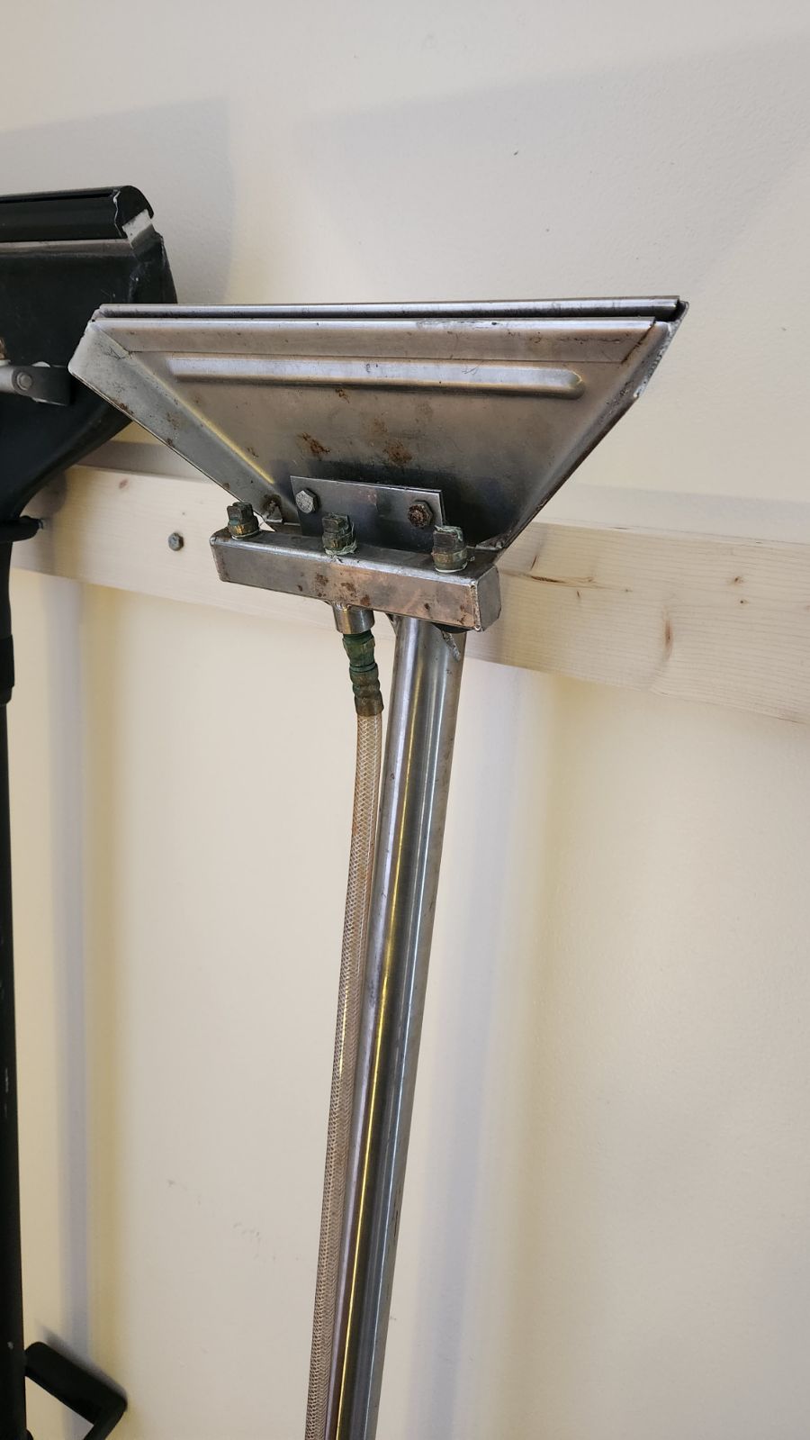

I have this PMF wand I'm wondering if I can get a glide for it. I'm not sure what model it is, can't see any marks aside from PMF on the valve. 3 jets and 12 inches wide. What do you guys think? I keep hearing about Green Glides something or other, are they like the world's most excellent glide or something?

Can you show me a picture of the front of the wand from head to toe?
I don't know who thought it would be good to put three Jets across the 12-in head, you're probably going to get a lot of overspray...

howdy Bryce
I realize you're fresh in the biz and I'm sure money is tight
but here's a thought you should consider.
by the looks of the supply line, looks to me that wand is only good for a low pressure portable.
Rather than spend $200 on a glide for it, spend $500* and buy a new wand from Mike that comes with a glide.
His wand will be infinitely better as well as being capable of hi-pressure portables and/or TM's when you upgrade down the road from now
*I'm "guessing" he can fit you in a new wand for about that much?

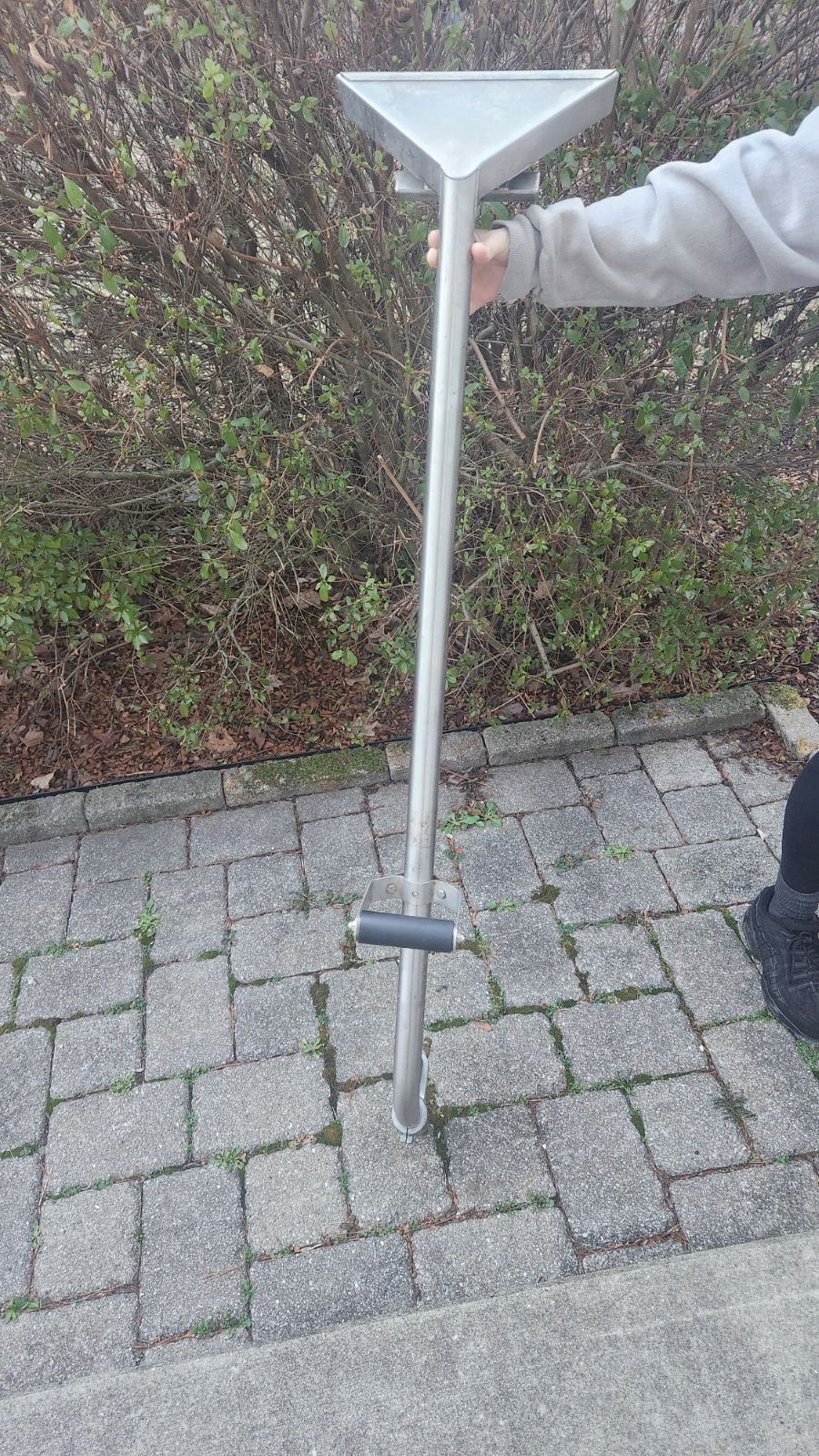

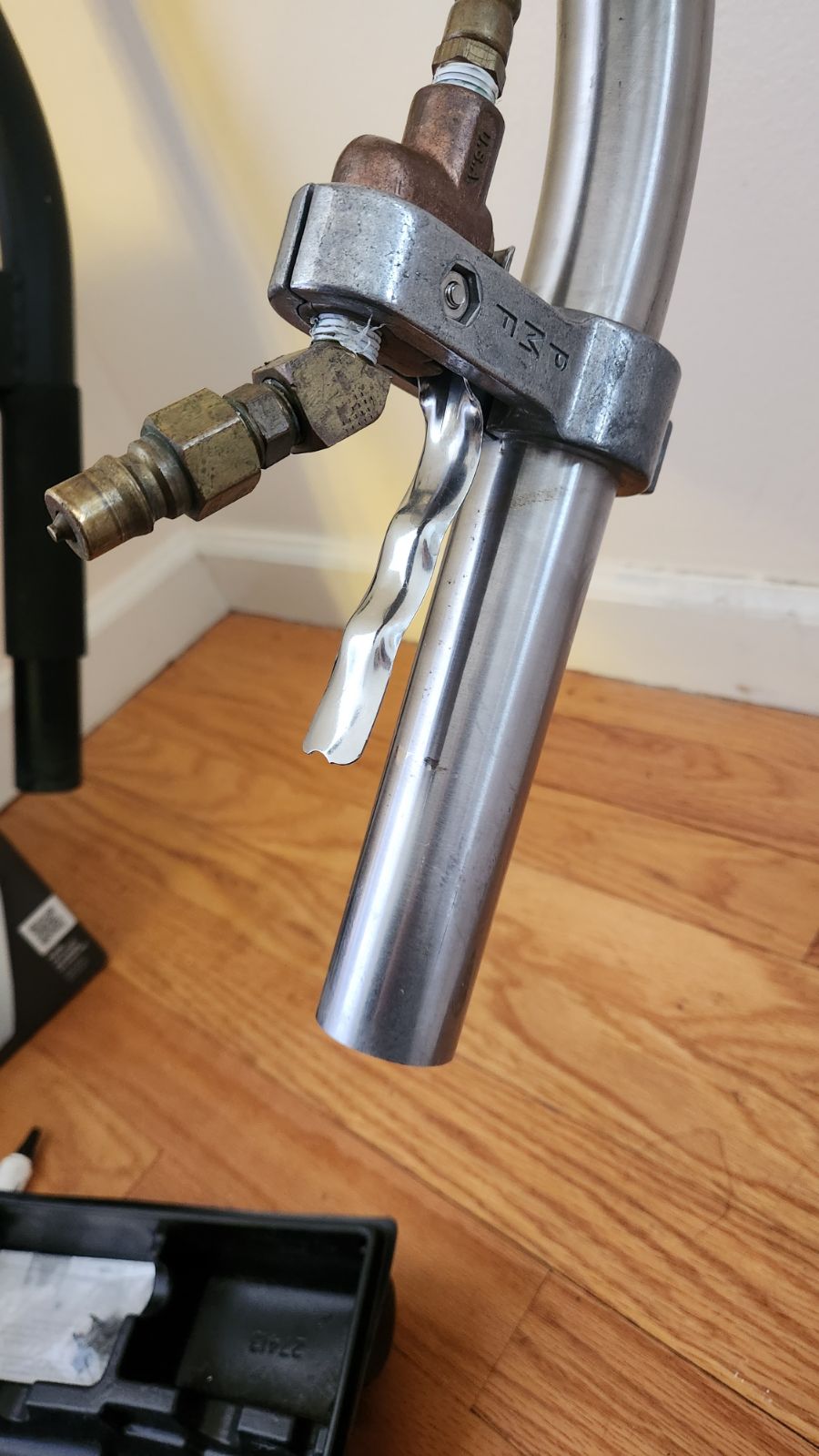

Howdy Dolly LLama and Mikey. Dolly, I bought it as a backup for my Hydramaster Evolution wand since it was fairly inexpensive on Marketplace. That's a good point it has a low pressure hose on it. It sort of looks like a makeshift thing that was done afterwards by the previous owner. It has 1/4" 8002 jets on it, are those more high pressure oriented? Good call about not investing in a glide for it if it's a totally inappropriate setup.
Mikey, I was thinking about getting some of the Wander's 1/8" v jets for it, do you think trying a narrower angled jet like a 65 on the outer jets might help dial it? Also if I use the same intersection the jets are on I think I'd have to use a fitting to adapt the 1/4" to 1/8" for the Wander jets and it would bring them a little closer to the floor. Here are the pics

PMF tools are a joke. I strongly suggest getting that very affordable westpak530 from mike. I've used several of the pmf and westpak wands and there is such a noticeable difference when you're on a tight budget and can't afford the Cadillac swivel wands or even the overpriced sapphire wands. Don't spend any more time messing with that outdated anchor.

I got an inappropriate low pressure wand setup and it's generally a pos. That's humbling Yea it makes sense for around $500 to do it right with the Westpak 530. Seems like a great deal considering how effective it is. I'll grab one of those at the Fest. Thanks guys!
