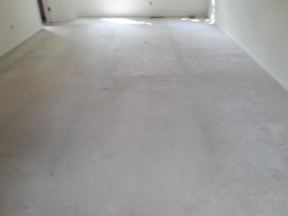

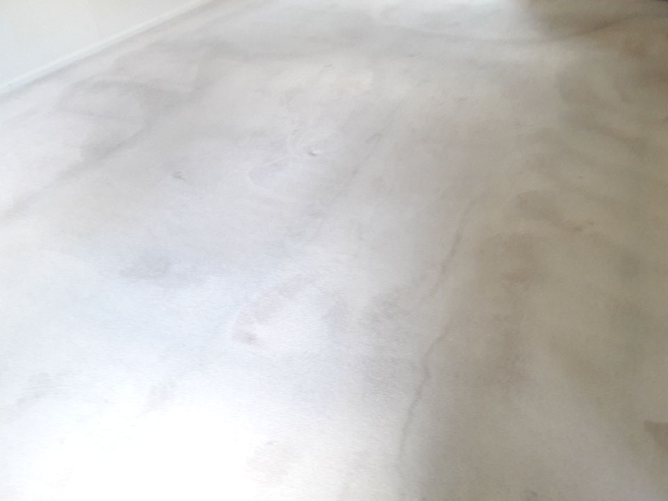

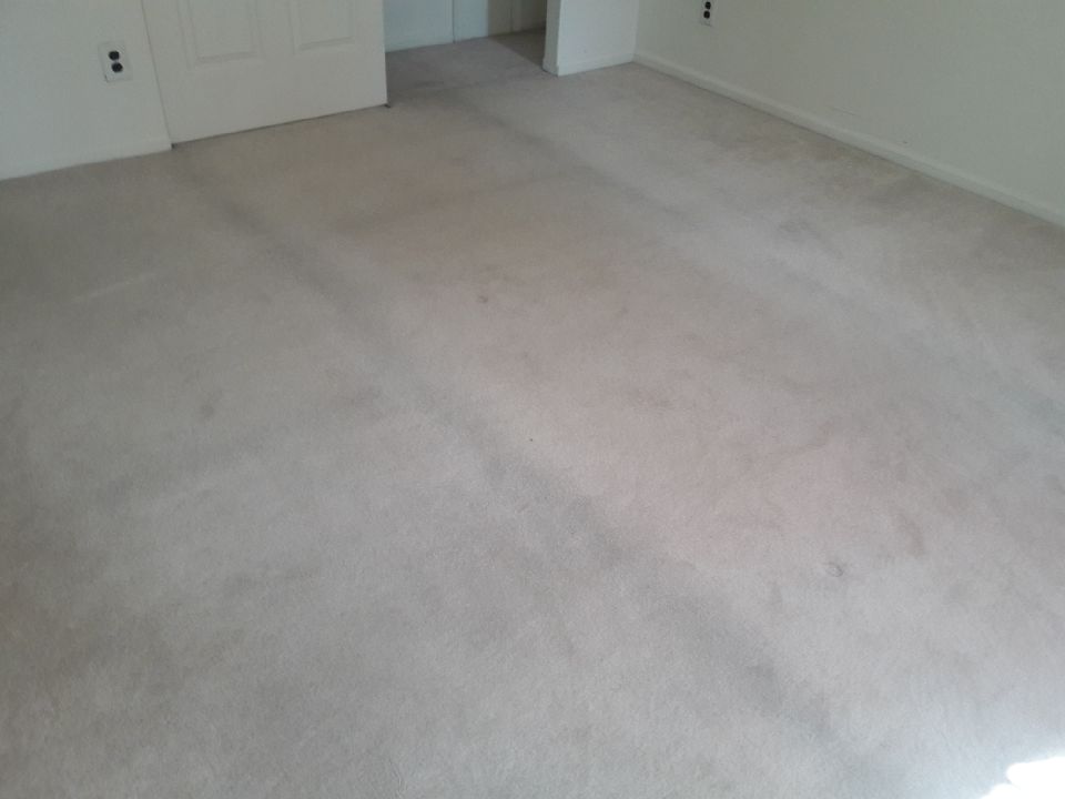

Can anyone guess this one out?
icleancarpetz
Mar 7, 2015
1,713
Rafael Samson
i sure can’t. Scratching my dome as to how this bedroom got a parking lot look with filtration soil. Empty house this morning. New owners just bought house and dont know either.

We all understand how it happens
His question is more directed at the unusual pattern
what's under the room?
Main floor?
Basement?
Slab?
and how old is the house?
and was that the only room like it?
we don't know what the previous folks had/did there .
hell, for all we know, it's tape residue from a checkerboard hopscotch game .
Or it's used rug that was folded wrong and sat for years in a dirty/disty place
The the first pic though, sure looks likes the pattern a subfloor would be laid
Jun 20, 2016
6,564
Jeff T
Filtration lines through subfloor just as Lee pointed out.... if you look at the size of the pattern, it’s 4’ by 8’.... exactly the size of a sheet of plywood...

Negative air, from a furnace RETURN line between the floor beams pulled unfiltered air thru gaps in the plywood floor, leaving filtration line in the middle of the floor

Grab a corner pull it back see if that's where the seams in the plywood are. Lee wins....
