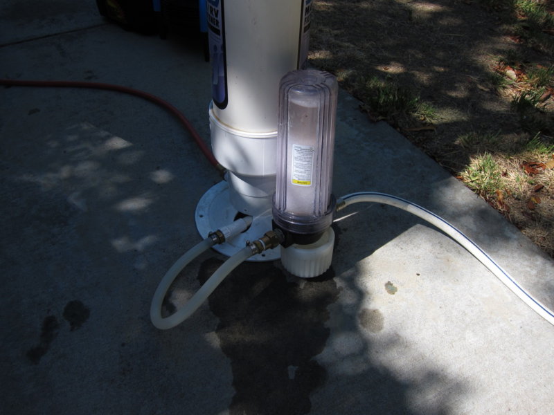

I know from a few posts on the web there are a couple different options for on-board water softeners. This is one I've seen and used around boat docks. I purchased it 10+ years ago for a little less then $300. I conservatively calculate over 500k gallons of water through mine and never a problem. Around 2,500 to 3,500 gallons I recharge with rock salt from the hardware store. Takes about 25 min to recharge. A drop of soap in a mason jar is an easy test to tell when it needs charging.
Left it out of my truck when I installed new machine last Dec. Found another corner for it to live. As I said there are others that are marketed to us cleaners, I happen to have success with this one.

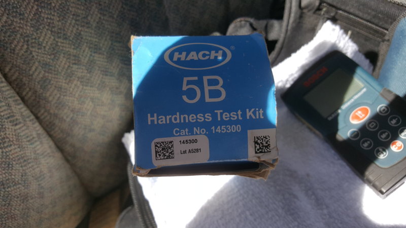

Never heard of the drop of soap test. Please tell me about it.
Blue Monarch
2,935
Dirk Wingrove
Here's what I use to test. Love this kit....
