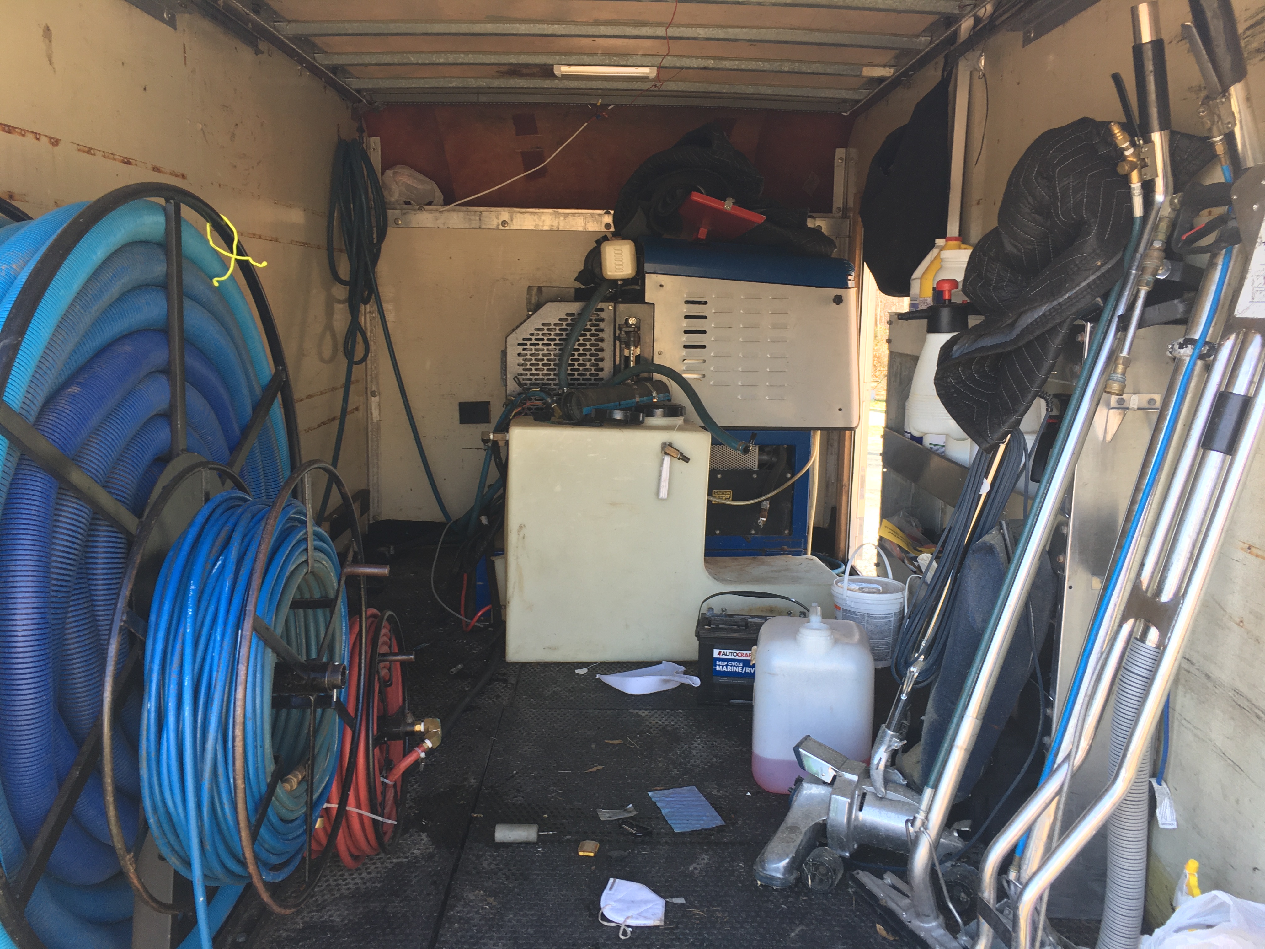

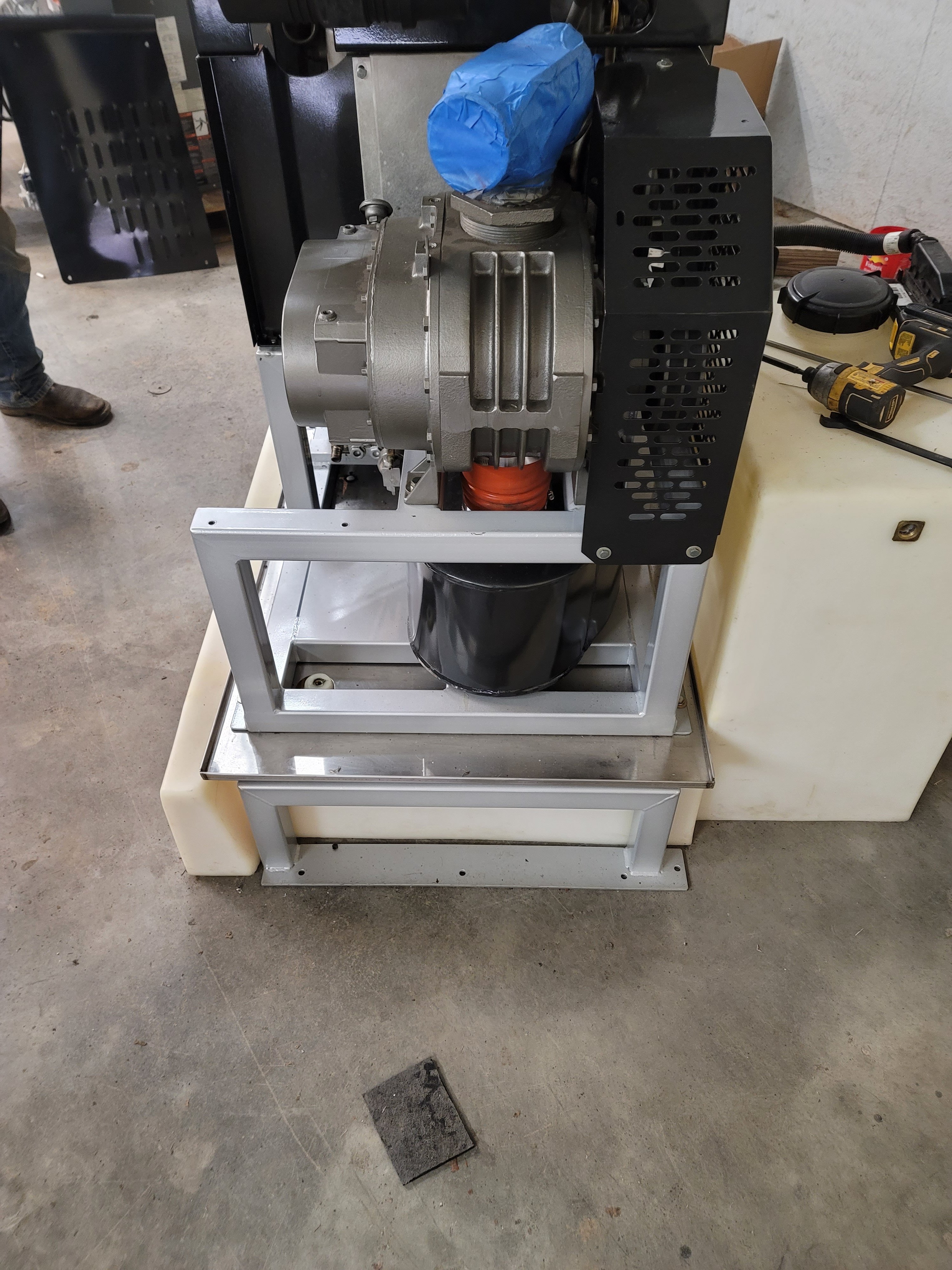

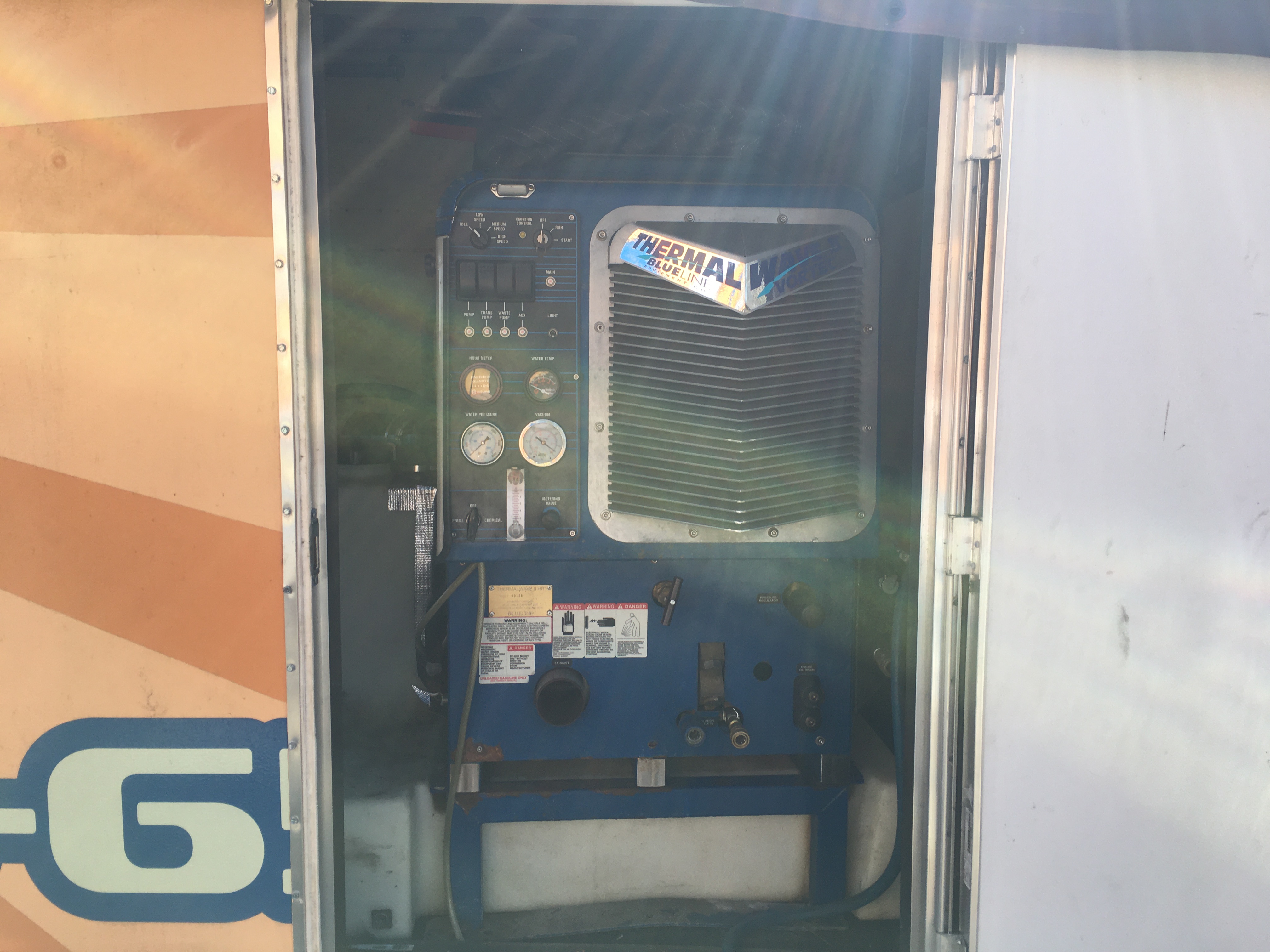

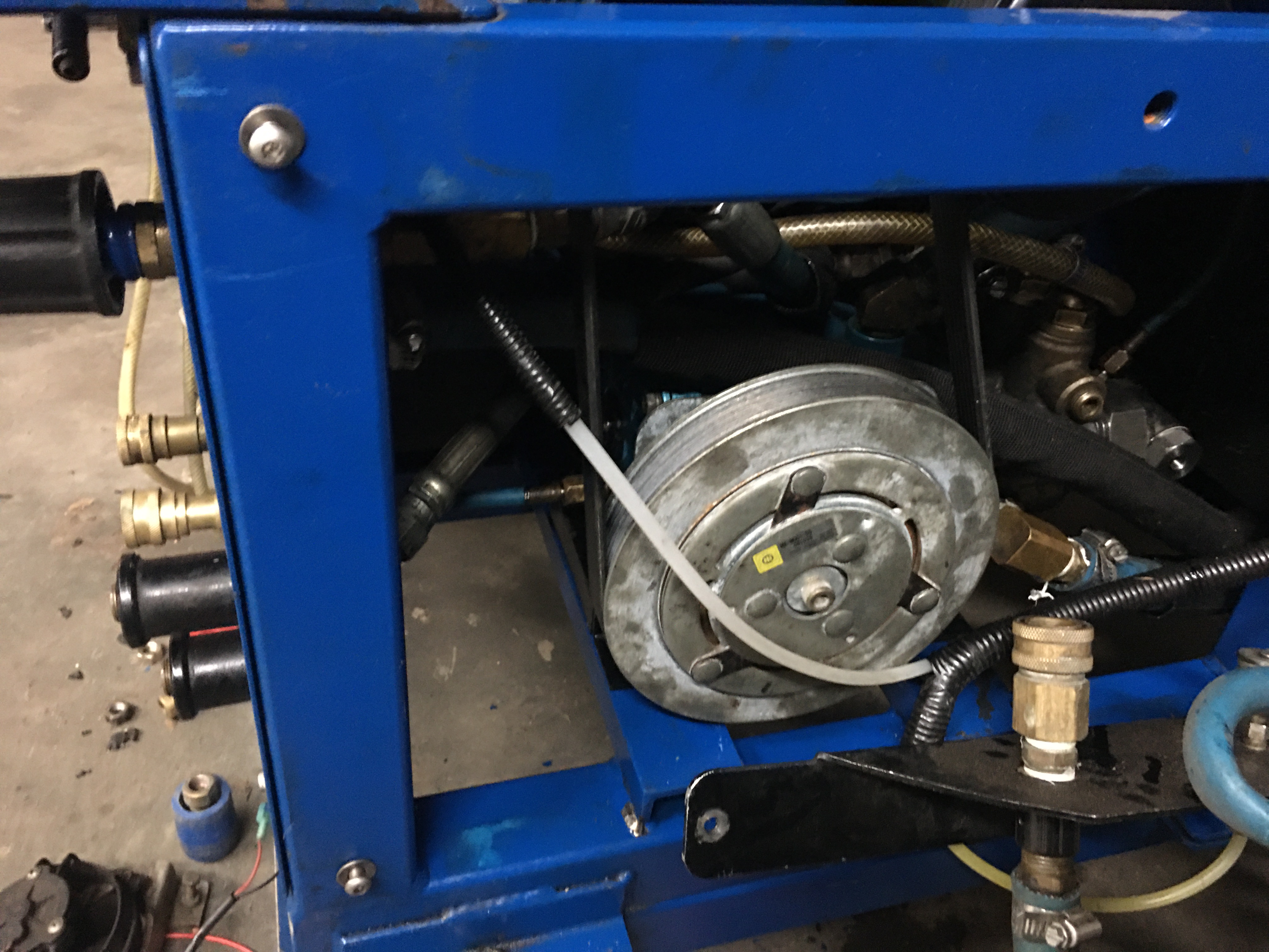

I’m taking it to the forklift later this week to move it. Rubber mats underneath are getting pulled up.
The waste tank was behind it but I think I’m gonna move it to the left side of the machine for better mounting space and ease of access to the rear and right side of the machine.
The van needs a power steering fluid reservoir, a tuneup, and a new rear door
As for the tm, the water pump needs tlc, and the 185f thermal relief valve needs replaced. 🤞. Once I get it completed, we’ll see what other issues it might have

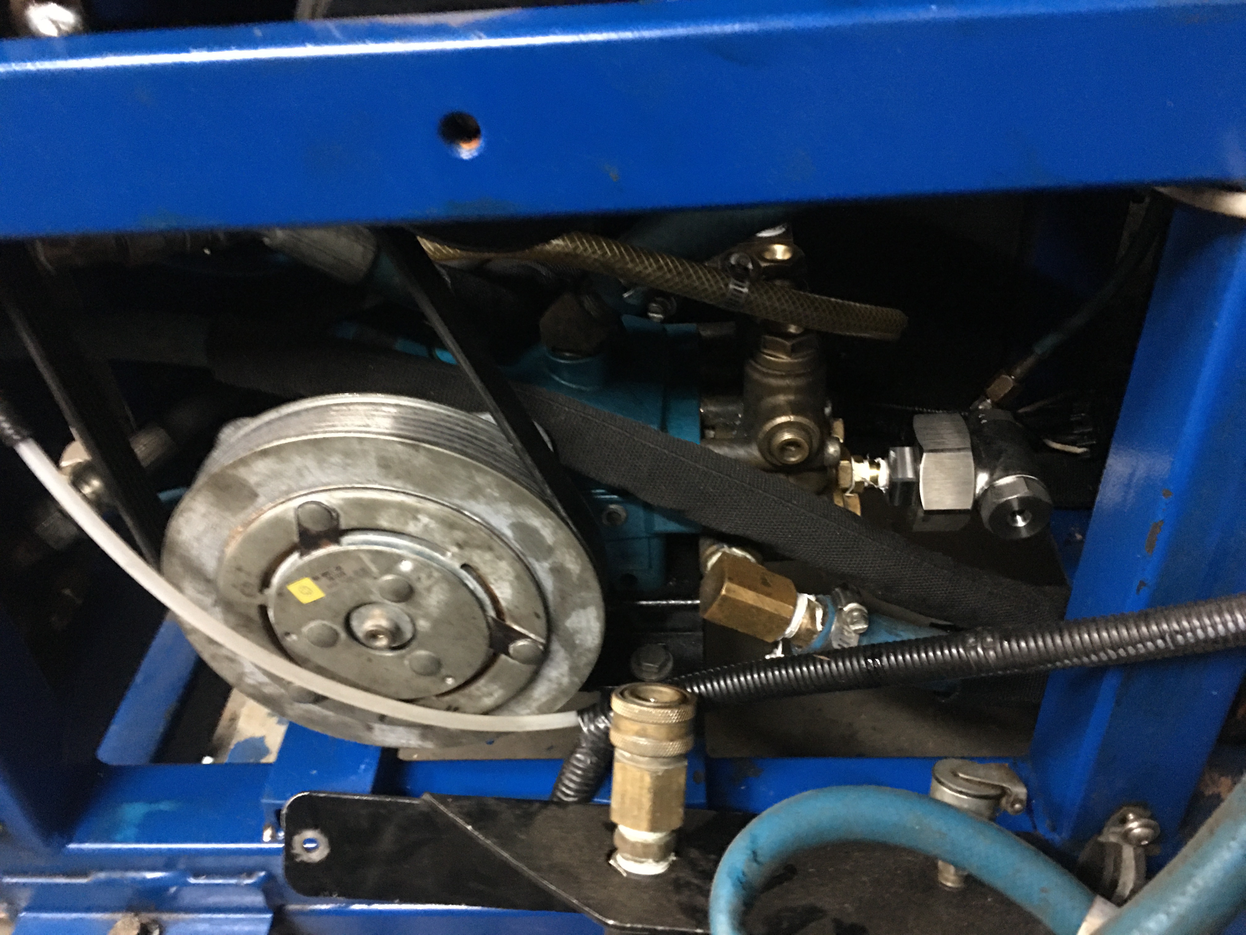

I worked on it this evening and found the problem. That sound is coming from an unevenly adjusted belt tensioner. I went to retighten the belt a couple weeks after the new one was put on and I forgot to loosen the pulley on the back end so it would move. It sounds like a new machine now
An uneven belt tensioner makes the engine sound like it's grinding.

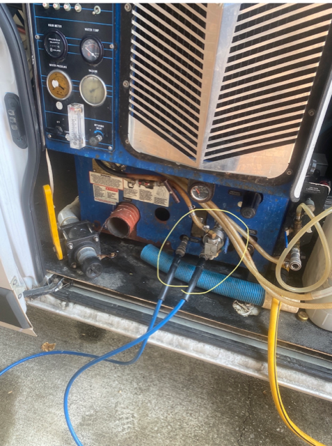

i also moved my chem pump to the front of the machine to better access the diaphragm.

do yourself a favor and run a high 1/4 pressure hose to the front and mount your chem pump there with a shut off so you can turn it off for tile cleaning . its a bitch to swap the diaphragm in that position.

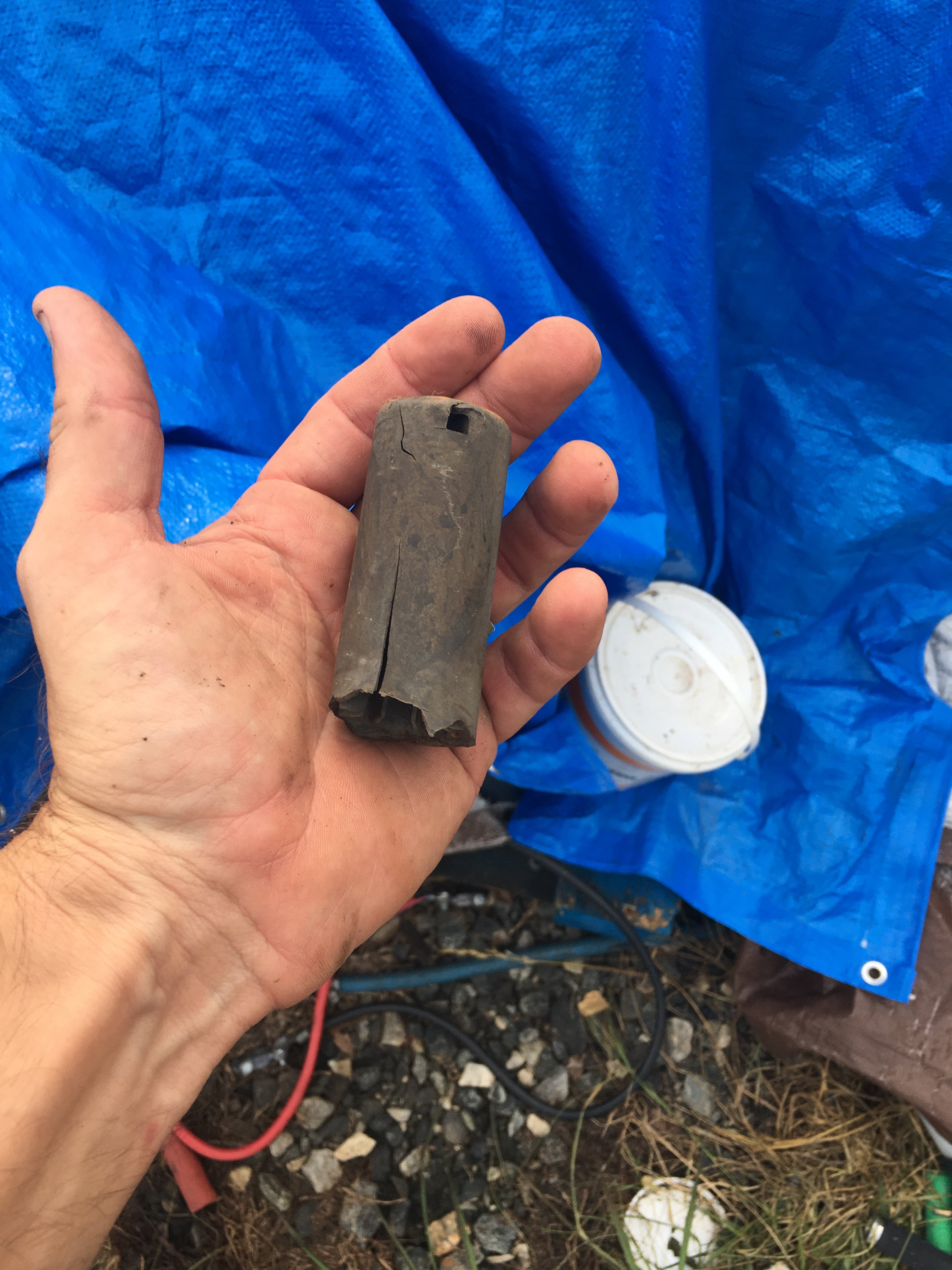

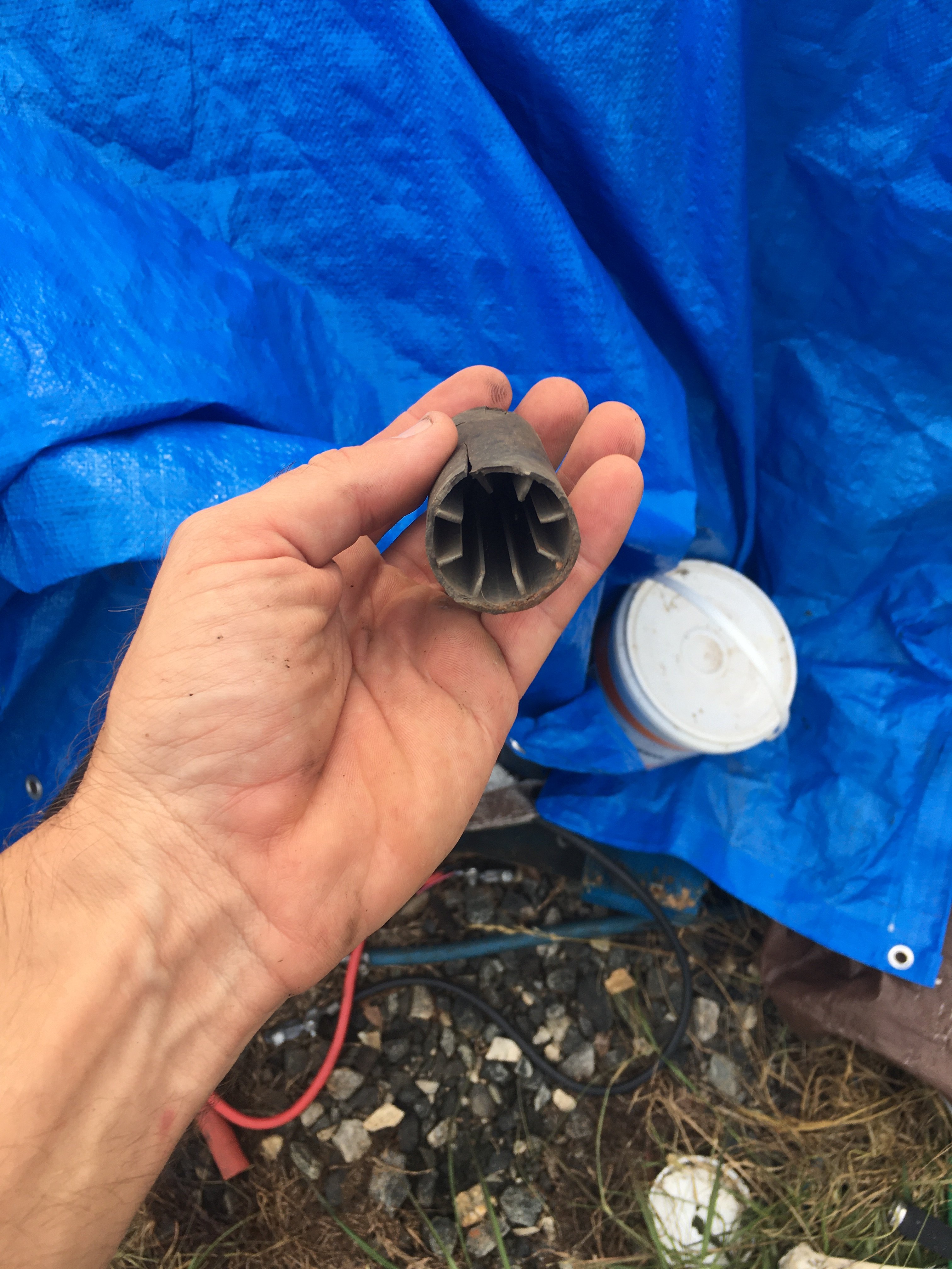

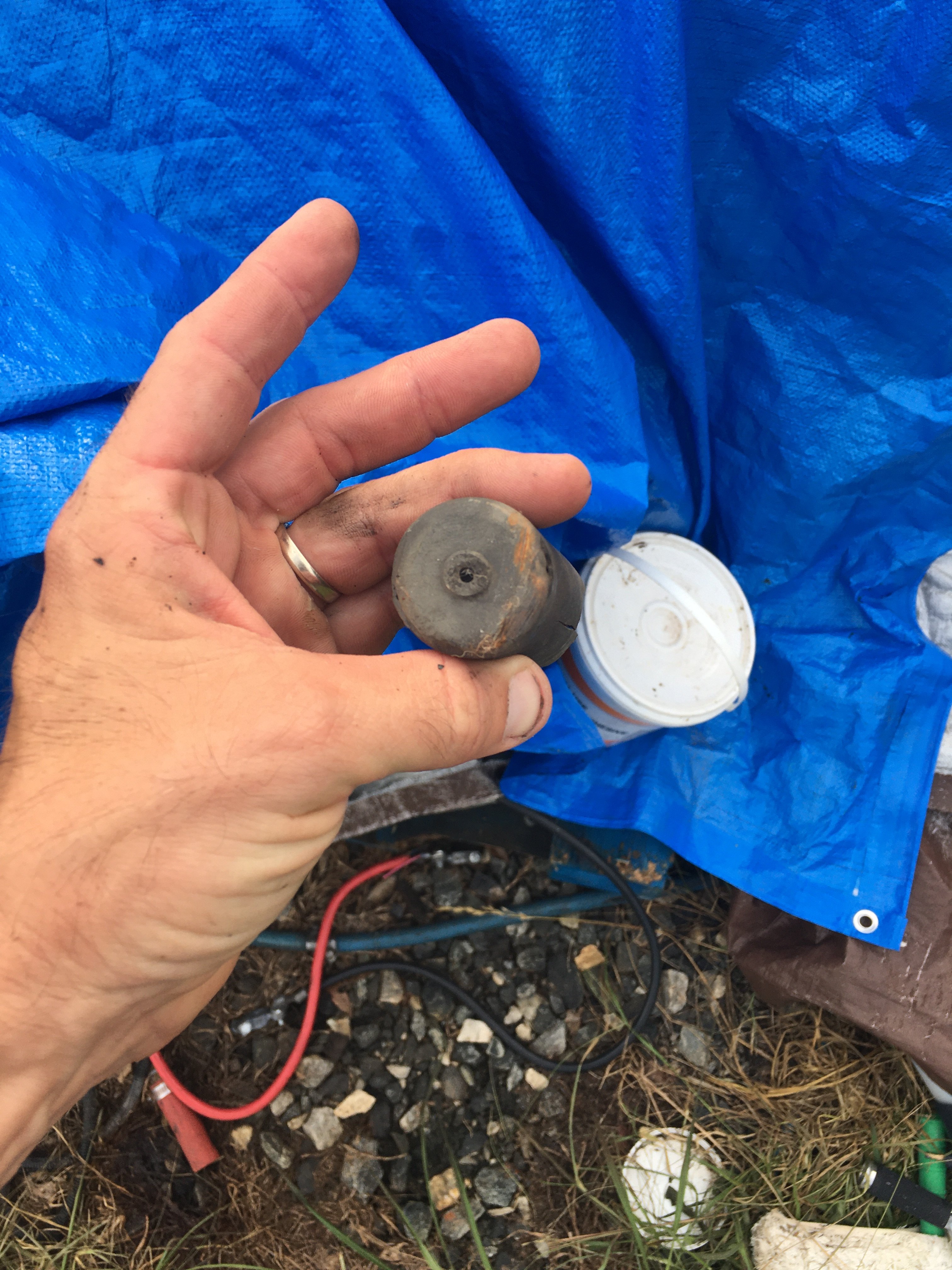

and on my spare parts machine, I discovered this thing sitting in the silencer when I removed the blower a few weeks ago. There's no way it would've survived in one piece if it was sucked in through the blower. It had to be purposely put in there to do nothing but rattle. If the truck mount won't stop rattling, just go buy another one.
