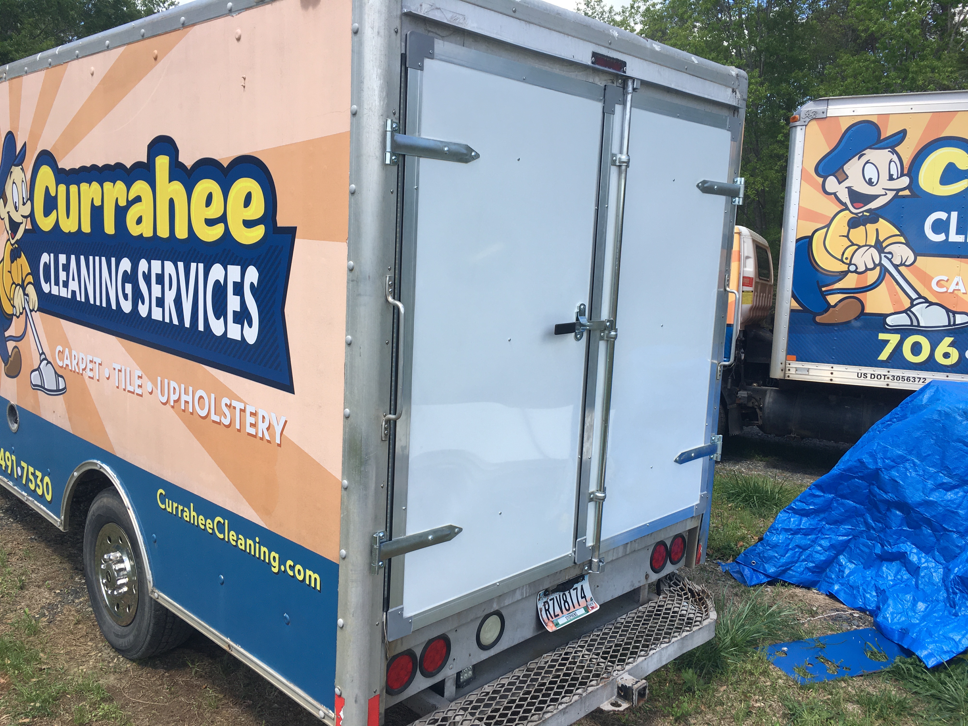

I think I found the cause of the fumes coming in the truck.
Got a new set of doors to replace the rotten roll up door 🤓🥳 on this project.
Next is replacing valve cover gaskets on the van engine.
those doors did help stop the chimney effect from sucking in the exhaust fumes. But I forgot to cover that hole that the door latch for the old roll up doors on the floor. After using some duct tape, the fumes are no longer detected.
