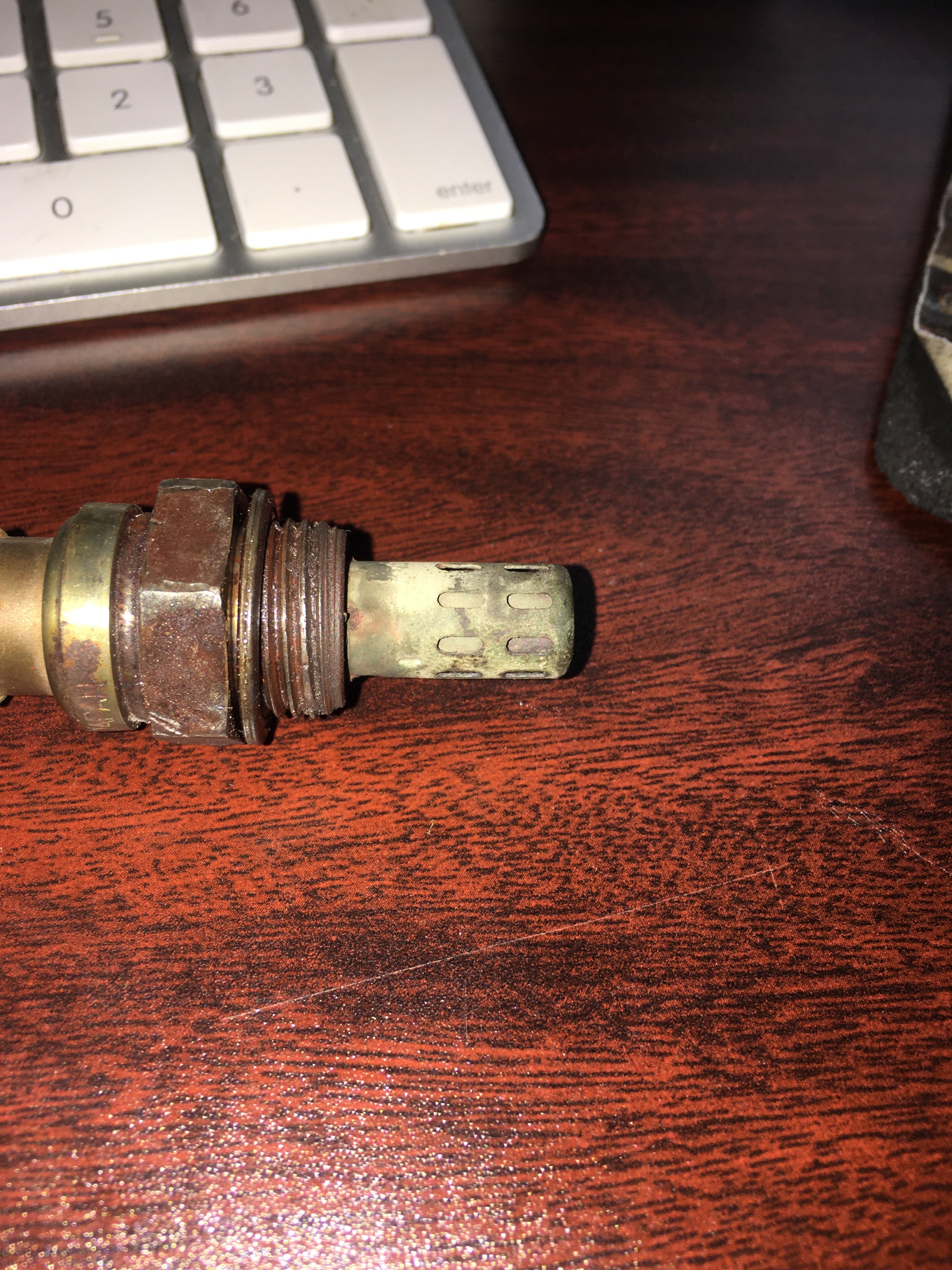

Bad head gasket symptoms
  • White smoke coming from the tailpipe.
  • BUBBLING IN THE RADIATOR AND COOLANT RESERVOIR.
  • unexplained coolant loss with no leaks.
  • Milky white coloration in the oil.
  • Engine overheating.
The engine overheating might be the only thing on that list. I measured the temp with a laser reader and the only hot spot was under the headers that read up to 285F. But...on the other side of the block it read 185ish-maybe200F. So I hope it was just from the overheated exhaust pipes causing it to read that high of a temp on the surface of the metal. Literally everywhere else on the engine was a good temp. During this headache, I constantly checked engine temp.
Another VERY GOOD REASON our lovely manufacturers need to put more gauges on these machines. Engine temp being one of them
that o2 sensor, at least from the pic, looks like coolant has been entering the combustion chamber....
head gasket is probably the best-case scenario for that. I guess it could have been replaced before and the O2 sensor not
