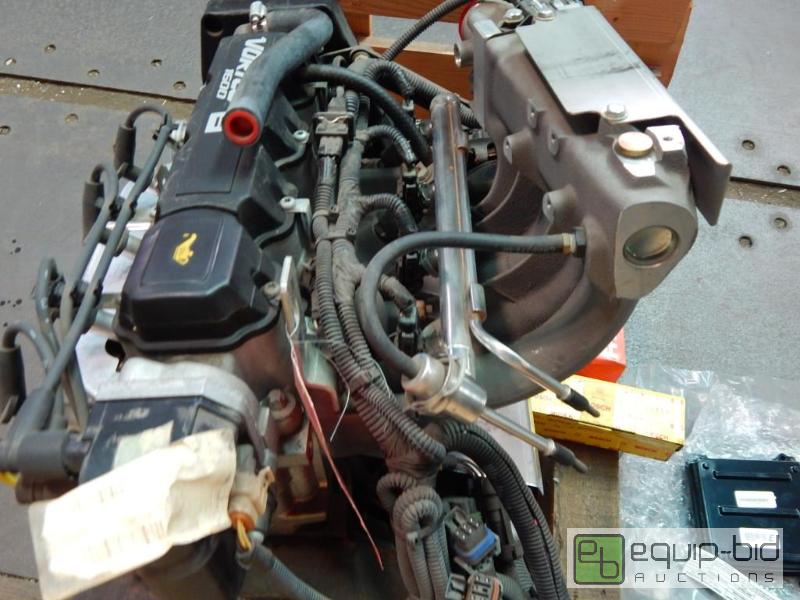

That connector close to the floor is where I’m reading 35psi right before the injectors.
Justin told me 55. And the chevy Aveo engine has the same pressure of 55ish also

It’s the MAP sensor I replaced yesterday. It’s called a FPR in the manual but is a MAP at the auto parts store.

The voltage readings came out normal on the sensor on the fuel rail. I don’t see a regulator on the injectors.
And there is no Shrader on the fuel rail assembly
