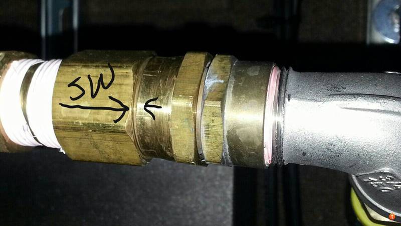

I am just not seeing a swivel on there....can you show me where

It isn't a Live Swivel, it is a static swivel that once tightened no longer swivels. Mine is just a heavier duty version than a Hardware store version.
I don't have anymore pics available of that specific part right now. Sorry
Took one, Not sure how much it will help though since the swivel isn't easily seen in pics.

that picture does not look nothing like this........
all I am seeing here is a nipple....a ball valve....and another nipple and the fitting....The fitting is what I was interested in but could not figure out how you are hooking up a hose to it because it does not swivel......
apparently......your water softener is plumbed to the fitting that goes straight to the float valve on the tank and it is feed off a fresh hose reel...and the fitting that I like has no purpose........

It actually does swivel I promise or I couldn't hook it up. I have no float valve at all because it never worked correctly from day one & AT wasn't able to fix it for mine.
Without the fitting you are asking about I can't fill tank
From Tank out fittings in order are:
1. Tank Top
2. Tank Top Stainless Plate
3. 3/4" NPT Female x 3/4" NPT Female 90 degree Stainless. Not 100% on how it is connected to plate but not a big deal for this info.
4. 3/4" NPT Male Presto-Lok fitting
5. 3/4" Presto-Lok hose long enough to reach the welded Stainless 3/4" x 3/4" NPT Female coupling
6. 3/4" NPT Male Presto-Lok fitting
7. Welded in place 3/4" x 3/4" NPT Stainless Female Coupling
8. 3/4" NPT Male Nipple
9. 3/4" Brass Ball Valve.
10. 3/4" NPT Male Brass nipple
11. 3/4" NPT Female x 3/4" Female Garden Hose Swivel (I believe this is the part in question?)
This is the part that is easily removed in case I need to bypass the Softener allowing direct garden hose connection to be made.
12. 3/4" Male Garden Hose x 3/4" NPT Female
13. 3/4" NPT Male x 3/4" NPT Female Stainless Ninety
14. 3/4" NPT Presto-Lok Hose end fitting
15. 3/4" Presto-Lok Hose to Softener outlet
16. 3/4" Presto-Lok hose assembly not sure all parts
17. 1/2" Reducer
18. 1/2" NPT Live Swivel attached to Hose Reel.
Hope this clarify s & helps.

The pic you were showing looks threaded.....but what ever......
so now that we went threw all that...........where do you get them......
do you have to loosen it up before it can swivel.........

I got the heavy duty one to replace the old one at my local Parker Distributor but Im sure you could find them at NorthernTool, HomeDepot, Lowes, local well stocked Hardware Store, any place that sells Pressure Washer accesories, WinTrax etc etc etc......
Sorry we just wern't thinking on same terms I guess. Also I couldn't get the swivel to show in pic very well which is why I used two arrows to show you where it swiveled.
http://www.amazon.com/Gilmour-7FPS7FH-Double-Female-Connector/dp/B000FK239Q/ref=sr_1_9?ie=UTF8&qid=1390947240&sr=8-9&keywords=3%2F4%22+garden+hose+swivel
http://www.ebay.com/itm/NIB-53036-O...073?pt=LH_DefaultDomain_0&hash=item460f846ae1

Thanks....just by looking at it...who would of thought it would of swiveled.....handy little part to have for a hose reel idea I have............
I would have because I have used this type of fitting for over 20 yrs in one way or another. I told you I wasn't kidding LOL.
If you look at my previous post I also found a couple of links for you to get one online. Now be-careful because all these types of fittings are not made equal which Im sure you already realize this.
