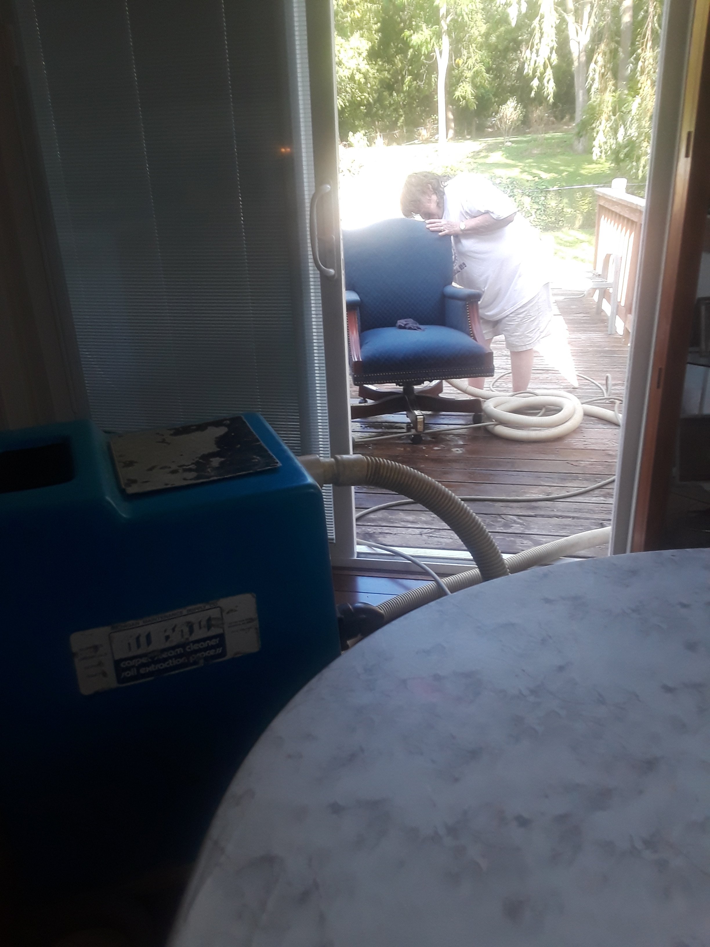

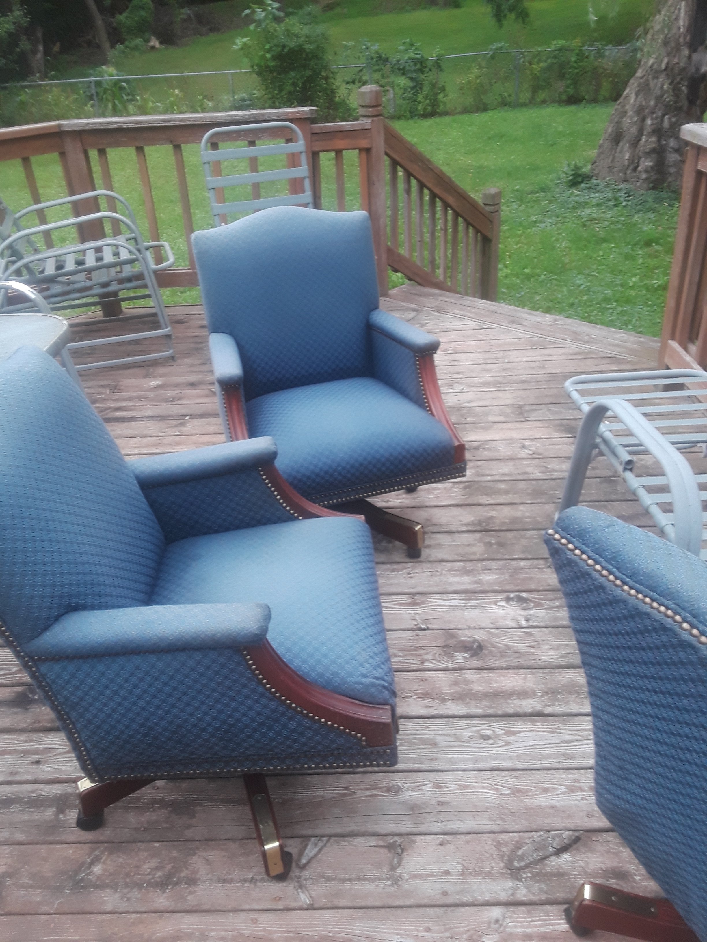

Art Kelly gave me this: I have no idea
What it is but it does a great job on the hen chairs...
