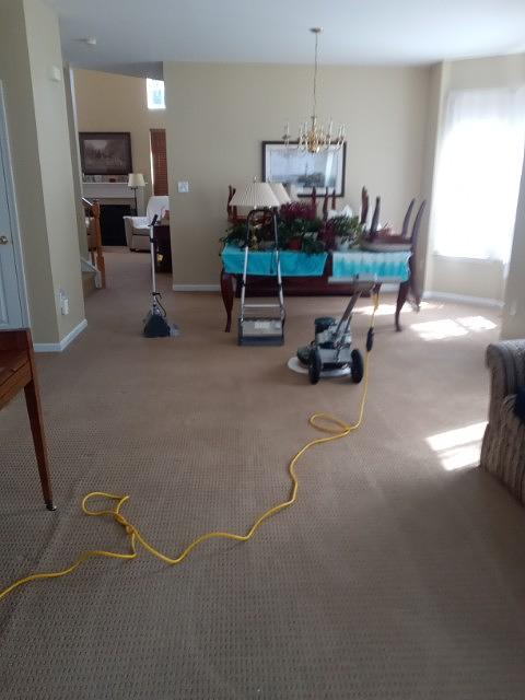

I have a Phoenix but only use it for Commercial. I only use Microfiber Bonnets for Commercial. I scrub with a Fiber Pad first. If needed
My favorite Encap for Commercial is Excellent Supply Releasit DS2
I have a 13'' 175-300 Hawk. It does a good job but I prefer OP's. It must be carried up and down stairs and rotaries fling crap all over baseboards furniture tile
I never liked Green Stripe Bonnets. I guess they would be ok to scrub with first but a soft brush does a much better job at scrubbing
I only use no odor Presprays for nice Residential. I use a Worx Hydroshot to Prespray. Prespray gets into the air and I have had some complaints. If your using Phoenix the jets are only a few inches from the carpet so that's not a problem
I used Procyon Extreme a few times. It did a good job and has no odor
My favorite Residential Presprays are Carpet Details and Bonnet Pro NanoMAXX. Both have no odor
I use NanoMAXX at 2-3 oz and add some Peroxide. If needed
Carpet Details 4-6 oz
Unoccupied Homes and Rentals I don't worry about odor. So I use whatever Prespray I want
If I'm in a occupied Home with trashed carpet I warn the customer about some odor from Prespray and use what I need to get Carpet clean
I've tried most of the VLM Presprays out there except for Saigers and Encapstore products
Never heard of StainResist
I use a CRB and Trinity Odyssey for most of my Residential
I also have a Orbot Vibe TL for large Residential
Residential I scrub with a CRB first before extracting with a OP and Cotton or Microfiber Bonnets

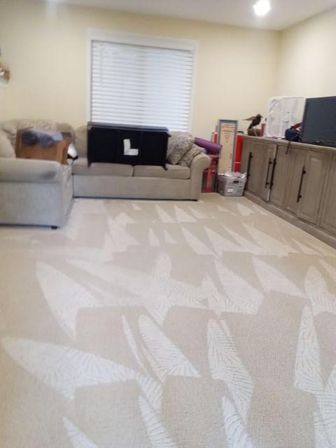

Vacuum
Prespray with Worx Sprayer and Carpet Details
Scrub with Brush Master Pro 35 14'' CRB
Extract with Trinity Odyssey
Groom

Vacuum
Prespray with Worx Sprayer and Silver Solution and Detonator (Peroxide)
Extract with Orbot Vibe TL and Cotton Bonnets
Groom with 10'' CRB
