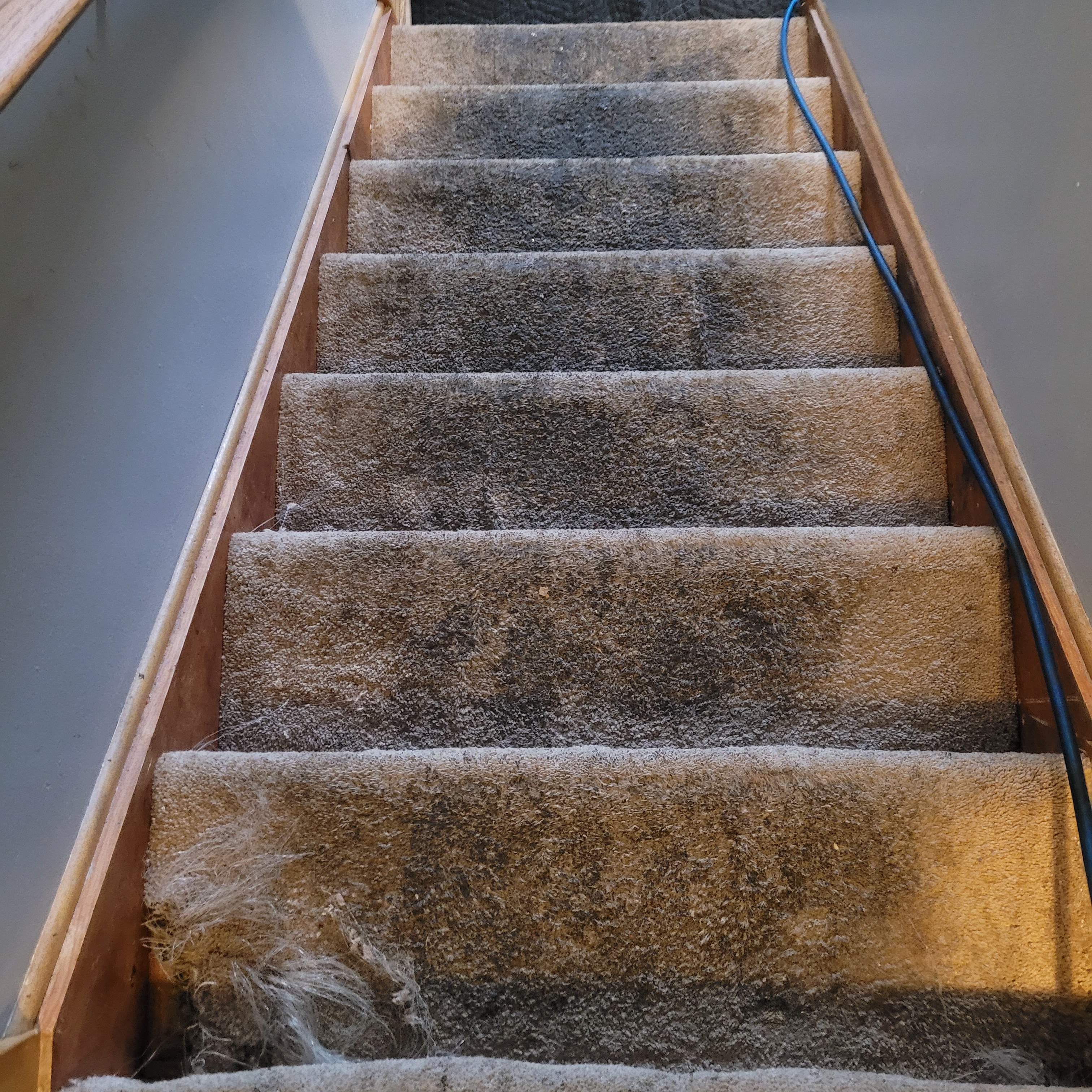

We're not proud of jobs like this, but #10 flow made it happen faster with less effort. I want to encourage you to stay away from jobs like this. If you're going to experiment, get yourself a 25-foot section of 3/8" pressure line and witness the power of rinse with less Psi.

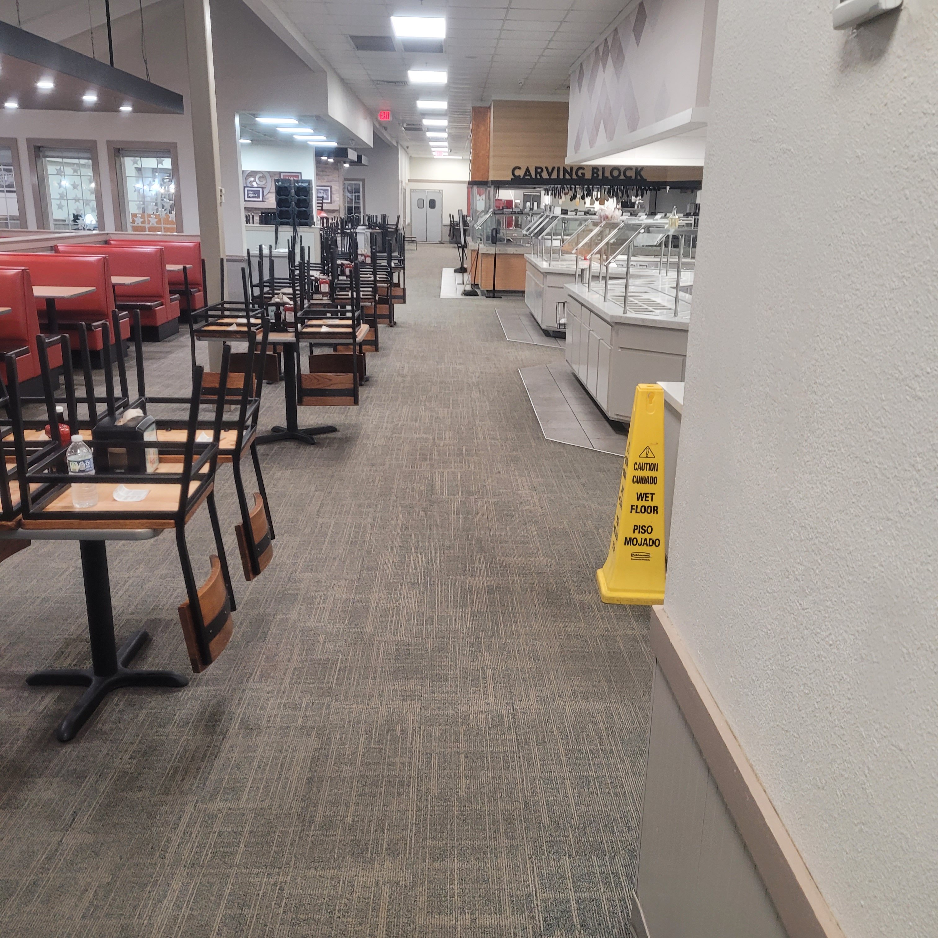

( at QD and the jets) . I'm more concerned about clogging the jets because of the debris flying from the carpet. That's when jets with 01 openings are vulnerable. Even though I have three wands on any job, I'm not playing mechanic while hitting 10 K sqft.
When you have trouble to see from one end of the restaurant to the other , than you realize that two jet wand or #6 flow isn't sufficient.

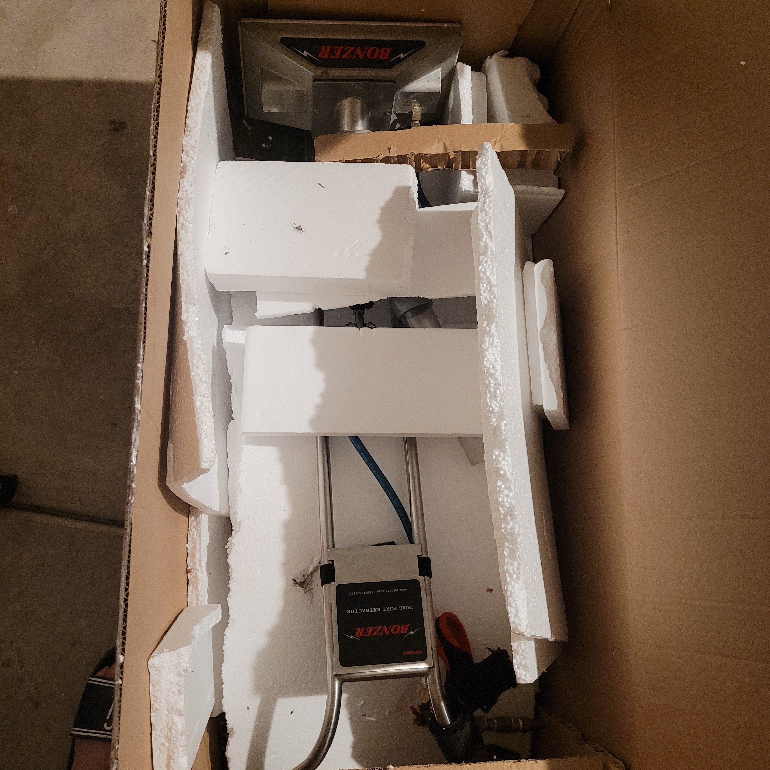

Here's a packed up Bonzer ready to ship to Canada or worldwide .

Is this available?

Thanks for response. Is this swivel, or not?
Cheers
No, it's not swivel. It's the one with seven jets( you can close two opposing jets)everything else is similar; 2" tube, front and rear glide. I just want to point out that specs state 17 lbs., my wand weighs 27 lb.
I assume ( by greeting)that you're located in Australia. I shipped to Australia; it's doable, but not as simple.
