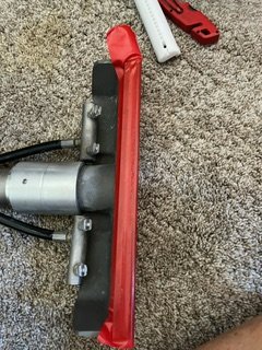

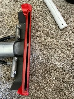

2-2”, Devistator 2.5” to 2”
Devistator wand and green hole glide
2-8 hrs usually but could be up to 24 depending on environmental conditions, soil and carpet type
2-4 dry/wet
400PSI
Inline sprayer
Usually fresh water sometimes acid rinse
All that said I am not taking more strokes just much slower.
Jobs are taking noticeably longer.
When I change to vinyl my same set up will go from 12” to over 15” of lift.
Check you kid gasket should be 15 atm sealed 12 on the carpet wand down.
There's a little loss.
Some carpets seal more then others when it comes to grabbing the carpet.
Smart srand creates lock down like no other
