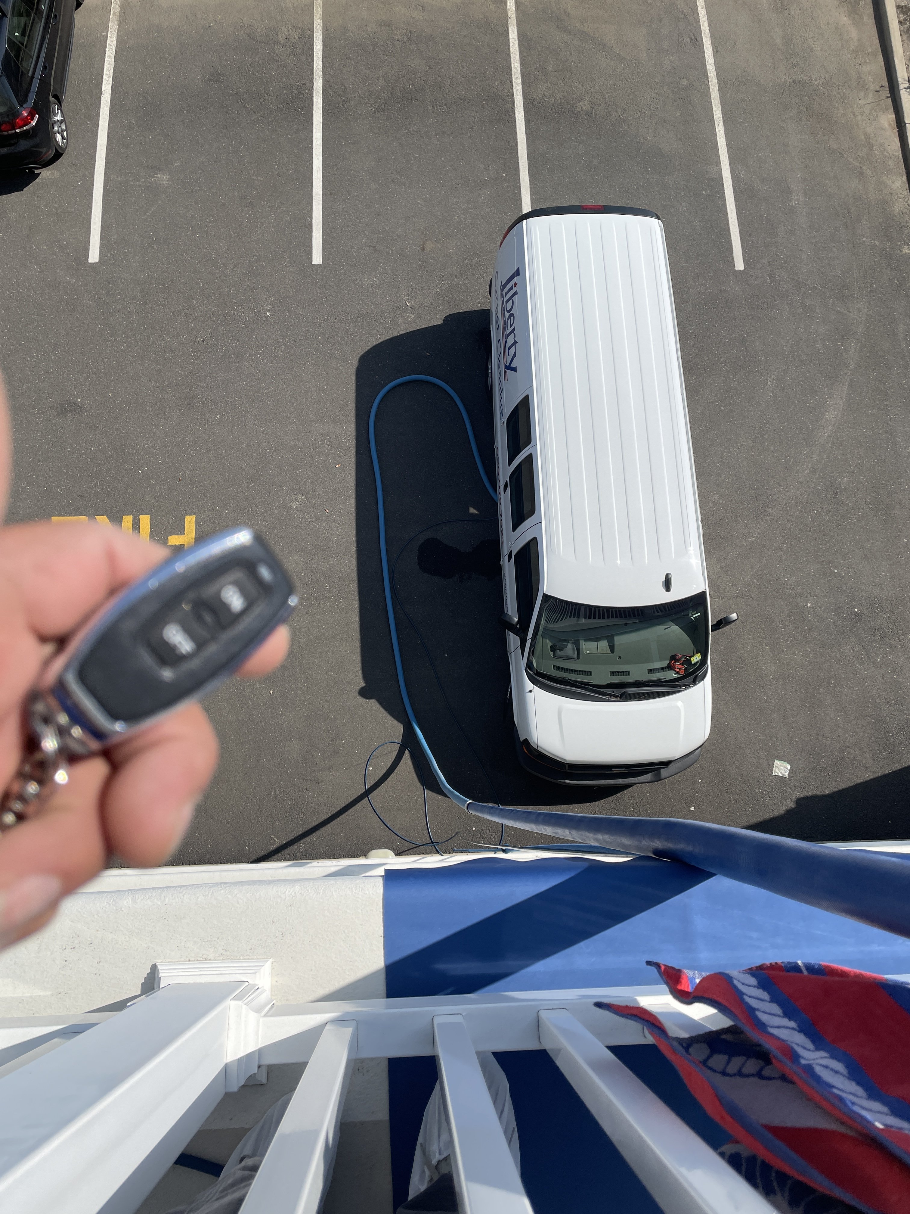

It is great working solo with the remote. I dont have all the options, just on/off. I have yet to see if starting and stopping with the machine in the working position will take its toll on the clutch. Good for now. As far as accidentally hitting the on button while driving, since emergencey brake is off, im thinking it would just kick in on idle speed.
The real shocker is if I leave it with power off, leave the remote at home, go to the job and cant turn it on. I forget wiring stuff real fast when I dont see it for a while, and would be sitting there like an idiot. Calling the office to hurry up and bring the remote.

Got my Thermalwave up and running from being winterized. That remote start/stop is noticeably missing on it. Got so used to it on my Hydramaster CDS 4.8. What a effecient option especially when solo.

MJ how's the remote switch working out for you? You've had some time under your belt with it.. @Mike J
I use it frequently and it works great. Still the same battery in original fob.
There is no way I could fill these orders without. It lets me finish rooms as I go and my machine time is getting way lower. So Im giving it a great review. I have a back up ready to go.
