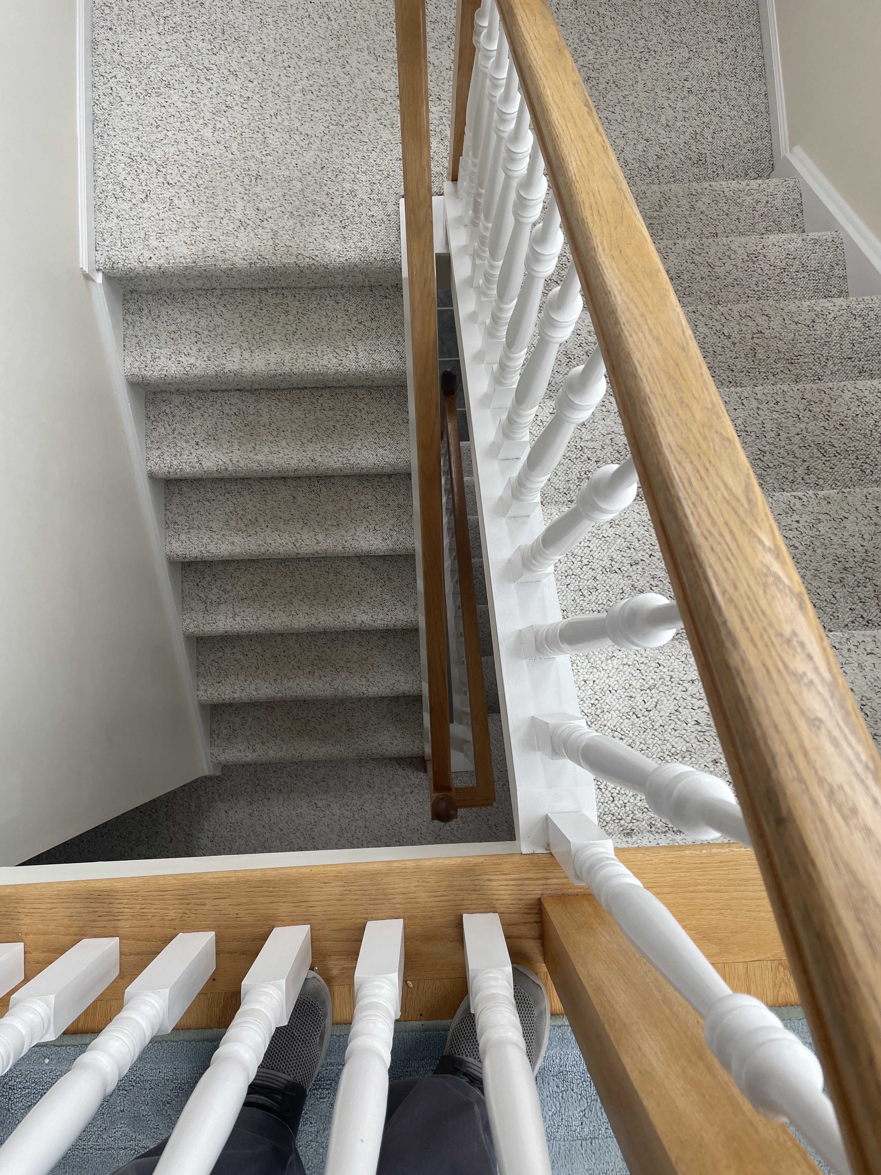

Heres my reason, stairs. I am in an area where flood insurance made about 90% of houses up on pilings. Shifting from 3rd level to 2nd level to first level it would be used. I would also like to finish a room off and set up for the next room without machine on. And the visual inspection, I wouldn't mind that on the phone either with a cam. How many times I had asked a tech to go check the temp or pressure....or why did the machine shut down. Just saying for the price tag on these TM and the bragging of the superior features, this should be in play.

good news is this is the before pic. bad news is this is half of them. great news is im closer to having my on off remote in action. bad news, not in time for today.
