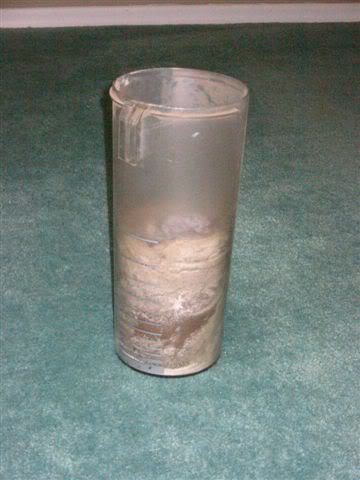

already prevac'd, one room and hall

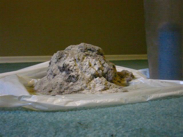

12sf of hallway, already prevacd

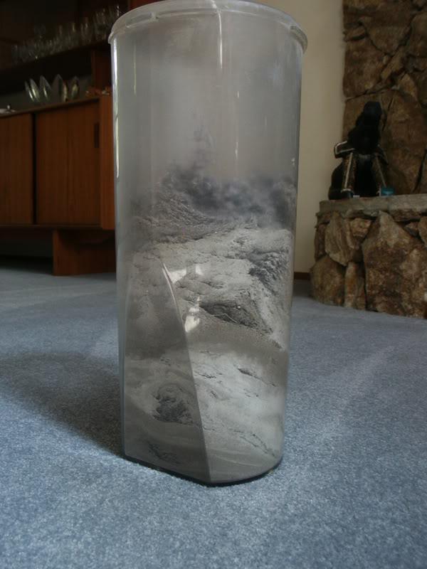

one of 2 cannisters from a average LR, homeowner vacuumed it as well. The white stuff is carpet deodourizer powder. You won't even know its there with a bad vac.
how many would you like me to post?

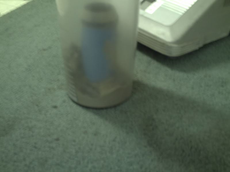

In a pinch I will use my Bissell like in the pic... I don't like to use my TM much to vacuum but once and a while I'll get caught with my filters all nasty... Nice thing about it is you can use the accessory hose to catch the edges. Bissell $49 and the turbocat is like $110 or more...
