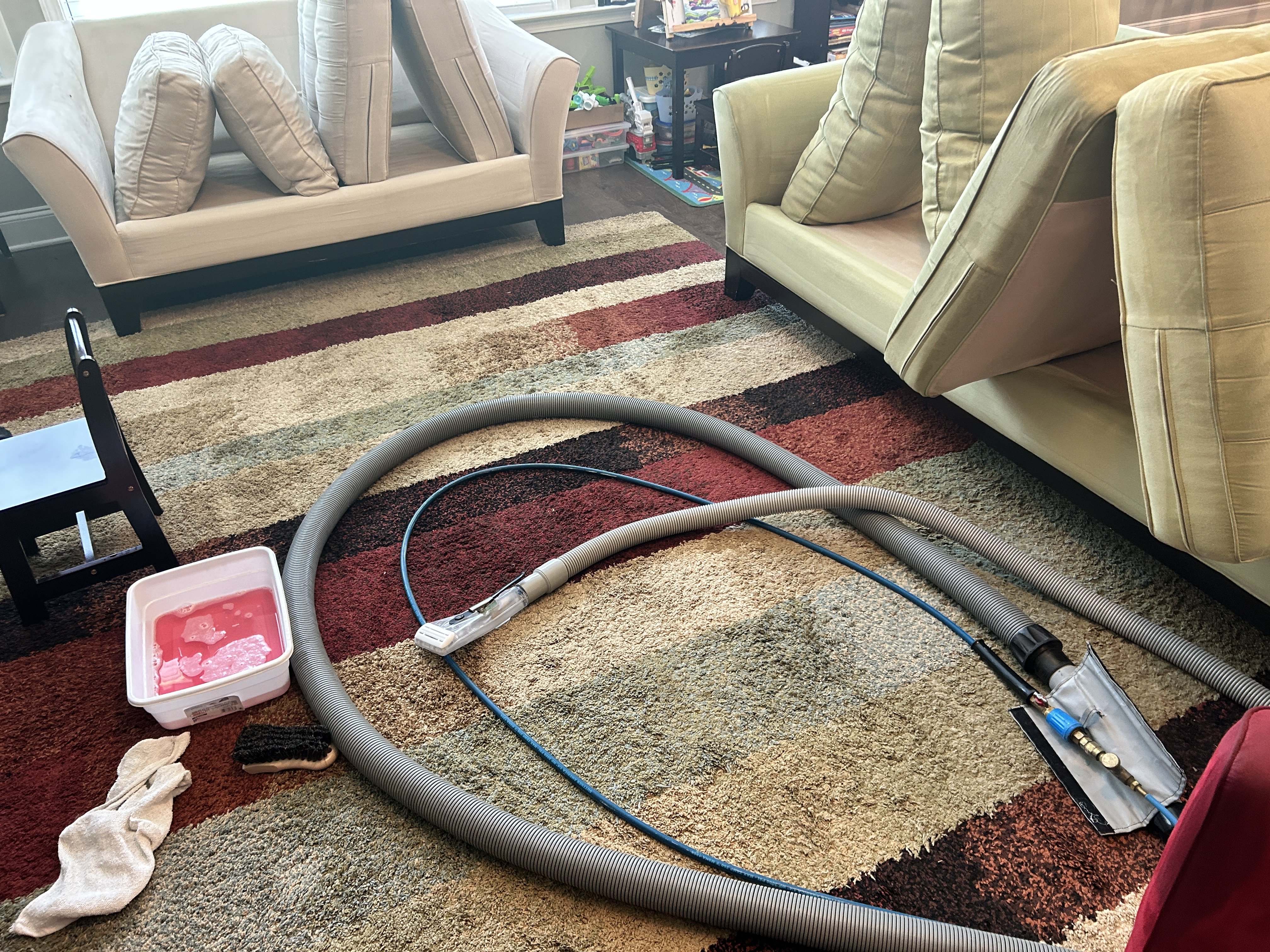

So today, I had to clean 12 white dining room chairs. Heavily soiled from dirt and food. I put on my latex gloves, grab a pack of microfiber towels, and scrubbed them all down with a peroxide-based cleaning solution, followed by another scrubby with AFR powder, then ended it with a dry towel scrub-a-dubba.
It has been my experience that this gives a better finished result vs HWE. Took me about 35–40 minutes to do all the chairs.

You can probably skip the Afr powder. Most peroxide encap products are acidic.

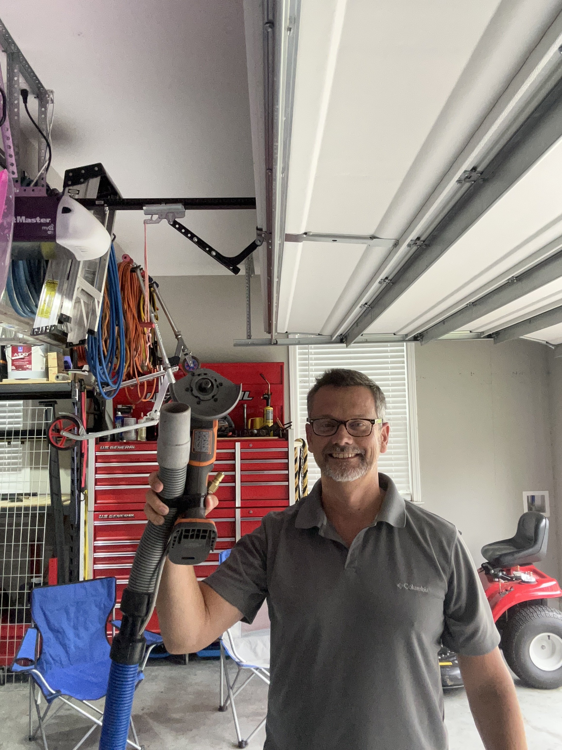

Time to clean some seats!!
