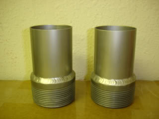

I'm assuming that those are 2.5" connectors.
Yes, pretty obvious when you put them side by side with 2", kinda tells a story.
To go along with your theory why don't you make them straight instead of a 90.
Like this?
If you look close on the TNT pictured, you will see that exact straight 2.5 nipple coming out of the blower, some TM mfgs. think they cost a bit much, but I wanted it super thin walled for maximum airflow.

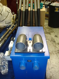

If you do, just make damn sure your blower filter is super clean, every 6 mo. or so unscrew it and run the machine without it, IF you notice a dramatic Increase in vacuum sans filter, you know your "clean" filter isn't really clean...junk it, and get a new one, they can be deceptive.
It doesn't both me if you find fault with my machine. Sometimes engineers over do things with out thinking about it. While I'm welding the filter box is getting a little make over. Besides the 2" connections do you see an addition problem?

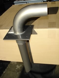

The bottom of your 3" Stack inside the box, look at how close it is to the bottom of the box, it's too close, cut a 45 deg angle in the pipe like the bottom of this custom piece:

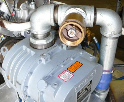

Ron Werner said:Plus, why have a big ass blower on there if out of the gate its going to be restricted down to a blower a size smaller
I have a Roots 59,4' ports, it was plumbed 3" to the tank , 2" from the tank to the back of the truck. And I was wondering why I couldn't get decent vacuum at 150ft when other guys were claiming 400ft with a 4.7! Opened the Blower up more, to 4". changed the 2" to 3", added ft of 3" hose, made a world of difference.
