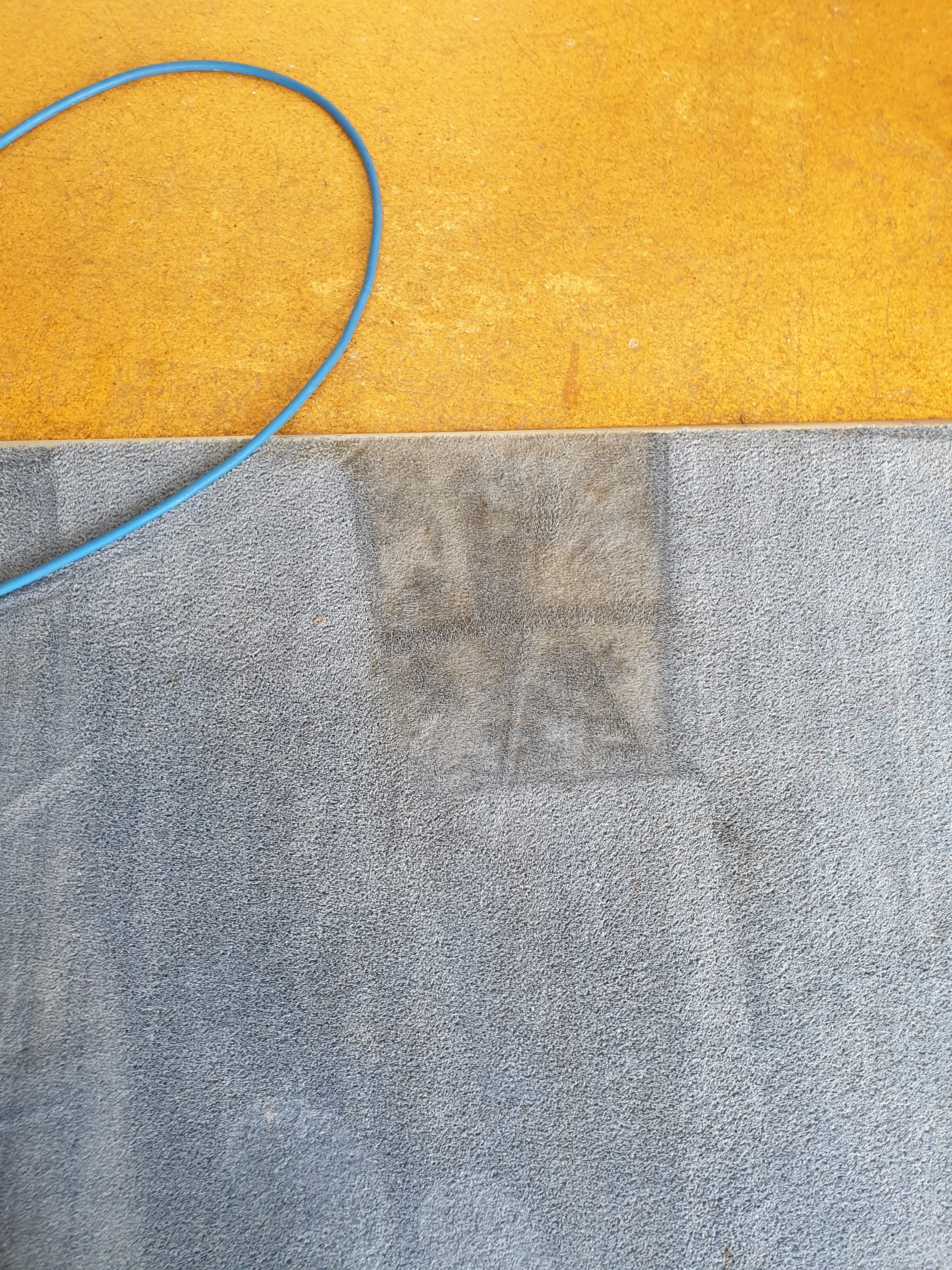

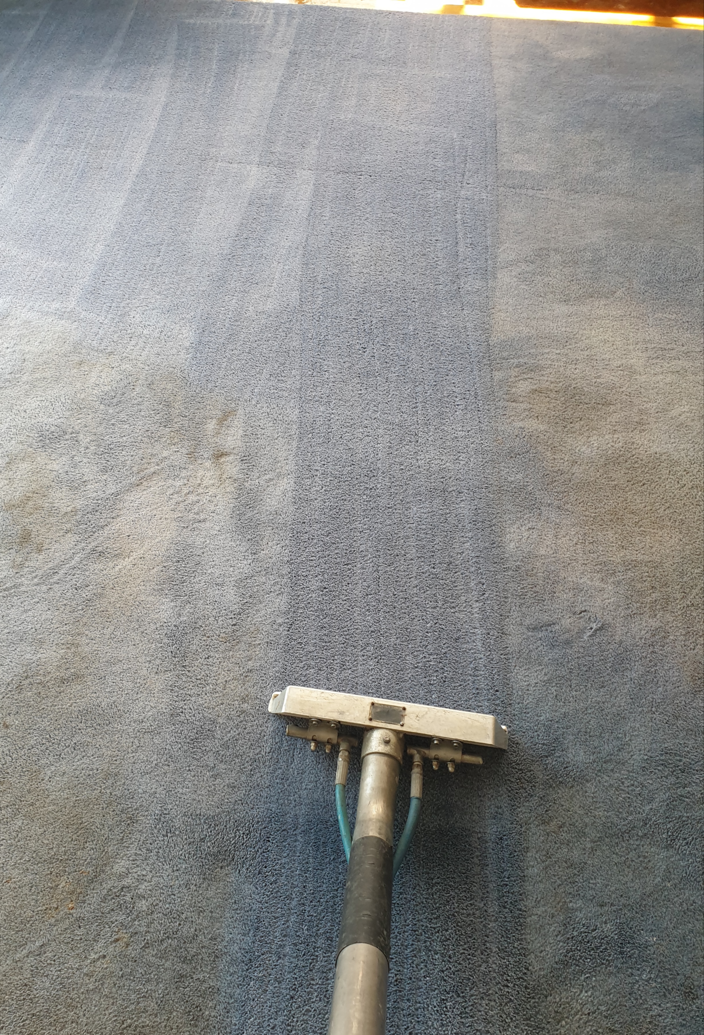

I've posted these pics somewhere else here.
Its wool and its older than the 17yr old incontinent poodle that lives on it.
Masterblend soil lifter with an extra scoop in HF reasonably heavy prespray with a genuine 15mins soak while I browsed MB.
Long trigger strokes to get more heat out and onto the carpet..
and no agitation.. your dry strokes (if you have a window) will let you know if more rinsing is required
