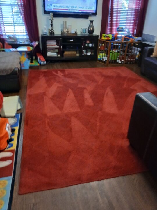

14,630
That just tells me (when you had a machine that looked like a good truckmount) that you didn’t HWE carpet properly
I bet you
-did your wet passes in the triangle pattern
-had a 2 jet wand that was 2-3 flow
-rinsed at maybe 350psi
-didn’t do slow dry passes.
-never changed your blower belts because it was ā€œtoo hardā€ to get access
-had your lift set around 11-12
Which made your mind calculate that HWE was terrible method. I understand. That’s why there’s mental facilities for those who were just taught the wrong way. It’s called a class and they teach you the proper way to HWE carpet.

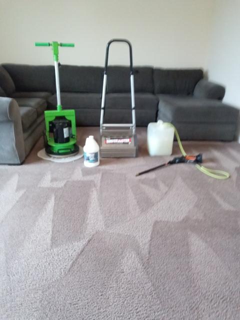

Don't use a Buffer
Most of the work is done by a $3000 dollar 14'' CRB and it's worth every penny
Then a OP Machine - TOPS Odyssey or Tankless Vibe
