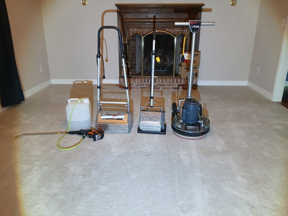

Nasty day outside
35 degrees Heavy Rain Wind Damp Cold and Miserable
But my Van Doors are closed and customers House Door is closed. No heat getting out or cold getting in
Working in Bad Weather is much easier and better using the VLM Method
And carpet will be dry in 1-2 Hours
One of the girls that works at my Apt Complex is moving into a new home and she asked her favorite carpet cleaner ME, to freshen up the carpet before she moves in
Nice Big House with Nylon carpet
I used Carpet Details at 4 oz and Detonator ( Peroxide ) at 4 oz
WORX Sprayer with 8003 Teejet
Light Blue Microfiber Bonnets and Tankless Vibe with 3 weights on each side
Soft White Brushes on CRB's to scrub and Groom
Life is BETTER using the VLM Method !!!
Did you post vac? So the job isnt done.
Did you pre vac because i dont see one?

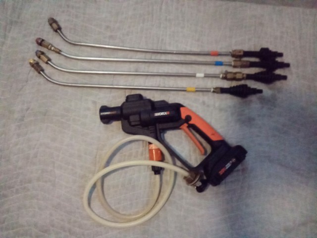

I don’t use an in-line sprayer much these days, though I will in certain situations. I’m pretty careful and controlled with how I apply pre-spray, but to answer your question honestly, yes, I’m sure that at times the backing and even a bit of the pad get wet.
Living the Dream with TOTAL Honesty
Thank You !!!
Have you ever tried the WORX Sprayer ???
If I was still HWE I would be using the WORX
They are reasonable priced and last a long time
You need 2-3 batteries just in case but one battery usually lasts all day, and you need to charge at the end of the day, but still worth it
Adding a Multi Sprayer Wand to WORX and teejet makes it the BEST Sprayer for VLM or HWE. My opinion
I have different wands with different Teejets for every situation I run into
I mostly use 8002 or 8003 but have 8004 8006 for big rooms so I can move faster or for trashed carpet when I need to put more solution down

Wow! nice set up!! I do have one that came out of the box, I only use it on empty units.

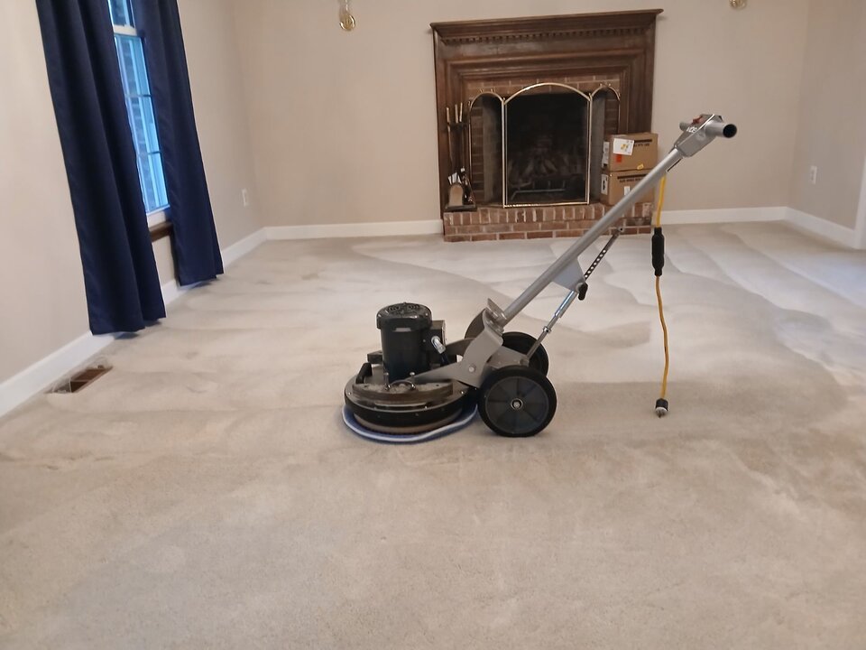

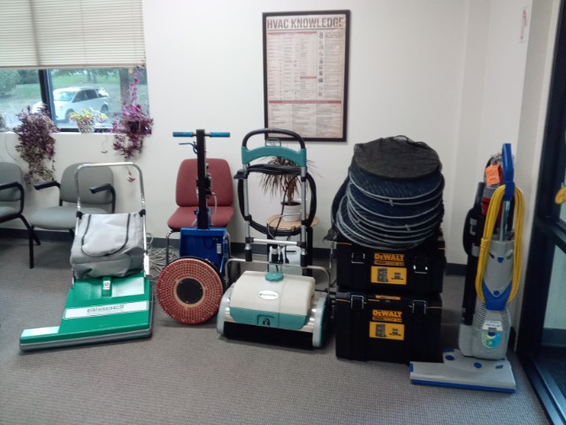

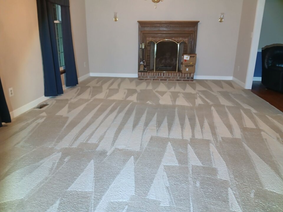

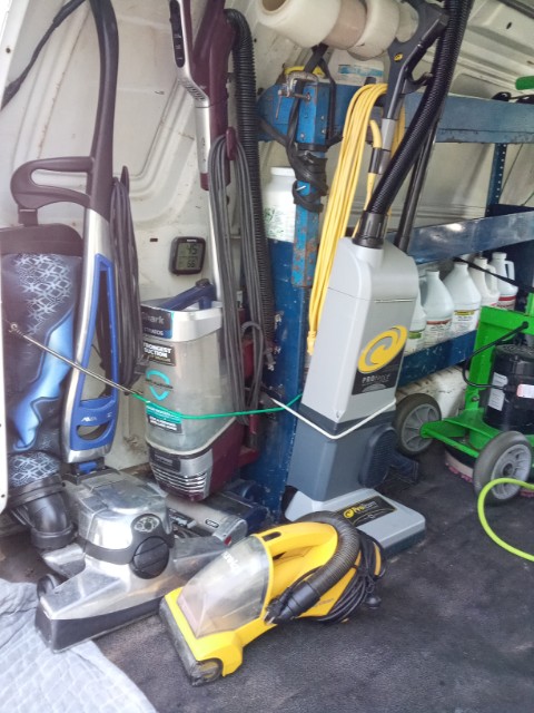

I probably have MORE money invested in vacuums than anybody here
How many guys here have a 28'' vacuum for big Commercial Jobs
Do you a 28 '' Vacuum ???
And I have more vacuums in my basement not in the pictures
Do you have a vacuum
How Many
Do you pre vacuum
Let's see your vacuum

Hey ,I forgot what's the PSI?
