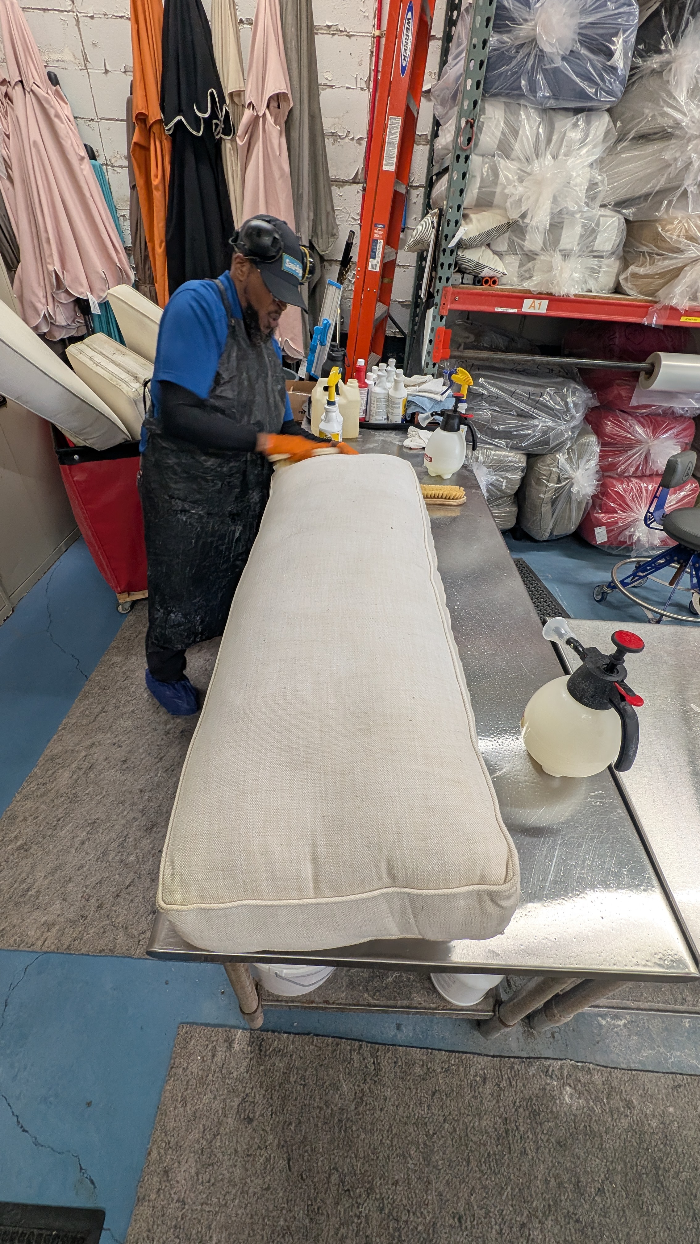

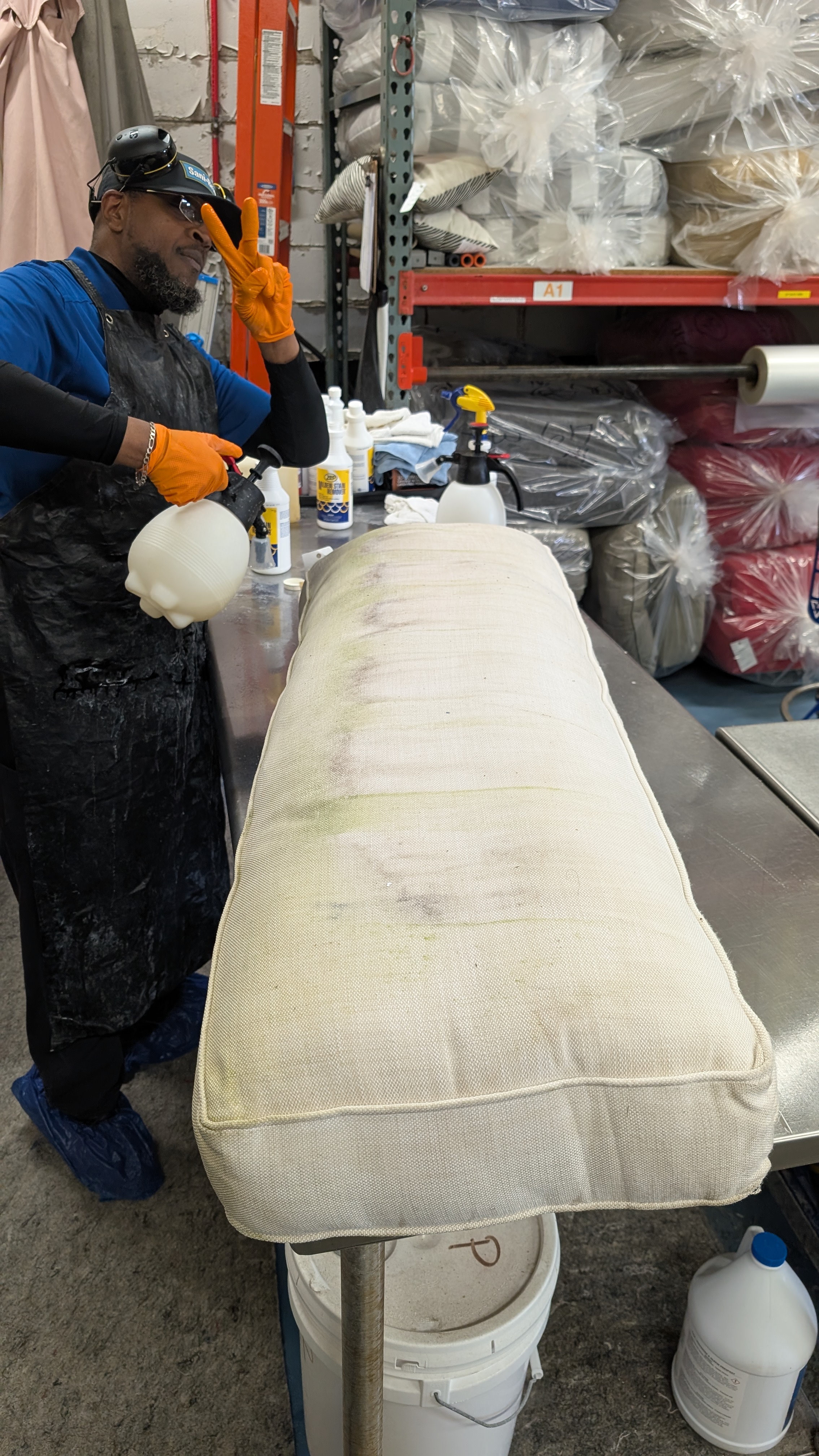

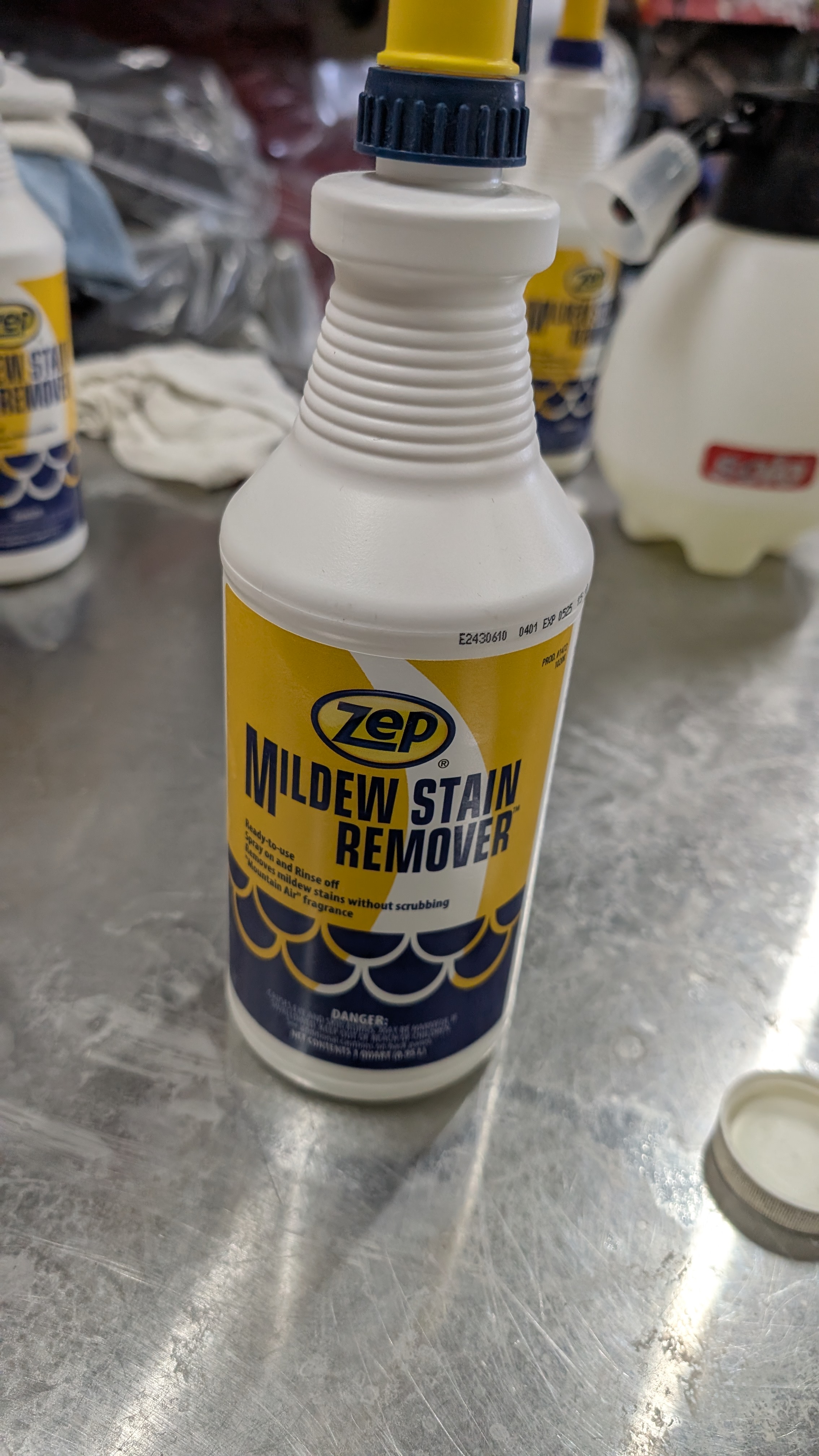

Zep mildew stain remover. Miracle in a can
115,924
Pre vacuum
Pre rinse
Apply enzyme cleaner
Rinse
Apply Zep
scrub
Dwell
Rinse
Repeat Zep if needed
Rinse
Dry
PXL_20250122_201213361.jpgPXL_20250122_201204045.jpgPXL_20250122_201646809.jpgPXL_20250122_201822807.jpg

And is that Zep a chlorine or peroxide based mildew chemical?
