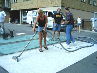

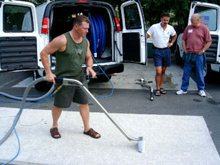

speaking of which I was cleaning off the greenglides.com folder and kept these two pics in case you want them for the history page
