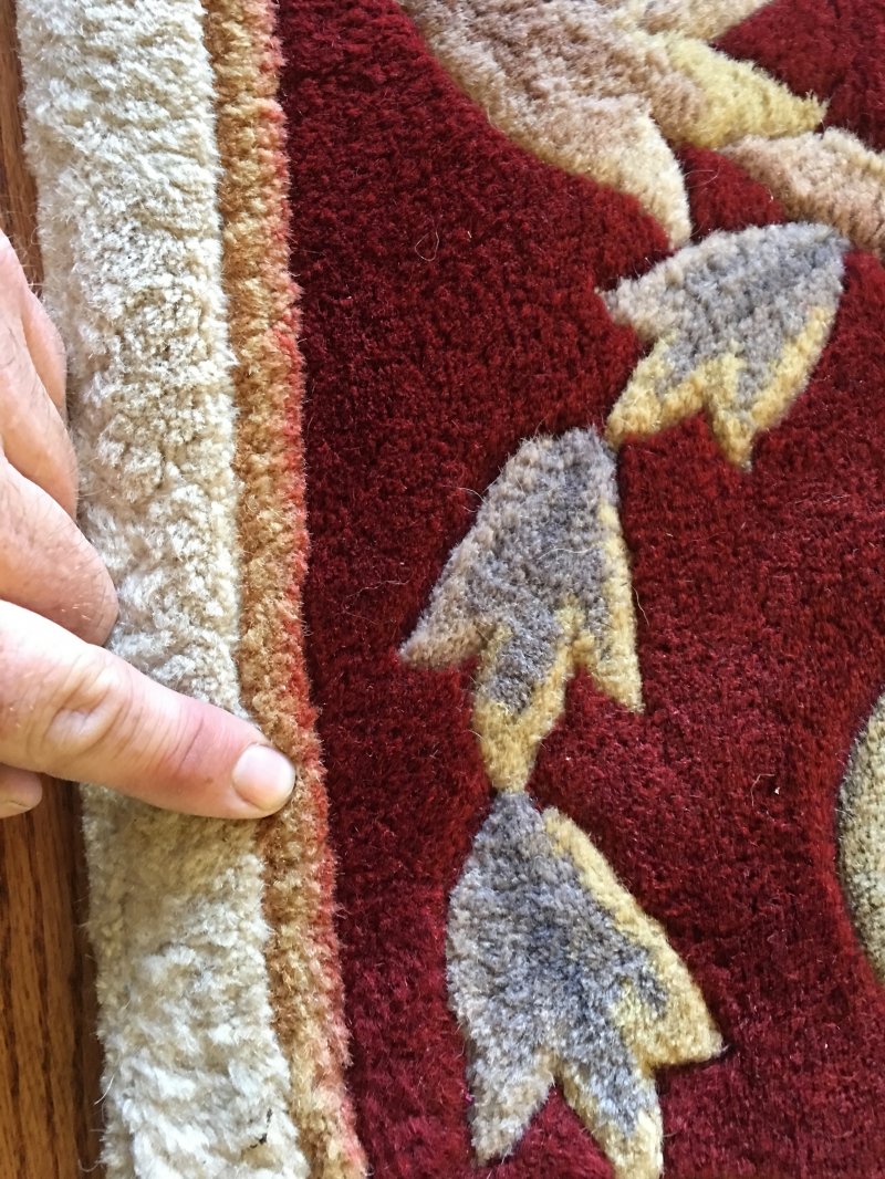

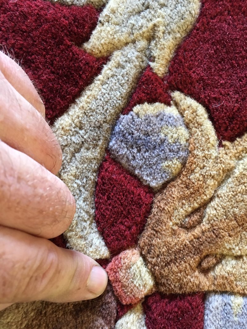

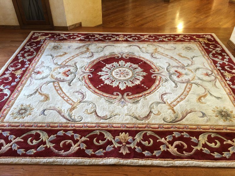

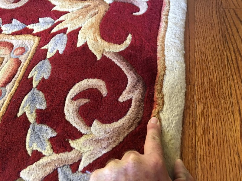

Yup, you gotta be careful with Wool carpets. I had a lady yesterday that wanted me to clean her wool rug. I normally bring them back to my "shop" and work on them in a controlled environment. She was trying to get me to clean them on the spot, in her house, on her wood floors. She said the last cleaner was able to do it on the spot. I got down on my knees and pointed out to her where the rug had bled. She was shocked and had never noticed the bleed before. I took pictures to cover myself.
27,863
You never know, she may have noticed if you had cleaned on site and would have blamed you for that. I now take pictures of any damage on rugs before I clean them.
