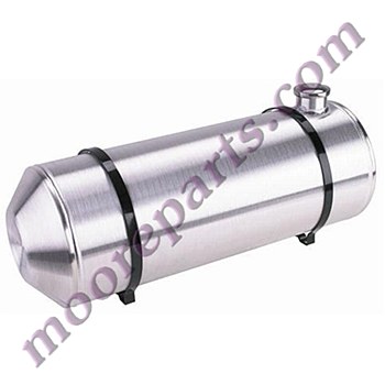

Mounting the tanks on the tongue is the way we do it here. We use Spun Aluminum tanks. A little welding and they mount up easy.

Marine Tank? These are what we use

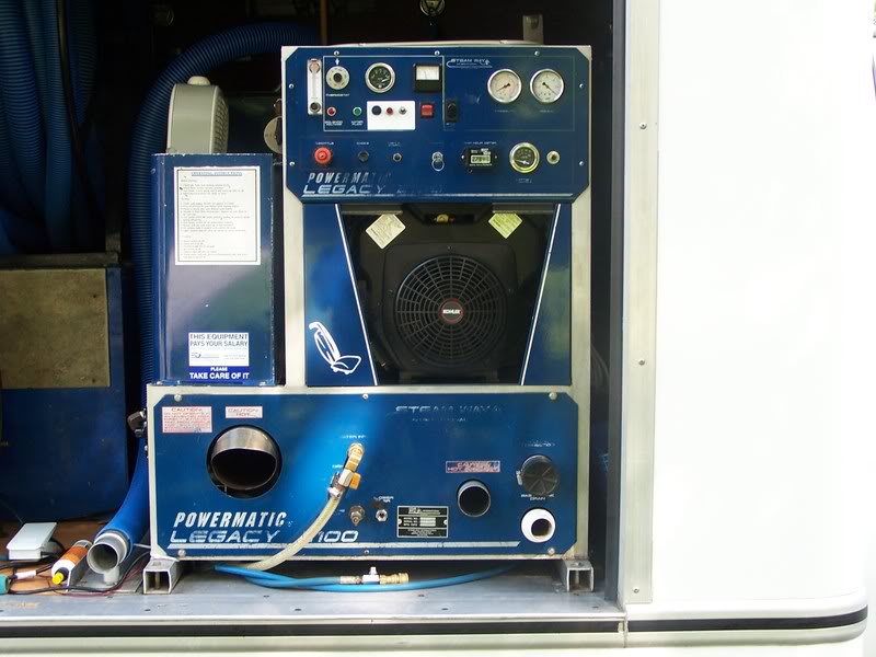

116,042
They want 6 grand for it :shock:
Half of which they are willing to barter hallway cleanings for. :shock: :shock:
Overkill for a back up that may get used 4 times a year but when I'm ready to get another van on the road it will be ready.
Dude, a new PM for $6000?
just buy the thing.
you'd be crazy not to.
figure out what to put it in later.
going by memory, the unit weighs 930 pounds empty.
foot print is 35" x 60"
you won't need a big trailer.
You will need one that can carry some weight.
I'd suggest a minimum of 3000 pound payload capacity.
Your pick-up will handle that.
boat tanks will be fine inside the trailer.
Just tell Whathisname not to stub out his roaches on the tank.
trailers are a PITA.
a van would be best.
However, you'll actually have to use the TM enough to pay for the added ins of another van.
If you were smart, you'd send Whatshisname out in it on jobs he can do himself.
