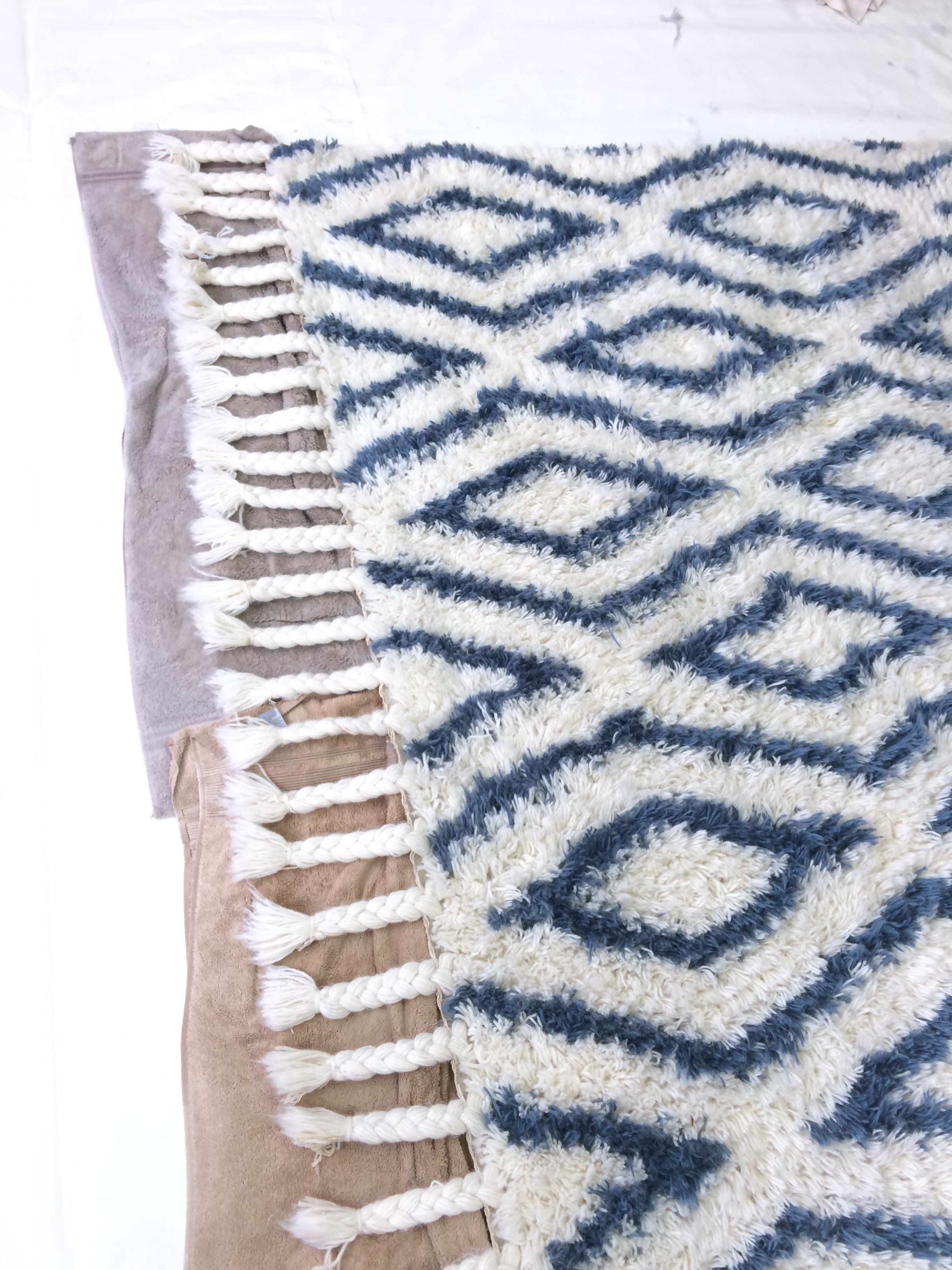

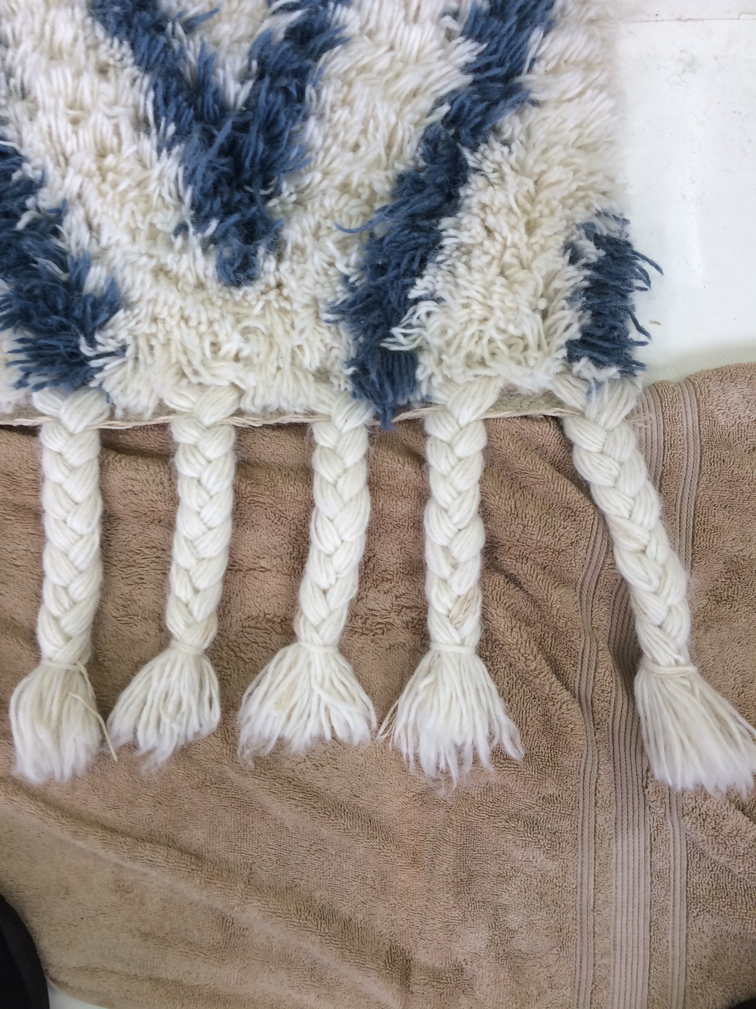

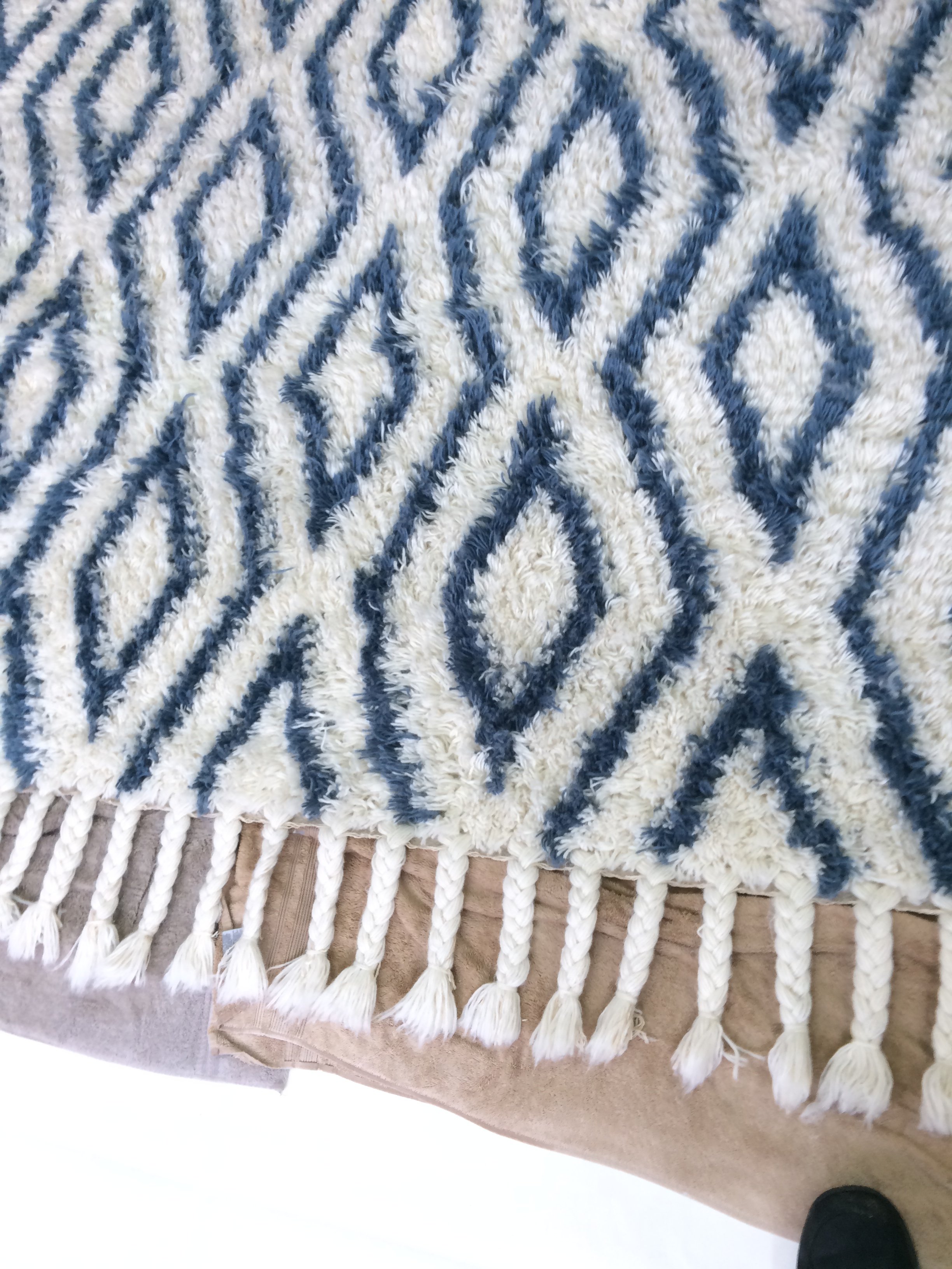

I was at the shop today prepping for my big overnight job tonight . I decided to process a couple of rugs as well. This rug was a bit of a pain in the butt. The braids are 10” long, and had to be cleaned(carefully) by hand.
Why do people buy crap like this? It was 100% wool, and very dirty, both on the top, and back.....

Just delivered one like that. We charge a little extra to clean the fringes. People buy it because they've seen it on tv show. Designers just love the texture, of course they have no clue on how to clean or even vacuum it
