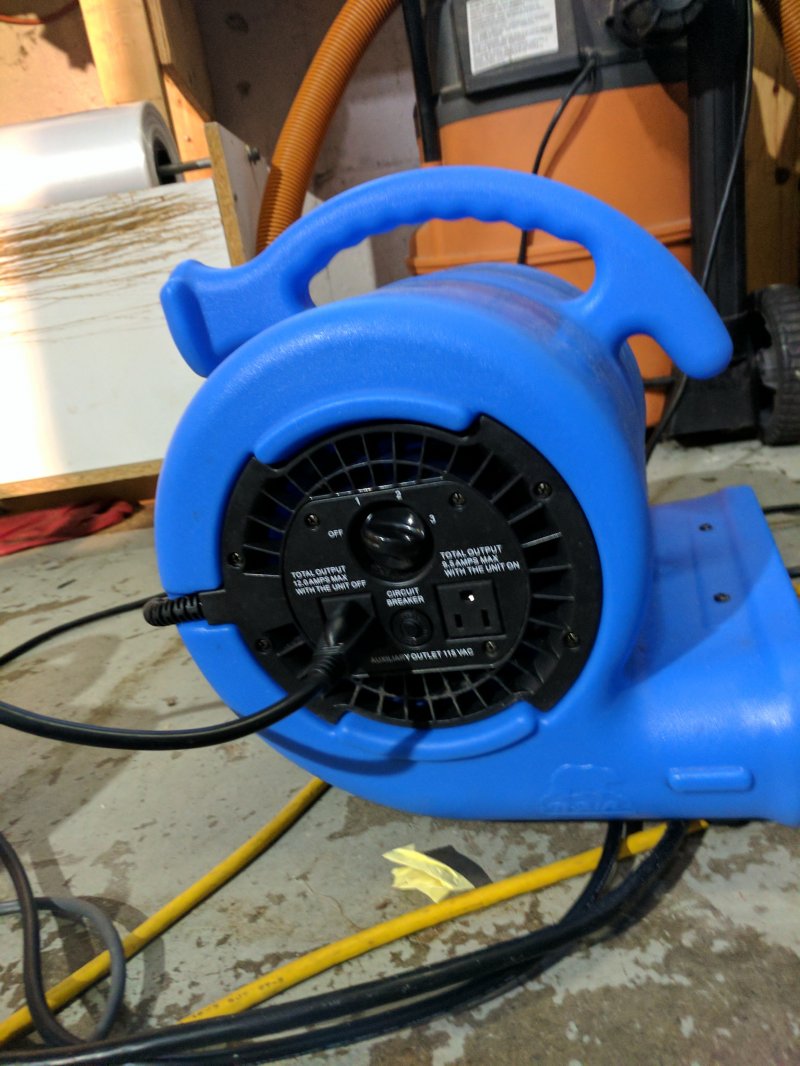

I have this little one that I got at the Vegas show. Half the size of a traditional dryer but very powerful for its size. 3 speeds and 2 additional outlets for daisy chaining. I am going to pick up 2 or 3 more. Won't blow the pictures off the wall. I think it's made by omni. They advertise here. Stackable on its side.

My little minis sure work well.
Thinking I need to jump in on the group buy for a couple more....
We have used them everyday since we got them. Really been impressed with setting them in a door way of a room after cleaning and doing some speed drying.
Very impressed, and again the smaller equipment getting used because easier to handle and take off the trucks....and these have great impact...so win - win

I have three AP's,one Velo, and three Omnis. Just for drying the AP works the best but you know that. The Velo and Omni don't really move air on the carpet they blow over the carpet which I think does not make them as good at drying. Turn you AP's on before you groom or try couple of extra drying strokes get a Zipper open a window or just give up. I choose the last option and bought two more AP's. The others just didn't do the trick. I wish the others had a more "directional" air flow directed at and across the carpet. The Omni and Velo have the option of pointing ,only,up but thats not where the carpet is.
Maybe there is a market for a medium sized Studibaker?!?
