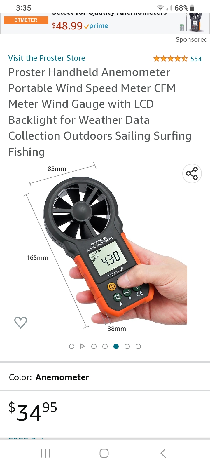

I gunna have to see this to belive it, my thought is not weather your hose is coiled or straight but how much hose is out , dictates how much air flow you have im gunna order a lie detector and test this out ill let you know what I discover. I know you have less vacuum with a live reel but you're pulling vacuum on a whole reel of hose not 1 or 2 lenghts my understanding is butlers and vortex has live reels or at least offer um 🤔 i don't think this lie detector for 35.00 will give a very accurate reading but should be ok for comparison we'll see
Just ordered the meter according to Amazon it'll arrive 4/8 (i didnt buy into Amazon prime)

I also wonder if you go up 100 ft, does that change flow? I am looking forward to the Anemometer results.
Coiled vs. Figure 8
Straight vs. Random pile after losing control and being all tightened up working solo.
UP over high balcony vs. Ground
And of course it would be cool to see the difference between 1,2 and 3 sections.
I dont know the science of vacuum, but Im thinking the wind speed may be consistent but the lift would change.

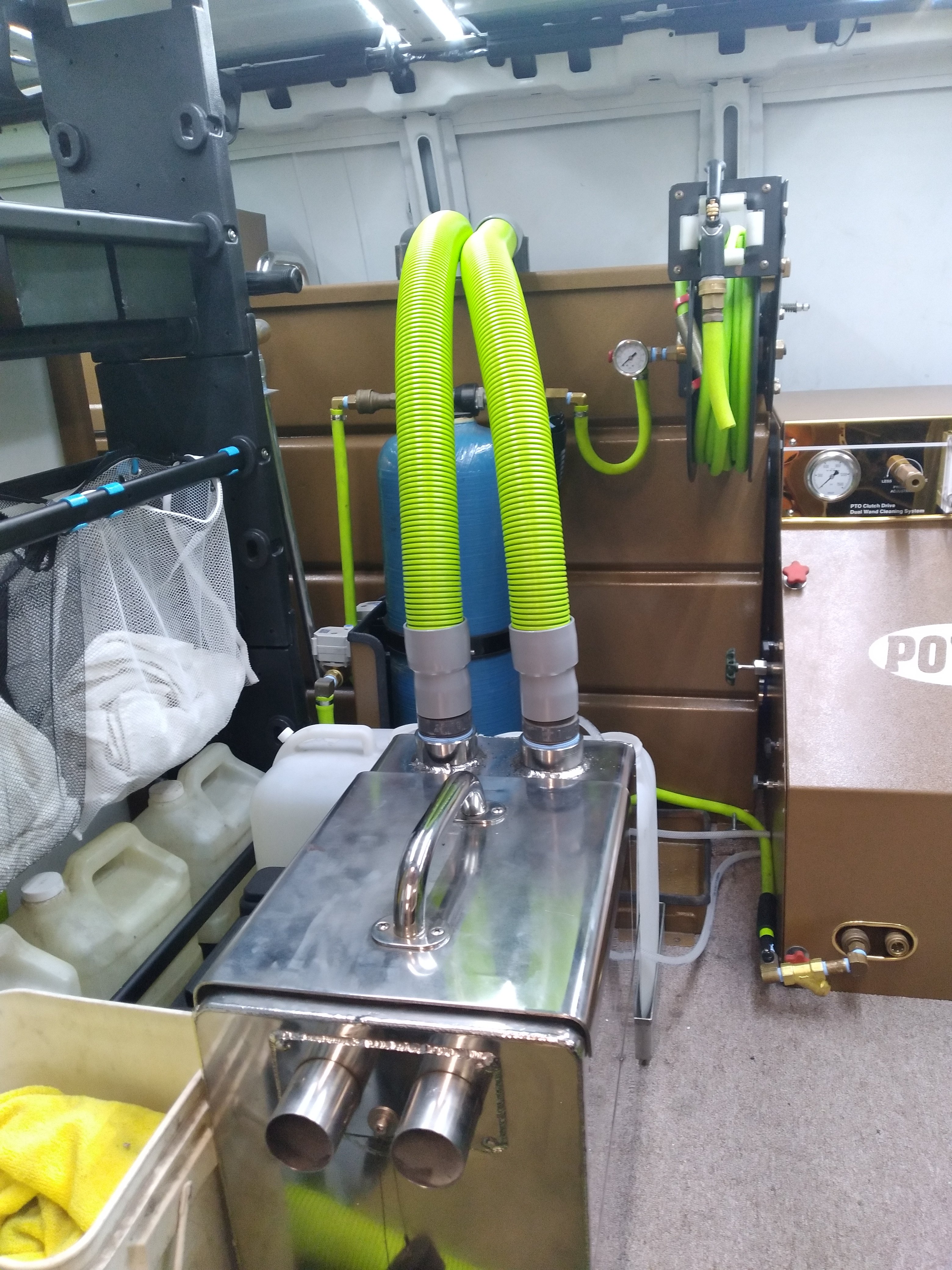

Between 2 meters, vacuum guage and anemometer i will measure simultaneously both lift and flow in various scenarios this may not the true tale of whats going on inside the hose but will show differences in how hoses lay and effect on lift/air speed/volume in a side by side comparison. This is the best i can do without a laboratory and knowledge to use it . My filter tank is setup with 2 inlets so ill hookup 2 -125' lengths of hose 1 straight and 1 in various states of coiling 1 side vacuum guage other anemometer
