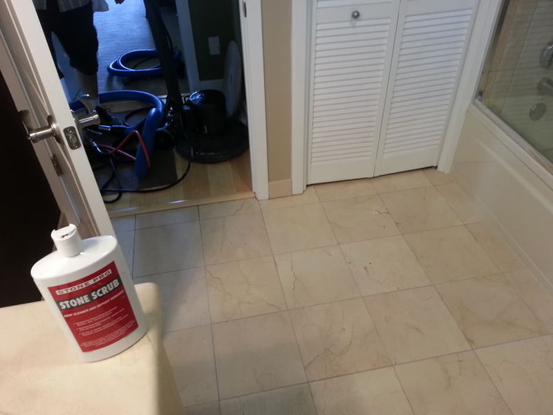

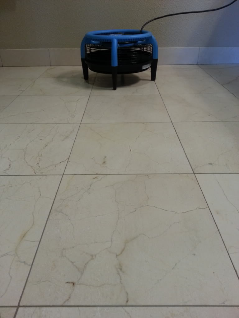

115,966
Finally got to this job...
With Magic Al's Glass and Metal Magic along with a Stone Pro Ultra Hog Hair pad and just by hand I was able to remove etching and soil off the honed marble slab counter.
On the floor we used Stone Scrub and a white pad/175 to deep clean the marble tiles that had a satin polish originally. Over the years they took on a false shine, much like Travertine does, fooling me to believe they were a high polish at one time. While some scratches remained there was a huge improvement in consistency cleanliness and appearance.
Along with a good dose of Cobbs it was a very easy 4fiddy.
