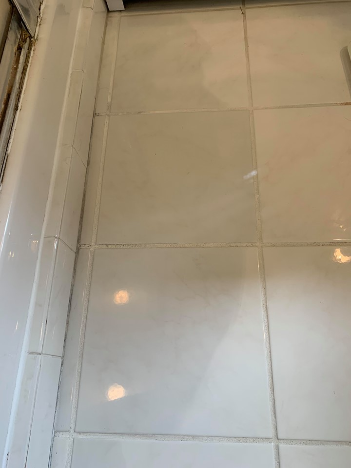

What the heck is going on here?
116,055
Not my project, sent to me from a cleaner...
Client has no clue
Looks to be water intrusion but I've never seen translucent porcelain...
Fat Mike
Aug 1, 2017
2,832
AZ
Mike G
Water intrusion I’ve seev it before. Shower failed or there’s leaking plumbing. Most don’t realize tiles not a 100% waterproof especially if the water gets underneath

Is it a camera artifact, or does the darker color go up onto the base/baseboard heater/whatever is on the wall? (Pic #2)
If that's water below the tile, I'd like to know the condition of the substructure.
Almost looks like it’s crept up the tile in this photo aswell...
