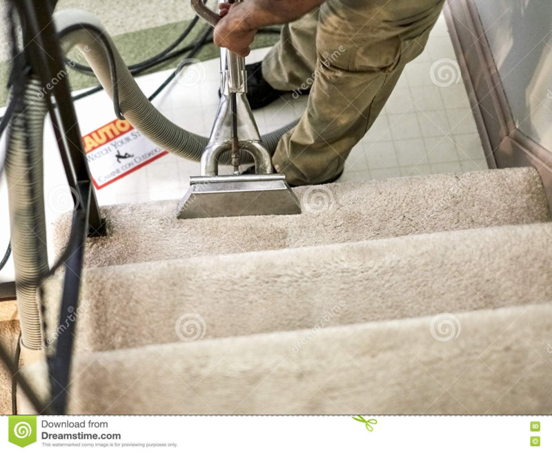

Nov 21, 2016 #2 Mikey P Administrator Joined Oct 6, 2006 Messages 115,991 Location The High Chapperal Stanley Steamer
Nov 21, 2016 #3 R roro Member Joined Oct 18, 2006 Messages 1,277 Location Wellington Name Ross Craig Does the twin neck give better airflow? roro
Nov 21, 2016 #4 Mikey P Administrator Joined Oct 6, 2006 Messages 115,991 Location The High Chapperal Doubtful, just confuses the flow Reactions: Shorty and BIG WOOD
Nov 21, 2016 #5 Cleanworks Moderator Joined Oct 22, 2012 Messages 27,866 Location New Westminster,BC Name Ron Marriott But it looks cool. Can you imagine if it swiveled?
