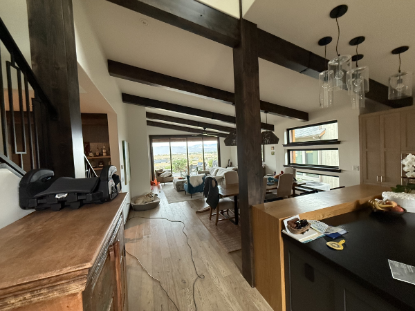

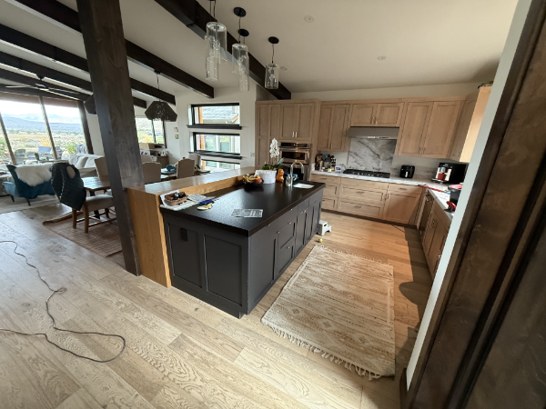

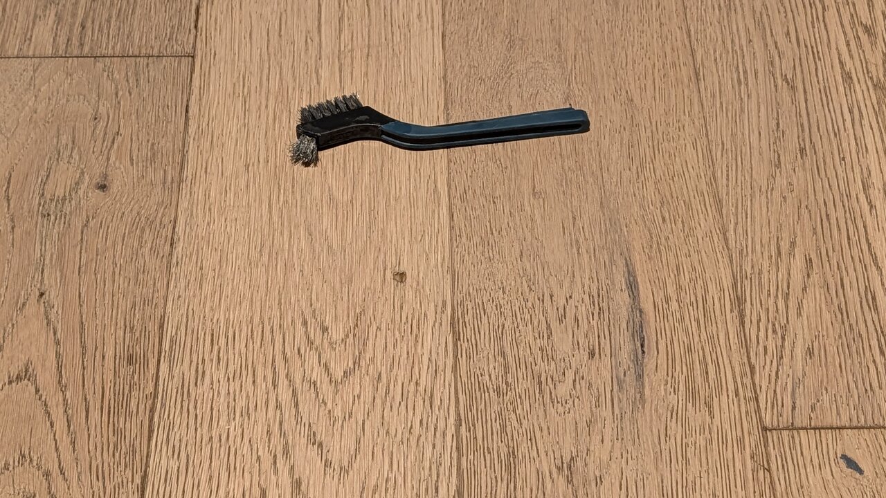

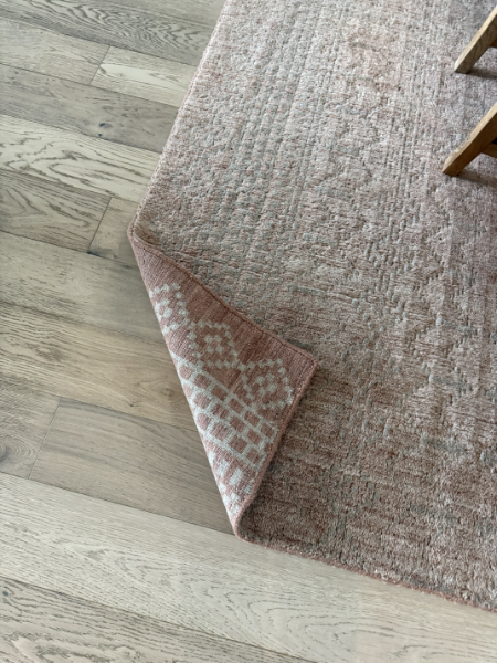

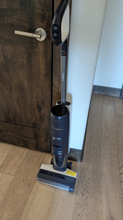

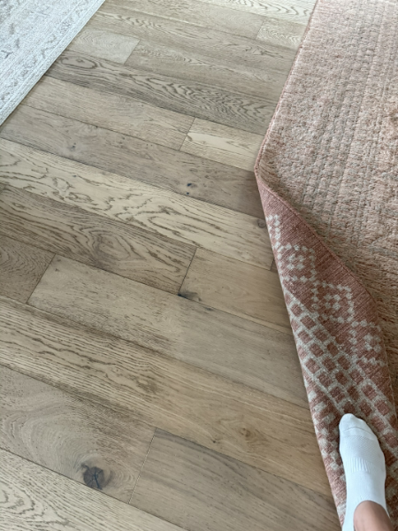

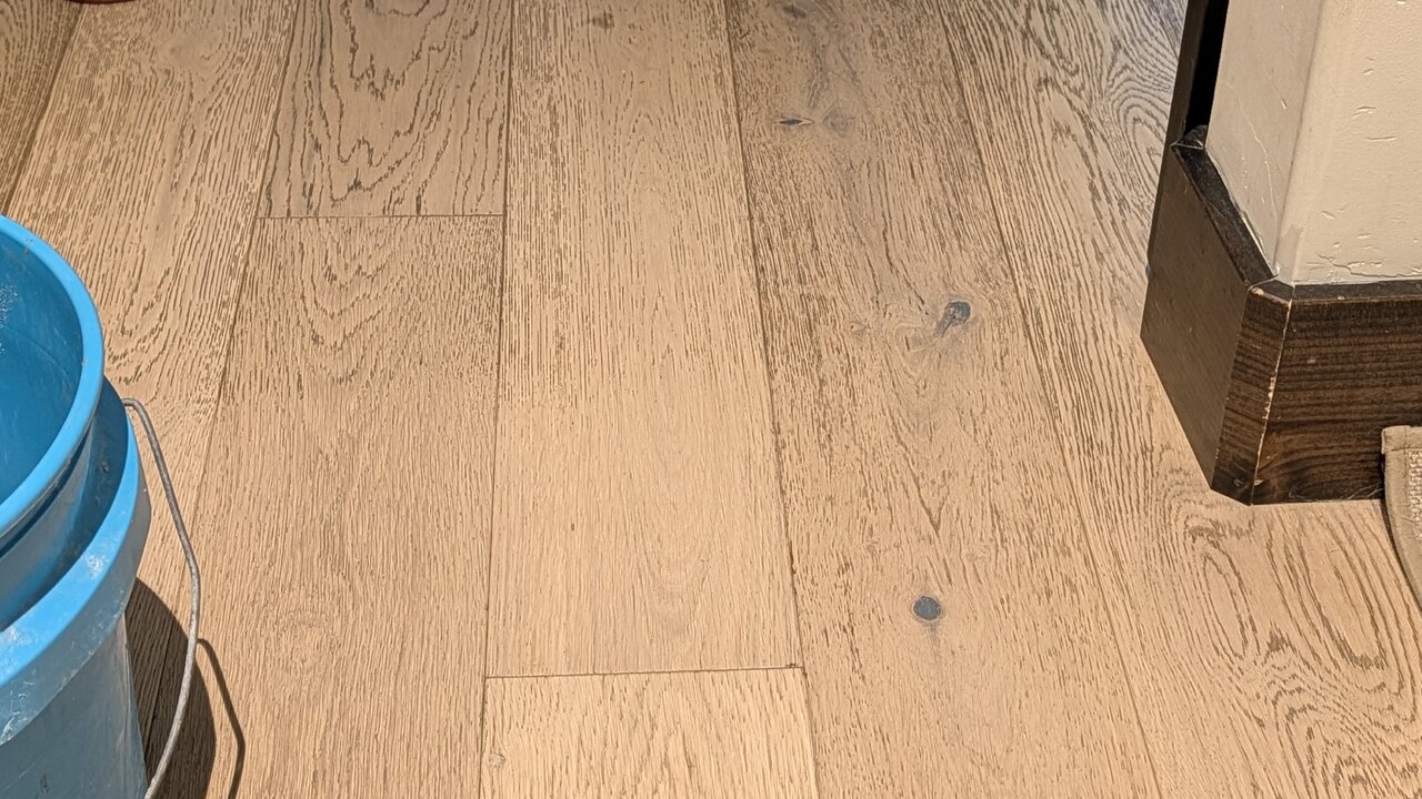

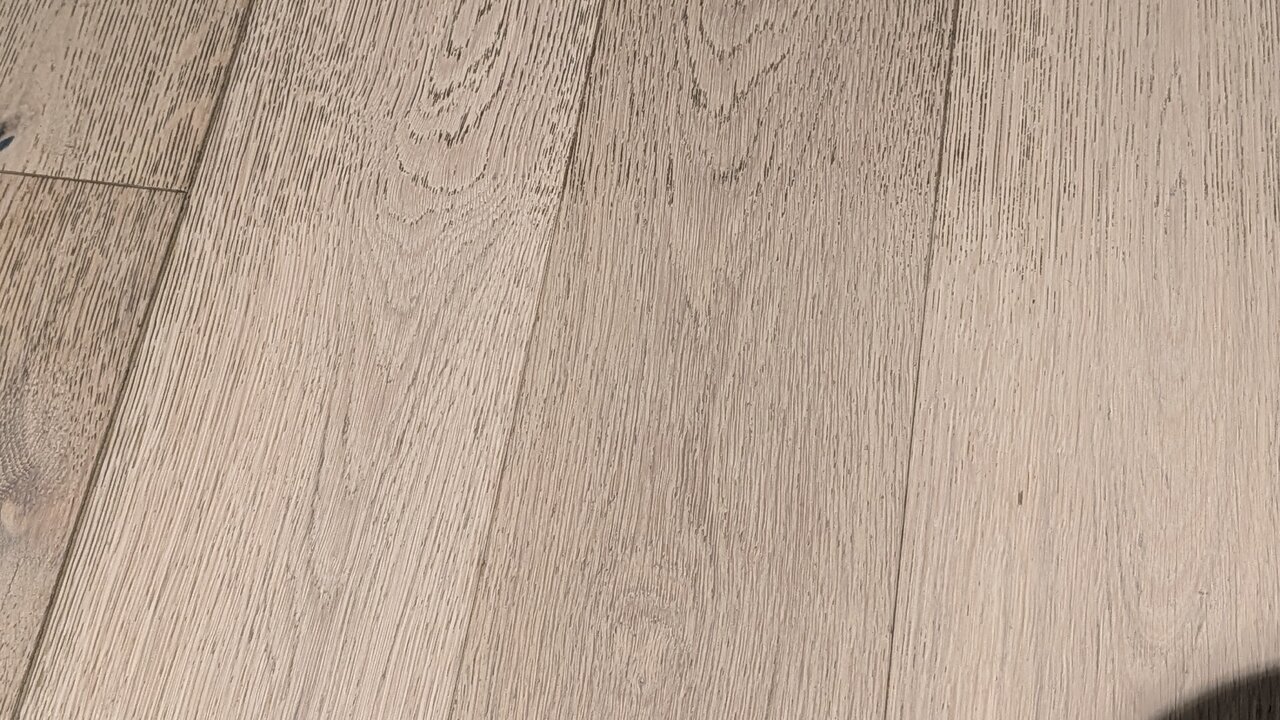

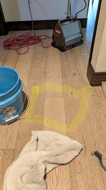

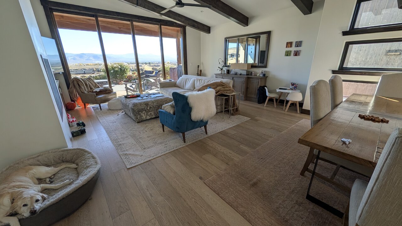

New customer want her 2 yp wood floor cleaned. I asked for photos first and they give me the impression that the engineered wood is a penetrative type oil rubbed type vs a coating
What do you see?
Hi M*********
The last photo shows a concerning amount of soil on the wood, the photo give me the impression that the planks are not coated with a polyurethane or similar top finish, but rather a oiled hand rubbed penetrative sealer, which unfortunately often leads to soil absorption from dirty mop water.
It would be best if I came out to test a few small areas to see if we get the results your are looking for.
I have a $200 minimum for this, which would be deducted from the final bill if you proceed with the work.
Cost wise for the wood and area rug, we're looking at $1000 -$1200 If that all sounds do-able, I can come by this coming Tuesday around 9:30 AM to test the floor.
Thanks for the photos!
